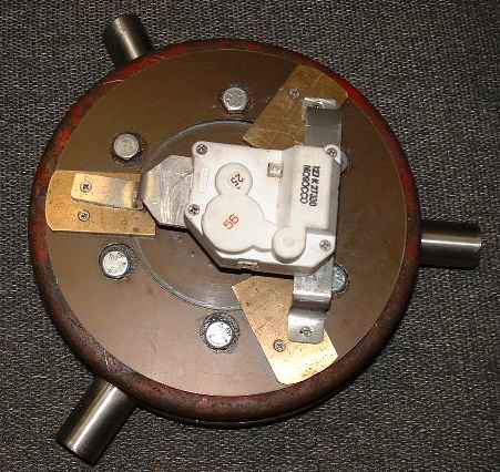

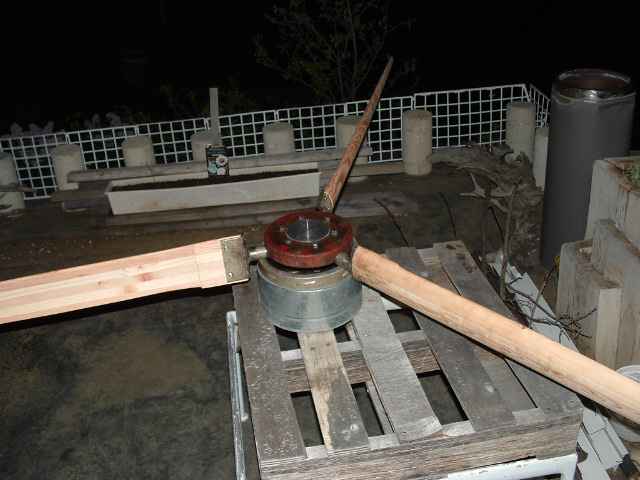

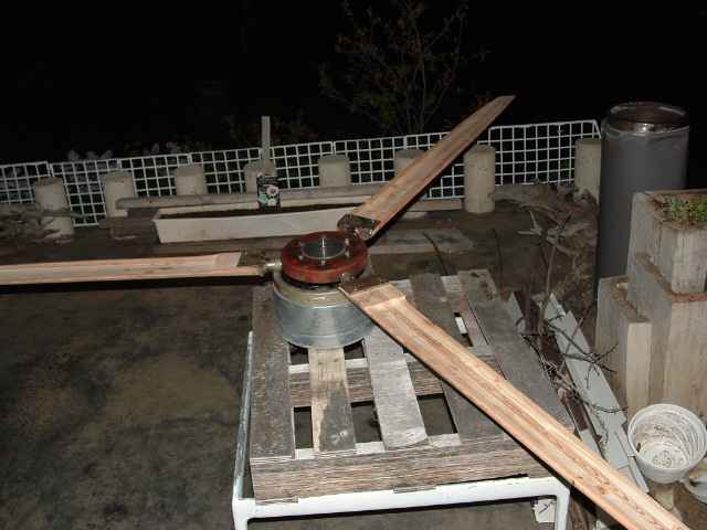

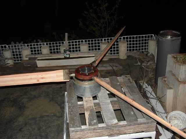

Here are three pictures of my servo adjustable hub. The blades are attached and they can now rotate 360 degrees. I am now working on a cover and seals for the pivots. It was a lot harder than I first anticipated. The servo is a 24 volt unit and slip rings will be needed to connect the control to it. This is another item that I overlooked.
The hard part was getting the blades pivots square. I used shims to align each blade so that they all rotate properly. I will have to make adjustment plates for each blade. My diameter ended up at just over eight feet.
I have started working on the genny, a skewed motor conversion (Thanks Zubbly for your input) and will soon post the progress on that end.
I took the pics at night. I will try to put it up on the test tower next couple of days and maybe the wind will blow so I can get some data. If not it's on the truck. Joe.

Lookin' good!  Nice to see a theory being put to the test.
I wonder if a hub assembly from a wrecked turboprop aircraft could be utilized in some way. Though, I doubt it would be as compact as yours is.

Re: "Servo picture" (3.00 / 0) (#5)
by WXYZCIENCE on Sat Jun 3rd, 2006 at 12:06:03 AM MST
The servo that run the pitch unit. I think it comes out of an ice maker. 1.85 rpms 24volt 15 mil amp.
The gearing allows the wings to rotate ~6 deg per second. Joe
