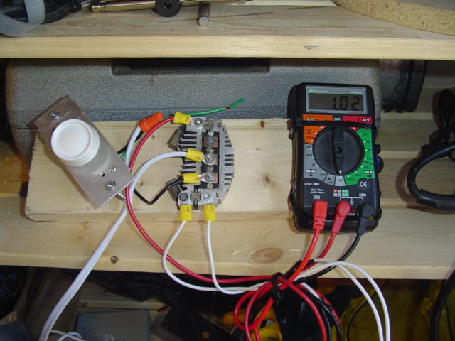

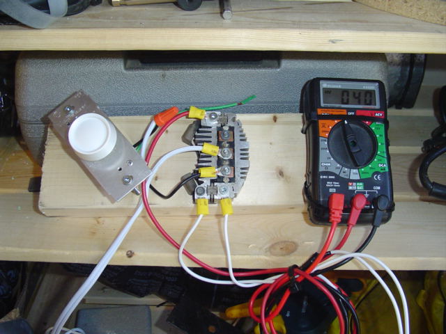

Welding is really fun.
I bought my pulser desulfator and managed to repair 3 car batteries. I hooked them up in series and use them as an arc welder. I've never welded before so its been quite the experience but I'm starting to get the hang of it. After welding 1/4 inch steel for about 30 seconds my batteries and my 2 gauge cables weren't hot. Supposedly you can run a battery welder about 5 min out of every 10...havn't tested that though. Here are some pics of the battery bank.
Those are just copper tubes between the batteries. I drilled and tapped each battery post. That way I can tap into 12, 24 or 36 volts. But I've decided to always use 36 volts and limit the current with two strands of that cyclone fence wire from home depot. It is about $3 per 100 feet. I will wrap about 20 feet around a small conrete cylinder and use the jumper clip to connect to it. I've welded 1/2 inch steel without a problem..this thing has tremendous power. And even then the batteries didn't even get warm. Although that was a small piece about 6 inches long..and both sides. My big problem is seeing through my cheap helmet. I am going to get those solar powered helmets that auto darken. I also made a charger for the bank. I didn't like hooking a 12 volt charger to each battery one at a time. Takes forever and the charging isn't equal. I built a charger out of a dimmer switch and rectifiers out of an old alternator. I hooked a cheap digital multimeter up to it for reading battery voltage and amps for charging. In these pics, the battery bank is at 40 volts and my charging current is 1.02 amps. As the voltage rises, the amps fall. When it gets down to about .15 amps it shuts off. I can also leave it on and as I am welding the amps jump up to 3-5 amps or so and drop back down once I stop welding. For a 36 volt battery bank, I can push about 60 volts into it at about 10 amps or so. The dimmer only handles 600watts and at 120 volts, that is 5 amps. I tested it on just 12v and could get about 20 volts and 25 amps or so. I had to use a different meter though...that one is limited to 10 amps.
So, this charger is no frills but it gives you a lot of control. Imagine having some batteries that you are going to repair and desulfate. Lets say what I'll have in the near future. I'll have 2x12 volts, 2x24 volts, and a 36 volt. If I jumpered these in series, then that would be 96 volts. I could hook this homemade charger up to each end and turn up the knob. When I hit the bank voltage it will start charging. So all the batteries would be trickle charged and equalized once a month if I like. I could then put the 12 volt desulfator on any 12 volt section I like. Otherwise, by the time I fix one battery, the others would be in far worse condition from just sitting there. Or, I would have to buy 9 seperate chargers. I've seen 25 amp 12volt golf cart battery chargers on ebay for $200. I've seen 12 amp 36 vot golf cart battery chargers for about the same. Mine does that with total control and only cost me $5 for the dimmer switch, $14 for the meter, and the rectifiers were free out of a junk alternator. I think I'll get some cheap digital amp and volt gauges on ebay and put it all in a nice box. We'll see :)

The thing I would do with your copper pipe interconnects is to wrap electric tape around them. That sure is a lotta power out there that is completely exposed to easy short circuits. Even better but more expensive would be to put heat shrink tubing over them.
Now I'm courious about your Dimmer Charger thingy
are you feeding it 120 volta AC and then dialing it up to the current you want to charge at ?
If this is what you are doing, then you are charging with a desulfator. The dimmer outputs sharp spikes of voltage when it is used at lower settings. You would also want to put a 5 amp fuse in series with the Dimmer
you may also be interested in this transformerless charger . . .
W o o f -={(
Re: Homemade battery welder and charger (3.00 / 0) (#10)
by Spelljammer on Mon May 08, 2006 at 12:43:14 PM MST
Woof,
Yeah, I agree, I will put some electrical tape around the copper pipes.  And yes, I am feeding 120 volts ac to it and turning it up until it hits the current I want.
The beauty is that I have it set so my batteries are floating at 42 volts.  If they drain slightly then the amps flow at about .1 or so.  If I start welding they will jump to about 3 to 6 amps or so depending on voltage drop.  After a few min of welding, for example, the amps will be at 1.5 or so and slowly dropping.  Within an hour the amps will be at about 0.5 and slowly drop to about .1 after awhile.  It basically shuts itself on and off to float the battery at my setting of 42 volts.  When the weather gets warmer, I'll bring that down to 40 volts.  And once a month I'll equalize to about 45-48 volts.
I love that schematic you enclosed...gives me some ideas.
Spelljammer

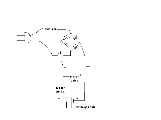

by Spelljammer on Mon May 08, 2006 at 01:02:37 PM MST
here is a simplistic diagram of my welding current control system. Just steel wire around a concrete cylinder and a jumper clamp for adjustment. My connections to the battery are also clamps so I can reverse polarity.
Spelljammer

However someone correct me if I'm wrong... but with your charger connected to the grid.. It's possible that either your welder ground clamp and or Electrode could to be electrically connected directly to the grid as well... In such case you could accidentally receive a nasty or even fatal shock or electrocution ?
Just something to check for : )
One possible way to alleviate this would be to plug your light dimmer switch into a isolation transformer. Sometimes these things sell really cheap on Ebay.
Happy welding wishes to you : )

John, I agree it does worry me so I'm going to take Woofer's advice and put a 5 amp fuse on the ac side. If the dimmer lets the full power come through, then that 5 amp fuse would blow.
Spelljammer
Re: Homemade battery welder and charger (3.00 / 0) (#23)
by RP on Tue May 09, 2006 at 10:02:04 PM MST
I'm very concerned about the grid tie thing.  A 5 amp fuse will happilly continue making your muscles convulse long after your heart has stopped.  An isolation transformer is really called for here.  At the very least get a GFI ground fault interupter outlet from the hardware store and wire it in series with your dimmer.  They are designed to deal with this kind of situation and could prevent an unfortunate incident.

By the way, this is going into two 24 volt forklift batteries in series for 48 volts.
Spelljammer

Re: Homemade battery welder and charger (3.00 / 0) (#32)
by Spelljammer on Wed May 31, 2006 at 12:31:07 AM MST
actually the dimmer switch only works with AC
Spelljammer

Years ago, when I was still busking (street performing)at Sydney's Circular Quay, I used a car battery for PA purposes. To recharge the battery I invented my own 220V powerful charger:
I soldered a diode into the 220V Active of the mains supply wires (to drop either half of the wave) and then into the same Active wire I soldered in a (1KW4) hair-dryer to serve as a current limiting resistor. I then soldered the Active wire to the AC input of a bridge rectifier. The Neutral 220V mains wire went directly from the mains to the AC input of the rectifier. The DC output I then fed to the battery.
The charging current was about 6A at 13-14 V. To increase current to feed several batteries delete the diode in the Active supply wire. The hair-dryer was running slowly; just good enough to cool itself.
  1. V Active----->DIODE----Hair-Dryer----AC Bridge-Rectifier------DC + to Battery
  2. V Neutral----------------------------AC Bridge-Rectifier------DC - to Battery
Since I'm at it, perhaps you allow me to mention to mention thatI even build a dual tube pre-amp and a howl-around stabilizer into this portable PA. Now, with advent of computers, I somehow my interest in audio electronics faded...
