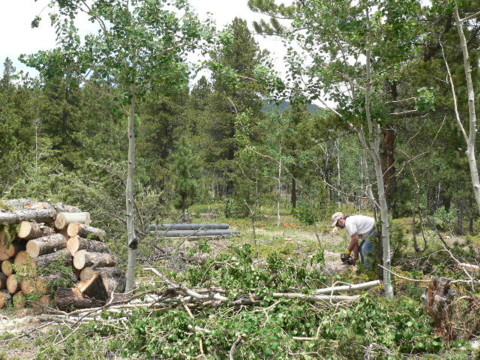

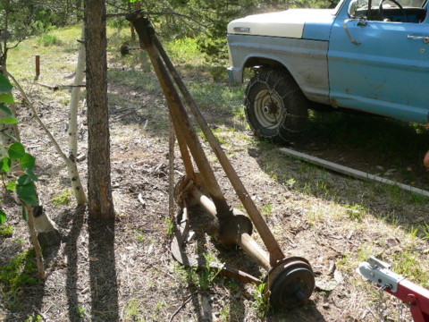

Yesterday George and I spent the day butchering perhaps 50 trees - some tiny - some large, to make room for my tower.  Had to do it - trees are everywhere and this was the  flattest/best spot on the property for my new tower.  Once that was done (it took all day in 90 deg weather) we layed out exactly where the tower and the anchors will be.
Pictured above is the rear end/rear spring/driveshaft assembly from a Model A Ford.  We'll put these about 6' under and they'll serve as the 'dead men' for 3 of the guy wire anchors.  The drive shaft will stick out barely and we'll weld to that to attach guy wires.

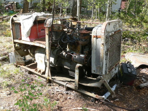

Here's a very heavy (I estimate at least 1200 pounds) old 10KW Okeef Merit military generator with a Jeep engine.  This will also go 6' under, and we'll weld various bits of steel and re-bar to it and then pour concrete over it for the 4th anchor (this is where the winch to hoist the tower will exist).
Tomorrow we'll have a backhoe up to dig the holes.

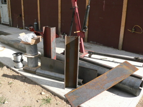

Last week I spent about $500 on cable, cable clamps and thimbles and chunks of steel to make the base of the tower.  We'll probably get the base welded up on Thursday with any luck.

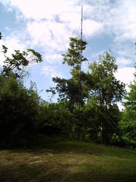

 I just made anouther section for my tower. I made my tower out of that 7/16" wall 3" outer diameter pipe. It weighs 1,100 lbs at 54' now. The gin pole weighs about six hundred at 26'. You might like the block and tackel method. I put a double at the top, and a double at the bottom. Then I put a single at the hinge and acualy pulled from about 160 degres. It was 180' of cable on the pulling down the hill in the picture. It reduced my pull to 1/4 the pull if I were to pull it straight. I was able to idle my lawn mower in reverse, and even get off it to check the guys where a tree gets in the way. I will cut some trees to get my van back there when I do the final lift. I was surprised it was so easy to lift. I bought the pulleys on e-bay for $13 a peice. They where acualy singles put together as double blocks. The gin pole was going about 1' for every 4' I drove down the hill. A big winch is the way to go but they cost so much.

         Sheesh mate what a waste using that old genset with the jeep engine. I suppose the motor is seizd up and the genset is buggered for you to give it a burial. One would of thought a cube or 2 of cement would be the best solution and by using your scrap steel would make for good re-enforcing. But each to his own, best of luck with the fabrication of the base and I can't wait to see some photo's when it's all finished.
Cheers Bryan :)
Re: Monday June 12 (3.00 / 0) (#18)
by asheets on Wed Jun 14, 2006 at 10:25:11 AM MST
I was about to say the same thing...  I hope you recovered usable components from it...
To bury that underground... I think it is wasting of good things, which could be useful for somebody else. Why not trying to sell the machine using 'classifieds' and then using concrete?
Some time ago one of my friends intended to use

Re: Monday June 12 (3.00 / 0) (#13)
by DanB on Wed Jun 14, 2006 at 07:06:15 AM MST
these are not good parts.  One is all ground up inside, the others have been sitting outside for perhaps 30+ years (theyre full of water, the tapers on the shafts are very rusty etc).  There's not mucgh of use here other than castings.
Model A rear ends are fairly worthless - very common parts.  Lots of folks 'hot rod' model A's still so there's lots of origional running gear available.
These ones go 6' under today ;-)
theyll hold my tower up and itll help clean up my yard.

Re: Monday June 12 (3.00 / 0) (#12)
by DanB on Wed Jun 14, 2006 at 07:02:47 AM MST
it has multiple major problems - not worth fixing.  I've been trying to give it away for years, nobody wants it and I cant blame them.
