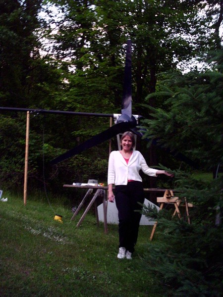

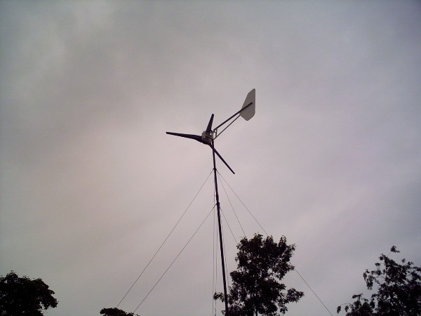

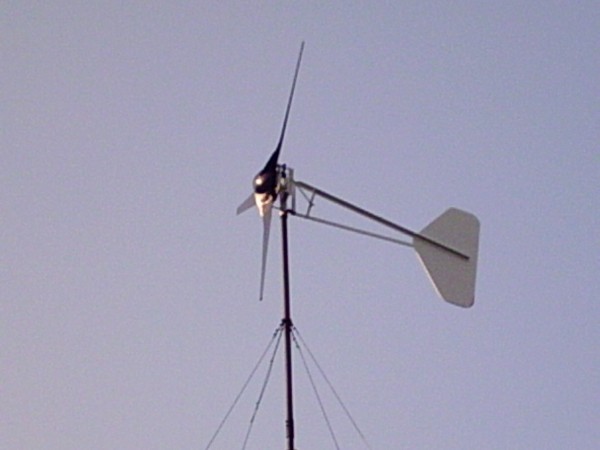

 I have been working on this machine for over a year. Now its up! This is my first project, and it was quite rewarding. I want to say thankyou to Hugh Piggott, Otherpower, And all the great people who helped answer all my questions. There is nothing like the joy of seeing it work so quietly,and smooth. It's a proud felling. I only ran it for a couple of seconds, a couple of times. The first time I thought there was no wind, but it started up real slow. The secound time I couldn't believe how fast it started. I had to short it out real quick because I don't have the ground wires hooked up yet to the batteries. It was only in a slight breeze! I can't weight to get the controls hooked up so I can let her rip. I still have to figure out the dump load. I have an sw2440 Xantrex inverter That I plan to grid tie once I get it all figured out, and ready for permit. Thankyou all! I am a happy man.

JMK;

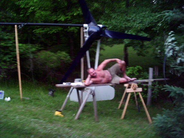

Hey, there is some guy hanging out on your sawhorses. I suggest you put him to work before he gets away!
Nice looking unit.

by jmk on Sat Jul 01, 2006 at 03:54:22 PM MST
 When I was wiring it up, standing on the saw horses, I had tw o baby fawns run up to me. I was surprised that the mother who was about twenty feet away didn't scold them. I also thought it was neat to see a red fox trot by.

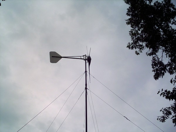

 We have been getting to what I would gess to be 20 mpr winds today. I have the machine shorted out because I have to run the ground wires yet. But I am a little surprised to see that the blades will turn in the stronger gust to about 5 rpm. I thought it would be up there dancing all over the place, but it seems to stay within 90 deg of yaw movment. Should the blades be spinning at all when shorted out? I might have set the gap to big. I have about a 3/4" air gap. After reading the past few poast I was scared the rotors were going to hit the stater and cause some magnets to go flying. It really wants to spin. I can't wait to let it loose!
jmk
Re: Hugh's 12' up at 54' (3.00 / 0) (#6)
by DanG on Sat Jul 01, 2006 at 05:10:11 PM MST
Has to spin up enough flux to cinch rpms back down, zero rpm equals zero brake action.

Re: Hugh's 12' up at 54' (3.00 / 0) (#7)
by jmk on Sat Jul 01, 2006 at 05:49:54 PM MST
 Oh man! Start up is excellent. As far as its furling capability I haven't been able to let it spin up to that speed yet. I have the brake switch on.

by richhagen on Sat Jul 01, 2006 at 11:01:44 PM MST
It looks great!  I agree with Tom, you should get that guy on the saw horses to help you out a little bit more.  It will probably be difficult, but try not to let that guy spend too many hours just watching your beautiful turbine spin in the breeze.  I hope the 'permitting' goes well for you and that other guy.  Rich
Re: Hugh's 12' up at 54' (3.00 / 0) (#11)
by jmk on Sun Jul 02, 2006 at 08:17:53 AM MST
 Yes, I need to really give that guy a kick start. Here is the one who just likes to watch.

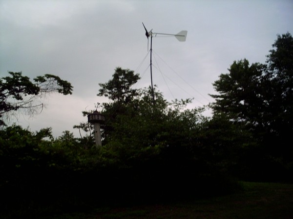

Re: Hugh's 12' up at 54' (3.00 / 0) (#15)
by jmk on Tue Jul 04, 2006 at 08:49:41 AM MST
 I've been hooking up grounding wires to the guys and cleaning up the yard. I mowed the grass where the tower was,It was getting knee high in some places. It's been a buisy week. I am going to get started on the power lines to the house. I was going to put it in my shed, but decided to put it in the garage. I have a ten foot cable to hook the batteries to the inverter. Xantrex states that the inverter shouldn't be directly above the batteries. Should I place it off to the side or is it better to put it under the bank? off to the side will eat up more room, but I will do it if it's better than below.
 It survived the first gusty electric storm this morning. We had probly had 50 mph gust and lightning striks all over. I couldn't keep my eyes of the mill! I didn't see any strikes hit it. The blades with the brake on probly got to 10 rpm. The brake is getting me nurvous! Everything seems to still look fine. The lightning is even scaryer. I'm afraid a bolt might ruin the brake system. I think it would have been smart to have added an alterate brake.
