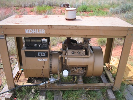

I have a Kohler 15RMY62 208V 3 phase 15 KW generator that is producing 30 VAC (rms) at 1800 rpm.

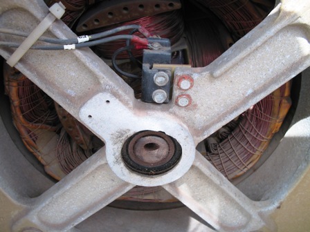

The original diode showed a short between AC/DC sides and brushes have been replaced.
I disconnected the field windings from each other and they are 0.9 ohms each. The wiring has no visible signs of burning or discoloration.
I flashed the 4 pole wound rotor with a 12VDC battery thru the brushes when it was not running. No change.
Next, I added a heavy 13 ohm nichrome resistor load between one phase and the neutral. I understand some gennys require a load to make electricity. Still 30 Vrms, 64.4 Hz. Good sine wave though.

I am not familiar with the type of generator but it sounds as though it is a brush type, not a capacitor excited one.
How does it produce its field, is there an AVR or is it excited direct with some form of compounding. Was it a single diode or a bridge.

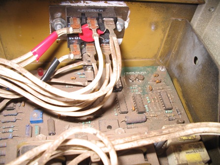

I'm not sure how the field is produced. Can't find anything that looks like a capacitor.
I'm going to attempt to post pics for clarification.
I think it is a brush type.
AVR with bridge?

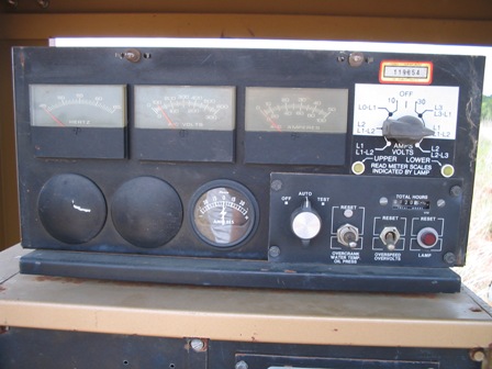

here are other photos that may help.
http://www.otherpower.com/images/scimages/1110/generator_006.jpg
http://www.otherpower.com/images/scimages/1110/panel.jpg
http://www.otherpower.com/images/scimages/1110/generator.jpg

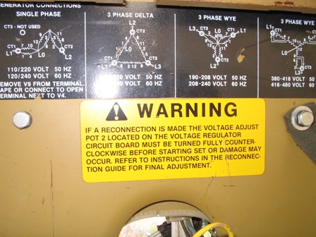

I second that.  The brush assembly is a giveaway, as is the printed message about adjusting "pot 2 on the regulator board" and the picture of a circuit board covered with integrated circuits next to a cluster of three small transformers (probably the step-down transformers to power the circuit board and provide it with a stepped-down sample of the voltage).
All that stuff about self-exciting generators doesn't apply.  This one has a voltage regulator powered by and sampling the output and providing an excitation current to the rotor through the brushes.

Afterward you might try making a small adjustment to "pot 2" and see if the output voltage follows along.  That's probably the output voltage adjustment, or a control related to the voltage input level.  The warning is probably because it interacts with the winding configuration such that a change in configuration might cause the unit to overvoltage and burn out the electronics if it isn't re-tweaked before spinning - and to avoid people frying the machine they tell you to turn it to a safe setting when changing config, then bring it up once you're spinning, according to the manual's instructions (which may have more details on how to do this safely and correctly).
You should try to get hold of the manual if you can, before fooling around with it.  Contact the manufacturer for them.  They'll probably be helpful, and the manual is likey to cost much less than fixig something you break by tweakig without it.

two possible problems, your voltage regulator is shot, or the main board is so filthy that it is screwing up the electronics. looking at your pics, i think the dirt may be a main culprit there.
get out the pressurized air line and give it a good blow job  :)
i would almost bet 2 cents that will do the trick. (blow everything off well)

Now having seen the pictures, the others are right, it has an AVR and the bridge will be a diode /thyristor(SCR) combination that rectifies the field in proportion to its needs.
If you have changed the bridge, try it for a few seconds without the red transient suppressor (round thing) in case that has gone faulty.
Try the advice about cleaning the AVR board, even using a solvent such as isopropyl alcohol if necessary as you may have short circuit paths across the sensing circuit.
The place to look at is where the the ac sensing voltage ( likely from 1 line) comes into the AVR board. A shorted top end resistor will cause the AVR to think the machine is at rated volts.
Failing that it will likely be an expensive AVR replacement.

In the meantime, all the boards were washed in alcohol, blown off with air and returned to their places. Air alone didn't take care of it...too much grime. Another test run this afternoon.

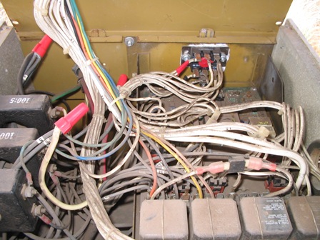

The $1000 AVR board was bad. I replaced it and the unit still would not work. The unit has 4 relays. It seems someone had played a shell game with them before I got it. The relay on the far left in the pics should be a 120 volt relay. The other 3 are 12 volt. I also had to figure out the wiring on the terminal blocks. Some was connected to dead terminals. Still no voltage. I flashed the field windings while it was running and it came to life VERY quickly, just as Underlightning Rod suggested. Again, Thanks for the help!!
