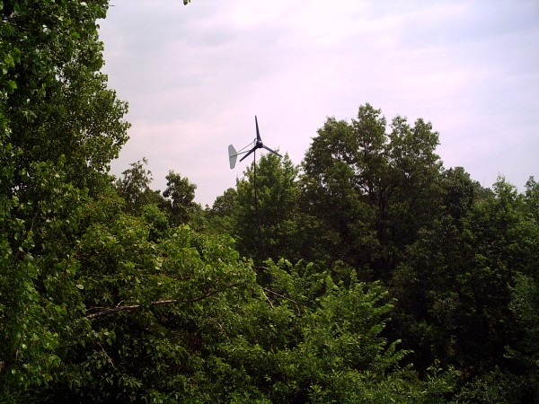

 Here is a picture taken from standing on my roof. The blades hardly ever stop.
