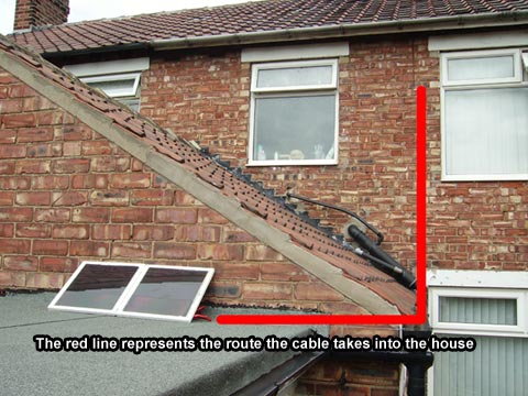

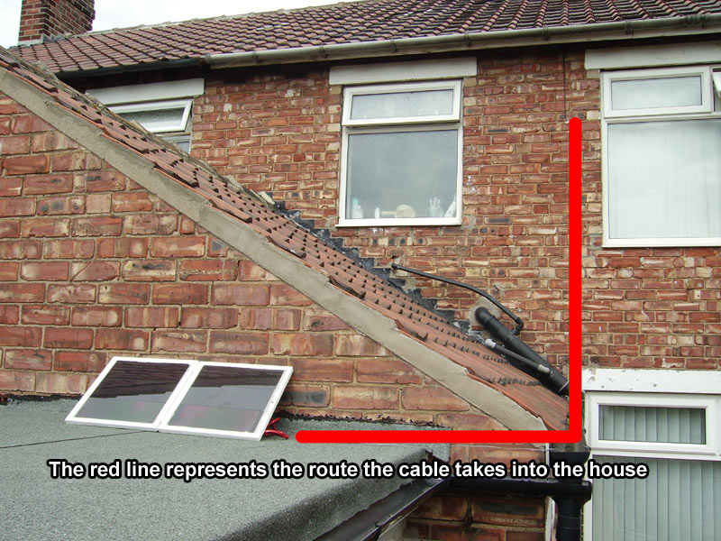

Ive just completed (after 2 months of very slow work on this project) my 6watt solar array. I mounted it on my shed roof today and its working well even though it is completely overcast.
Larger image here (145KB)
Im currently getting 150mA into my battery which is now nearly charged (13.2v). Ive seen 510mA into the battery in full sun under tests so Im hopeful now its fully in place.
I designed the array to be portable so I can take it camping. Because of this the panels fold up into a briefcase sized package for easy transport. It also protects the panels.

Its completely water proof. The panels are stuck down to the plywood with some sort of silicon and then a silicon sealant around the edges stops the water getting in. The wood is primed, undercoated and glossed to stop the wood being damaged. With my Dad being a joiner he knows how to do things profesionally (hes being doing it 30+ years), and has being helping me out.
Its overcast again right now and Im getting 60mA at 13.24v at the battery. I flattened it to 12.7v last night with lights so its almost charged already.
