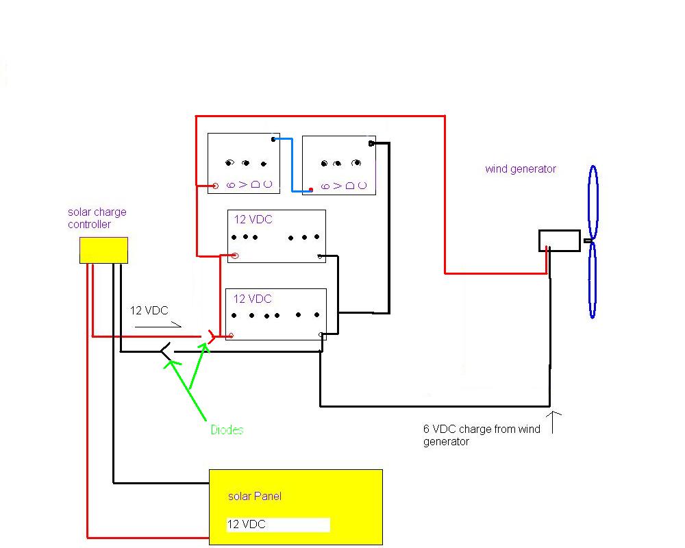

I would like to know if there is any thing wrong
with wiring my wind generator like this.
my wind generator produces a more constant charge at a
6 volt charge than a 12 volt. I rather be charging my batteries
most of the day than waiting for stronger winds only once in a while.
I have a 150 watt solar panel that charges a 12 volt bank of batteries
and I have my wind generator charging into the bank at 6 volts
I have two 12 batteries wired parallel and two 6volt batteries wired in series all wired together as 12VDC.
is there any problem with doing this. I don't see any problem with it but i could be over looking something.
Luckeydog

here is the ms paint drawing how it is configured.
don't laughf I don't have a degree in ms paint :)

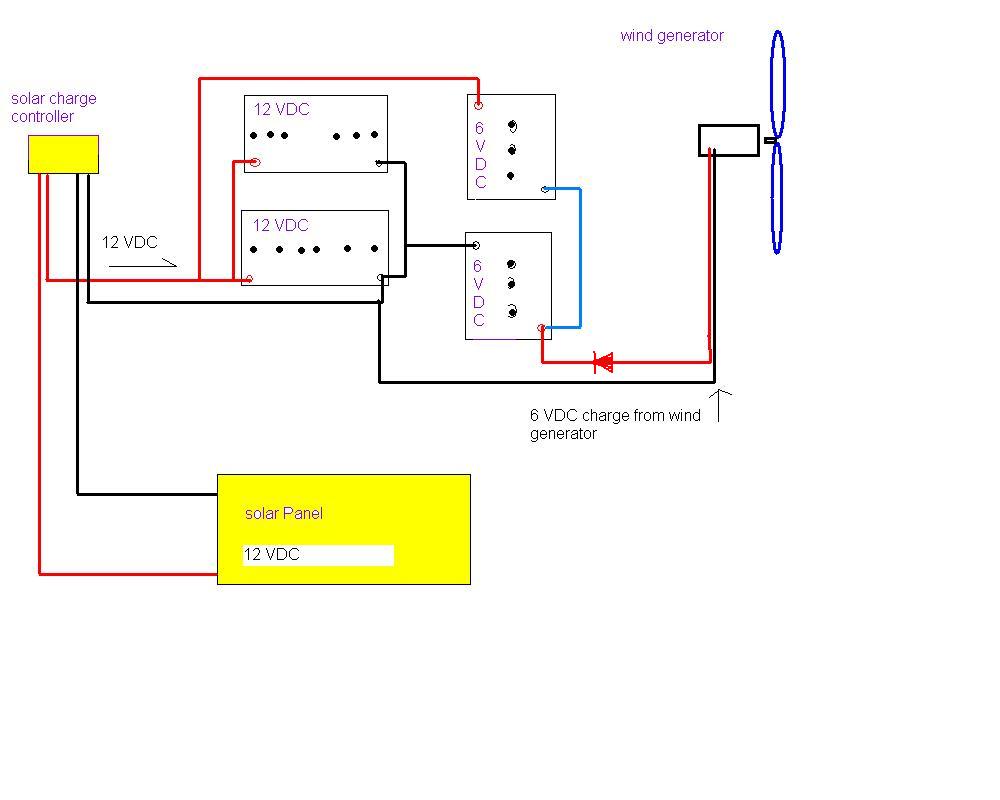

I think this is more like what you want. The diodes may not be necessary, depending on the circutry of the solar charge controller, better safe than sorry.
With the way you had it drawn, the windmill would send full voltage through the lower 6 volt battery rather than split it between both 6 volt batteries.
Unless the combined capacity and voltage of the 6 volt batteries is close to the capacity and voltage of each 12 volt battery you will have problems. There have been several postings in the past about mixing batteries. Whenever you have two significantly different batteries you have potential for problems.

 the way you have it drawn I would have the cut in voltage
at 12 volts. what i want to have is a cut in voltage of 6 volts.
yes i can split the current between the 6volt and 12 volt but it will still have
a cut in at 12.

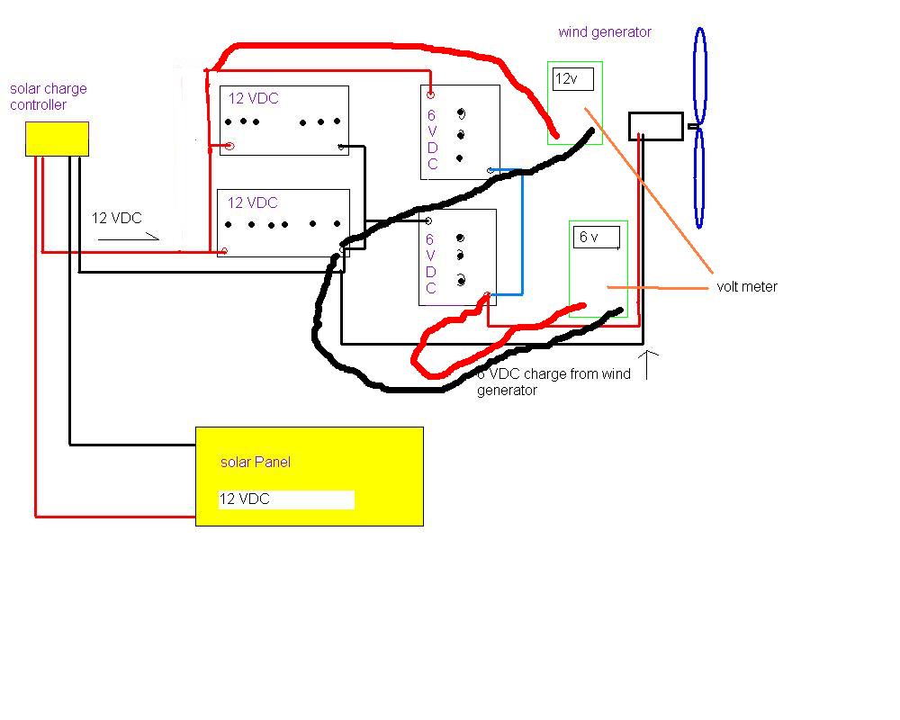

 Here is another of my skilled ms paint drawings of what the voltage reads with the volt meter.
and i am glad you brought up mixing batteries ... I did not think of that.

Looks like you have positive coming in to both terminals of the upper 6v battery.  That battery would be receiving a reversed charge from the 12v charging system.  Unless I'm mistaken, it looks like this won't work.

ok now that makes some sense to me ... should I have a diode where I have it colored blue where the 2 6 volt are connected in series.

I could be wrong...I have what I call a good understanding of simple circuitry, but I have no formal education or training regarding this, so my advice is at your own risk.  I just know this setup is working for me.
I think this is what you should be seeing:

as drawn, the windmill's power will flow only through the upper left diode, around the jumper and out through the upper right diode.  Even if you manage not to blow the diodes open (or worse, short), you will not charge the batteries in that arrangment, as all you will have is the 2 diode voltage drops for charge voltage.  (figure 1.4-1.6 total Volts, as ball park numbers with cheap diodes. . . . if you're using schottkey diodes, it'll be even smaller. )
if you can get usefull current  (>3 amps) out at 7 volts or so (needed to actually charge a 6 volt battery) then a simple time-delay relay that flops the gen back and forth between batteries once per second (or whatever) or other ad-crockery might do the trick. I'm not recommending that course of action. . . eventually the relay will quit or weld itself, and you'll be back where you are now.  But it could potentially get you going until you can make a better fix.
My vote:
save the heartache and modify the mill to make more power in the winds you have.

The lower right 6V battery is the only thing being charged with wind.
The both 6V batteries, and the 12V batteries, are being charged with solar.
The pair of 6Vs are at the same voltage as the 12V batteries.
Meaning, the 6V being charged by the wind is over charging, while the other 6V is under charged.
Not a good situation. I expect both 6V will have short lives.
Changing the PMA doesn't need to be expensive.
Like $30 for another Ametek or PM motor...
Maybe stop at the local furnace repair place and ask about a blown-up GE ECM or 2. Or 3!

Nope. For clairity, remove the 12V batteries and solar panels.
Solar charging amps and the 12V batteries are not relative to windmill charging amps.
If there is a 12V load, both 6V batteries supply current equaly.
The windmill charges 1 battery. The other goes dead.
"like having two air tanks connected by one hose"
If current flows from the charged 6V to the dead 6V, that is a load and will make the dead battery... well, 'go more deader'.
Now add the 12V and solar back in.
The solar amps are charging both 6V batteries equaly, so it has no effect on their imbalance.
If both 6V batteries are the same voltage, the windmill is doing nothing of any significance.
See GeoM's post starting with "Flowing power..."

mmmm. no.
I was trying to say:
the windmill will charge no batteries if connected according to the last drawing.
the solar panels will still charge all batteries, albeit with some losses from the extra diodes.  I suspect that's what's going on in your case.
