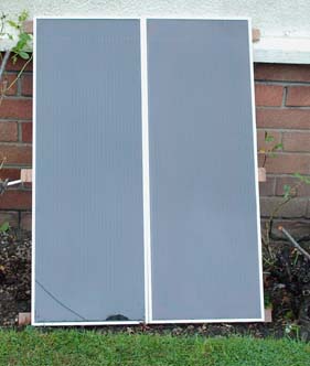

My 40w array

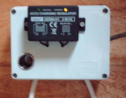

These are my new solar panels that I got yesterday to power my workshed. They are two 17/18w amorphous panels braced together with plywood and then paralelled. I got them off ebay from seller esolar2004 and they've been great so far. I also got a Haze 33ah SLA battery to charge and a 5A regulator from Maplin. Here is my control box with the regulator and a cig. lighter socket:

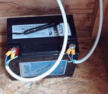

And the battery:
I used two 16A 3 core cables to connect to the battery. This gives me three cables, one I've used to connect the solar panels and the other cable for the cig. lighter socket. This gives me one left over to use for something else if I need to. I'm letting it charge up right now and then I can use the power!!

Re: My new solar panels (3.00 / 0) (#4)
by ghurd on Sat Sep 02, 2006 at 06:11:42 PM MST
Hey Angus, it looks good!
Quick thought.  One wire runs from the controller, past the cig lighter plug to the battery, back from the battery to the cig lighter plug?
The wire to the battery carries about 2 amps.
The wire from the battery to the lighter plug carries 10 or 20A.
The 3rd wire carries nothing.
Connect all 3 wires to the lighter plug and battery.
Connect the controller wires to the lighter plug.
All 3 wires carry amps to the inverter.
Allow for fuses.
I usually do it that way, often using black & red wire from cheap #10 jumper cables.
One large wire to the battery. All the 'stuff' is in one place. May have a pic if you are interested.
Use that 12V iron. Let it get all the way hot. Solder those crimp connectors on, good and hot, lots of solder wicking up the wire inside the insulation. Give it a little flick to remove extra solder where the screws touch.  It should feel solid a cm up the insulation.
Be ready for a blister from repositioning the hot yellow plastic insulation.
I would expect less problems with the inverter shutting down from a false low battery.
Less problems with corrosion, etc, also.
Ghurd.info
Re: My new solar panels (3.00 / 0) (#8)
by fungus on Sun Sep 03, 2006 at 07:29:01 AM MST
Ghurd, I used the separate cables so I didnt have to have multiple connections with wire crammed in. Thanks for the tip with soldering the connectors, I'll just use pliers to get the insulation back on :-)

Re: My new solar panels (3.00 / 0) (#5)
by tecker on Sun Sep 03, 2006 at 05:43:43 AM MST
Is that one cracked or am I .
Re: My new solar panels (3.00 / 0) (#6)
by AbyssUnderground on Sun Sep 03, 2006 at 06:14:04 AM MST
I doubt it. More likely to be a reflection of a telephone wire or power line or something.
http://www.repowered.co.uk - My Renewable Energy site.
msn[at]m3ezw.co.uk - my msn if you want a chat.
Re: My new solar panels (3.00 / 0) (#7)
by fungus on Sun Sep 03, 2006 at 07:25:55 AM MST
It's the washing line on my lawn.
