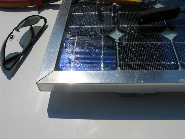

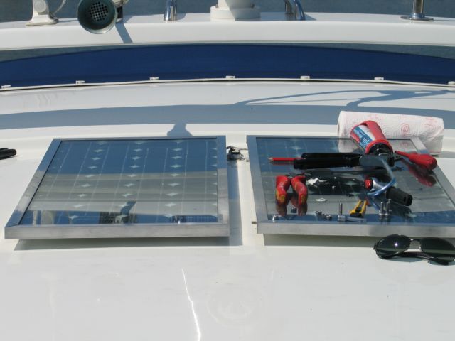

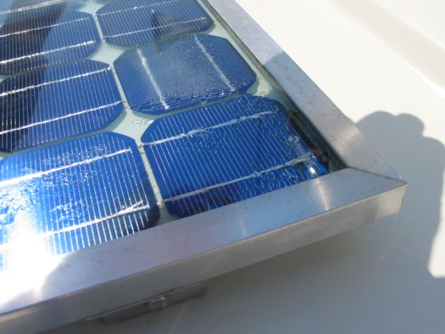

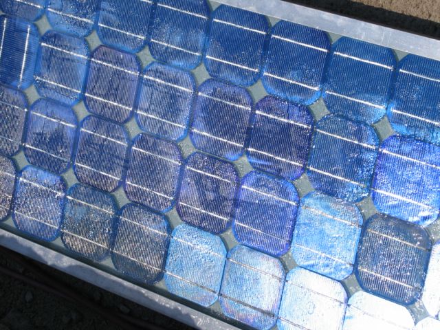

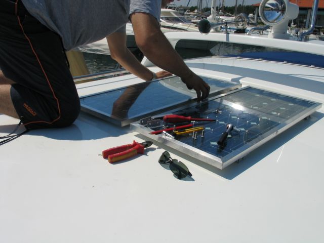

I was preparing to upload some update and pictures about my panels I am currently building...
We were building the panels like NICE (search the web)project suggests (the same principle as double pane insulated windows). We were using double tempered glass (front and back), alluminium hollow square pipe to hold the "silica" inside, to prevent the condensation, glued with SIKA Tack drive car windows glue, alluminium profile 20x20x2 mm (U-type) to hold that all together.
We sold some panels to the guy that mounted them onto te boat, and after a while he called us to inform us tht the panels are wet inside. We went to see what's happening, and it seems that the SIKA glue (silicon) wasn't thick enough, and that inside pressure "blow" it from between two glasses.
We tried some other things when repairing those panels, and after many trials and errors we can say it's all OK for a long time now.
Now, we use double glass (tempered, 4mm each), 3x3mm rubber glued to the glass with adhesive butyl rubber (both side adhesive, it uses in window making industry) to glue the glasses to the rubber, SIKA Tack drive 8mm deep between the glasses (it gets 11 mm in total inside the glass- 3mm rubber and 8mm SIKA silicone). After we leave it for a dy to stay and dry, we apply ARGON (Ar) gas inside the panel, to ensure no condensation appears. We apply plenty of gas, more than it's inside of the panel (6 l/min applied for two minutes - x2 (two times)). We take two bus bars outside the panel between butyl rubber and 3x3mm rubber, and after we glue it all together, it simply cannot leak.
We teated the panel with the internal pressure for more than 1.5 Atm (Bar) and nothing happens. We test each panel for condensation so that we put it on total sunshine for a hour or so and after that we throw plenty of cold water on the upper glass. After many errors and condensation, it seems everything is OK now.
Here are some pictures of error panels, as well as two ones we finally installed on the boat:

Hi there amiklic1, looks like you've got it down to a fine art. The argon is a nice touch and is a far superior design to mine. I'm sure with all those precautions taken moisture won't get in. There very professional looking panels, good work. I don't think I will be able to get argon in my panels, I just hope they hold up the way the are. Does anybody know how pyrocasto's panels are holding up? My panels are basically just a copy of his which I thought were quite a good solution using wood. The modular design is great. I saw his panels cracked how did they get on after that?

How do you get the wires outside the panel?
My technique was much the same as yours. I'm pretty sure the glass shop that sealed them up used that adhesive butyl rubber. I never did put mine in a frame because I couldn't scrounge aluminum cheap enough. Nice pictures, looks like you have a good technique there.
Volvo Farmer
Re: Homebrew Solar Panel Updates (3.00 / 0) (#13)
by amiklic1 on Wed Sep 06, 2006 at 04:02:46 AM MST
I am using the interconnection wires to take them outside the panel. The same ones I'm using to interconnect the cells. That way, as those wires are vry thin, and still a good conductors, I can put them betwwen the butyl rubber and 3mm square rubber used as distance between the two glasses. I am using the alluminium profiles because it cost me just 8 US$ total for each panel, and it's better and easier to mount. Also, it' uses as protective frame for the glass. I'll make a schem and upload it, soon, to make it more clear.
