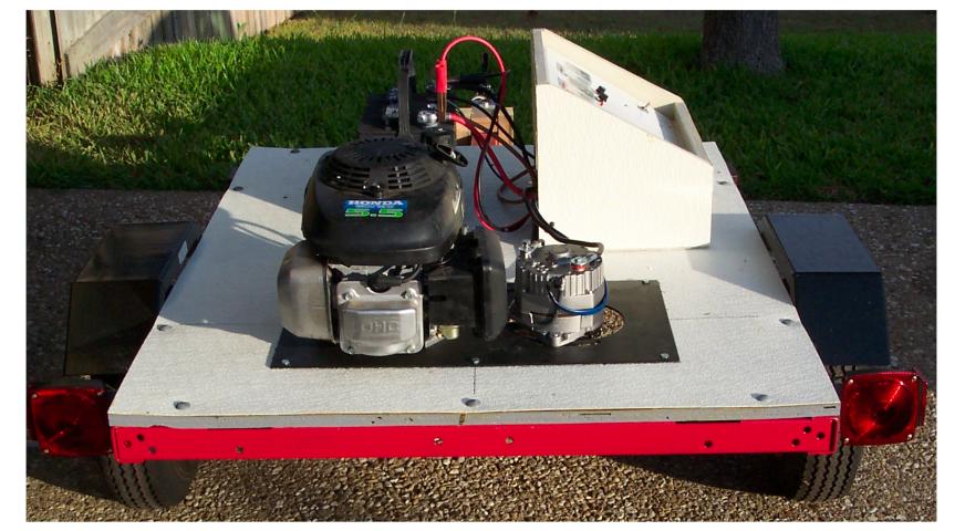

Looking for a CCW or Omnidirectional Alternator Fan
I'm building a 5.5HP Honda/DelcoRemy battery charger. I don't want to turn the alternator and motor facing each other To make the alternator turn CW. This means the alternator fan will be turning backwards and not cooling. I have been looking and cant seem to find a CCW fan to change out the existing one with. Would any of you have a line on something? Thanks LTW

Progress Report (3.00 / 0) (#14)
by LowTechWreck on Thu Sep 21, 2006 at 10:36:38 PM MST

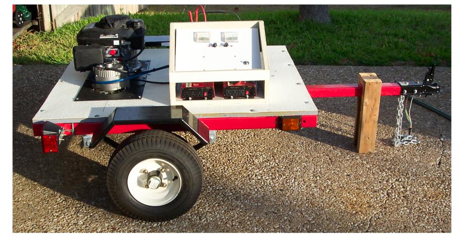

I decided to build it on a Harbor Freight Mini Utility Trailer. I caught it on sale for $139.00
It's a neat sturdy little trailer.
I thought it was so cool That I bought another one before they went off sale.
I'm In the tweaking stages now. I'm debating whether to mount the alternator under the trailer (pulley up)
and and cutting the Engine Plate in half and raising the engine side up far enough to be parallel with the
alternator pulley.

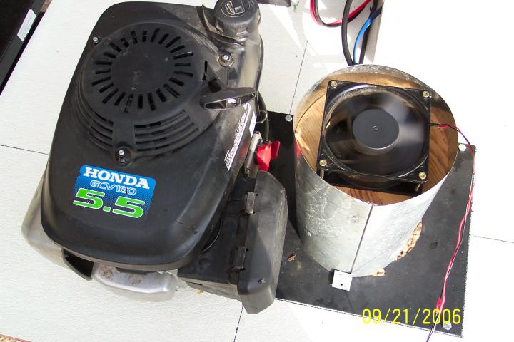

Before I do that I want to do some experimenting with the Alternator cooling.
This thing gets hot running backwards.
So I took the Fan off of the front of the Alternator because it is running backwards and blowing the heat
of the Alternator past the rectifiers instead of sucking cool air from the back and blowing the heat
out of the front.
So I got a Clothes Dryer Exhaust Duct and cut a 10 inch peice off.
Then cut a 3/4" plywood circle that fits exactly inside.
Then cut an opening for the biggest 12 volt computer fan that Radio Shack had.
I took a Green Lee Punch that I use to punch Chassis holes for 12AX7 preamp tube sockets.
That by coincidence will also accept a 1/2" ridgid electrical conduit fitting screw threads
with a wire clamp on the other end, Punched three holes
and ran the ground, B+ and Feild wire through the duct.
Then I stuffed Fiberglass insulation around the alternator so all of the air gets forced through the alternator.
It's doing the job because there is plenty of back pressure and when I turn the engine off
there is plenty of hot air coming out of the front of the alternator.
If I can add the right fan to the front it will be in excellent cooling mode.

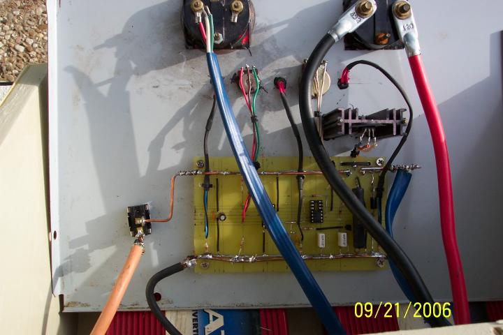

I built the Mark 8 Controler circuit Of which does not work. I'm pretty good at that stuff.
I checked it over and over before mounting it and either I blew out the chips
with static electricity or there is a flaw in the schematic. I'll change out he IC's but I don't think it works
because all three LEDS are lit up. I can see how the power transistor is supposed to work.
It's like controlling the speed of a ceiling fan by turning the wall switch on and off at different speeds.
I don't understand how the voltage regulator is supposed to regulate anything unless it is just reading
the voltage from the battery and controlling the 555 timer to put out more amps when the voltage is low
and cut back if voltage is high. Until I can get a firm grasp on this. I am going "Neandrothol".
By that I mean I am going to either get a GM Headlight Dimmer Switch or the 25Watt/25ohm reostat mentioned
in the Mark 8 article and build a 60Amp voltage regulator using a LM317 voltage regulator chip with several
MOSFet Power Transistors as Pass transistors. Something like a IRF-Z40.
I'll use two of the LM317 Regulators to regulate the Maximum Voltage to the Vector 700 Watt Inverters.
I'm goin to learn a bunch because I just am not shure about how this thing is going to run.

Interesting comments on the Mark 8 controller.   I suspected a "kit-bashed" Mark 8 unit might have such issues. I found a good deal on an Xantrex XAR-12 controller on Ebay for $110.  It and the Balmar ARS-4 are virtually identical.  I figured that electronics was not my strong suit and since I want  good reliabiliity I went with a commercially made approach.

W.r.t. the mark-8 controller, I'm going Neanderthal technology as well. I'll simply switch several 12V/1A light bulbs (bulbs in parallel), with the lightbulbs in series with the field. That way I can control field current by turning on/off bulbs. Talk about high-tech... Anyway, I'm adding a voltmeter and amp-meter to monitor what's happening. Besides, I will not run this little gen unattended (as one could do with the mark-8 controller present). I think the risk is too high.
The added fan is a bit of a kludge IMO. I think I would mount it underneath the trailer.
Have you considered adding a small airtank an compressor? The compressor could be driven by the same motor. That way, you'd have mobile power and airpressure. Add place for a toolbox on the trailer, perhaps a little welding alternator too, and you've got a mobile repair station.
I don't spot a battery in the pictures but it must be there somewhere :)
Nice trailer, btw. I could think of several other things with such a cute little thing.
Do you have special intentions with this project (because you're building it on a trailer)?
