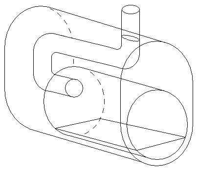

Boy, that BHM article has got me thinking.  I like the idea of the thermal mass, but my mind has got another angle to his design.  The 275 gallon heating oil tank is a great idea, but I think I can do better. (better design or better complications, you decide)
So the tank is about 27 inches wide, 44 inches tall, and 60 inches long.  Now, how about this.  A 55 gallon drum averages 24 inches in diameter, by about 35 inches long.  How about we cut a hole in the end of the lower portion of the tank to insert the drum, then route a 6 inch stove pipe out the back of the drum, about 2/3 down from the back of the tank, then 90 degrees up, and another 90 degrees to come forward over the drum, and finally one more 90 to go out the top of the tank near the front.  A large grate would be placed in the bottom of the drum and come up with a way to provide fresh air beneath the grate, and a loading/cleanout door would be installed on the front.  Now the good part.  Once it's all welded together, and placed in position, fill the tank cavity with sand.
It would look a bit like this:
Now that's thermal mass.  And nothing stopping you from going forward and adding additional thermal mass around the outside the tank.  Seems like a pretty frugal way to build a heater, since tanks and drums can be acquired pretty easily. (in my parts anyhow)
So, waddaya think?  My appologies to anyone who may have thought of this before me.
Rod
Re: wood boiler (3.00 / 0) (#11)
by nanotech on Sat Sep 23, 2006 at 09:01:27 PM MST
That's pretty much what Woodmaster did with thier stoves, except the fire door is at the back of your version and the sand is water.....  ;)
