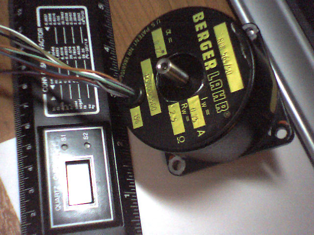

I found this Berger Lahr motor. How can I use it?
Hello,
I recently found a BERGER LAHR motor that has 10 wires out of it. It has double axes and so far I managed to identify 5 pairs of wires that seem to bring out a max output of about 3.2V at ~200mA each. No common wires seems to exist between these 10 wires. The motor is rated 5.2V at 1A, and it's 0.72 degrees.
Sorry for not being able to post any photos but my home connection is down right now. Perhaps i'll be able to post them in a few days.
My question is how should I wire this fellow? If someone can show me some sort of scheme I can use it would be great. Thanks.

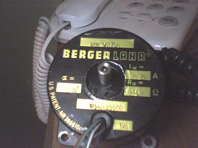

I managed to make some photos of the motor. Sorry for the quality, it's a webcam but still.. Maybe it's useful to see what is all about. And wether I'll manage to charge a 6V 4.0Ah SLA battery with this one.

Looks like a fairly standard heavy duty stepper.
The numbers look OK.
