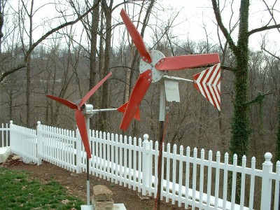

Re: Tape Motor Help (3.00 / 0) (#12)
by FishbonzWV on Fri Jan 12, 2007 at 06:01:18 PM MST
I built these mills with the Hathaways.
This set of blades did the best job but they took a lot of wind. Probably 20 mph to get 9 amps. They were 38" blades.
Bonz
