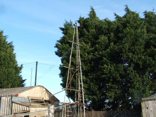

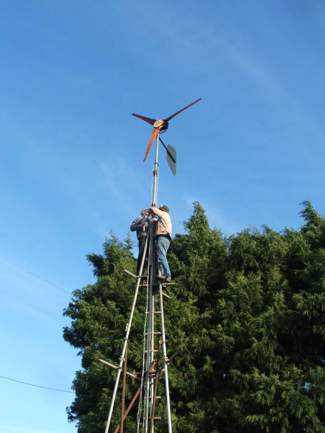

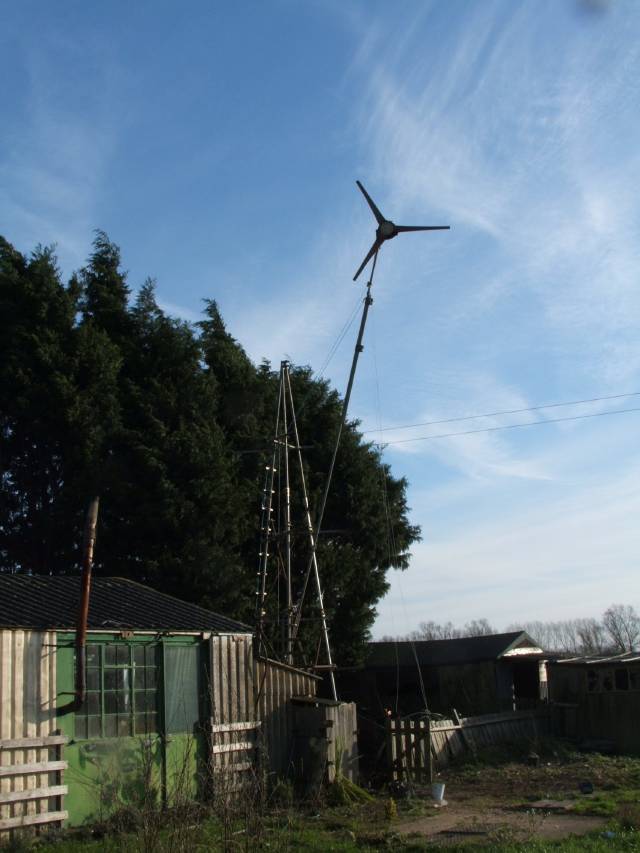

my new 40ft scafold tripod tower with tilt up centre mast
not seen much info on scafolding being used to construct tripod towers, so thought i would build one for my 10ft turbine with a center tuilt up mast specifically designed to be raised and lowered by a single person (me : -)

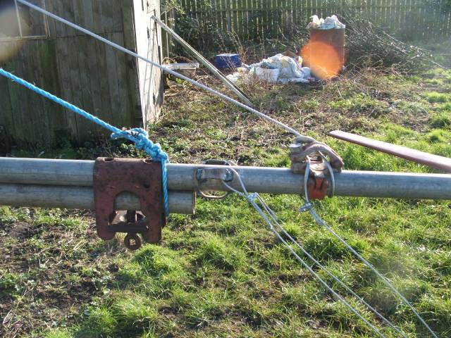

the total tower height is just over 40ft, the tripod section is 31ft, with the centre mast extending a further 9 ish ft above the tripod.

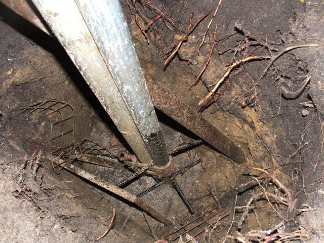

each of the 3 legs are buried 5 & 1/2 foot deep with 1/3 of a ton of concrete in each hole. the holes are about 2 foot round give or take a foot here and there : -) eah leg also has a reinforcing bar attached, and the lower part of the first latice goes in each hole... thats why theres 3 poles in each hole, we also filed the holed with steel mesh and scrap
3 cross sections and one lattice piece need to be removed when raising and lowering the centre mast. the mast is hinged with 2 scafold swivel joints at about 6ft above ground level, all joints are scafolding joints, so its easy to remove pieces of the tower when ever its needed.
about 5-6ft down from the turbine head are some guy attachments, they werent really needed, but added just in case, just below the guys the mast is doubled up with another scafold pole (this was an addition to stop some vibrations), the main 5mm winch cable and backup rope also attach at this point.

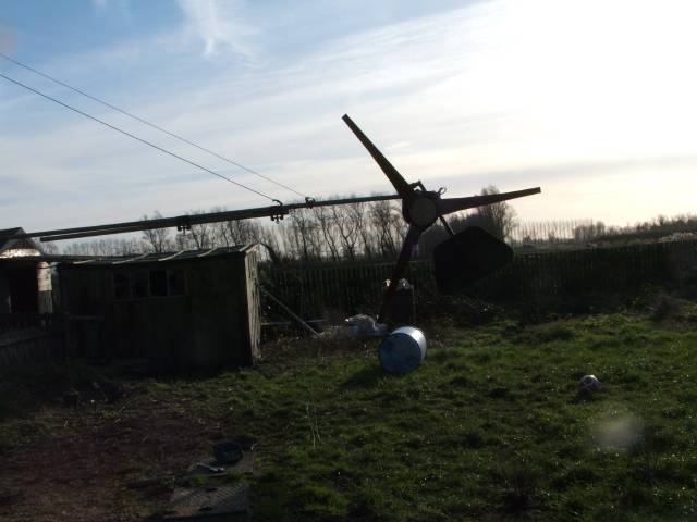

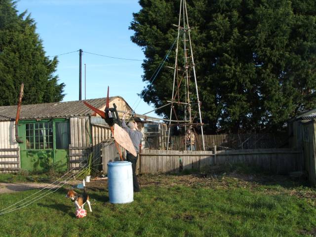

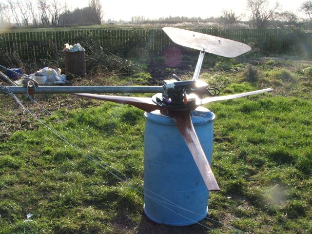

during the preperation we supported the turbine head with an old barrel
although the tower was specifically designed to be operated by a single person, i had some help over just to make sure for the first few raisings... my m8 gary tentively puts his head under a ton of mast and turbine.. he's brave
so far so good

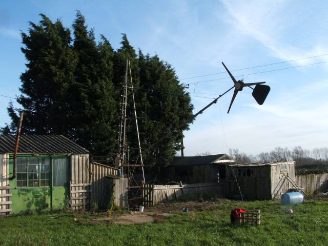

nearly half way up
even more... wont be long now : -)
getting there....

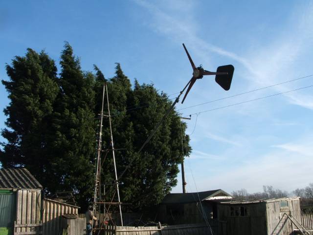

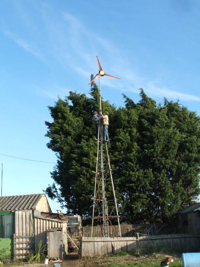

nearly.. at this point there is no more load on the winch, the tower is takinjg all the strain... there is a receiving clamp ready for the mast.
raising the mast only took about 2 minutes, mainly due to the gearing on the winch... it was slowwwwwwwww.... we then secured the mast to the tripod in its clamps.... there are 3 clamps each located on cross setions of the tower
we are working at about 30ft, i made steps up one of the tower legs, so its wasnt too much trouble, its pretty stable up there even in high winds. a bit scary sometimes though...
all up and done, the total time it took including replacing the side sections of tower we had to remove so the mast can be raised was only about 15 minutes.

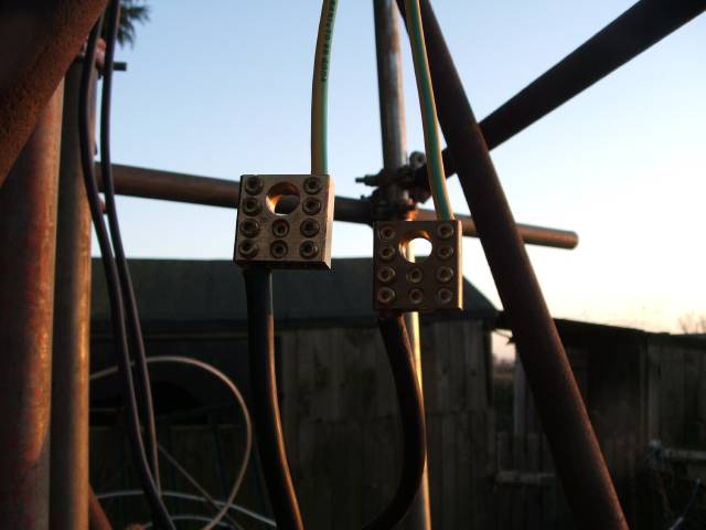

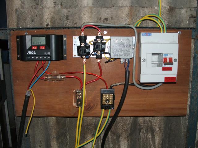

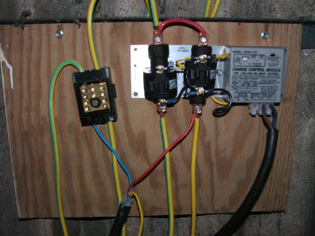

found some household mains board brass blocks, which came in handy for wiring the 25mm welding cable that comes down the mast, to the 18mm cable that runs to the batter room (only about 5 feet away)

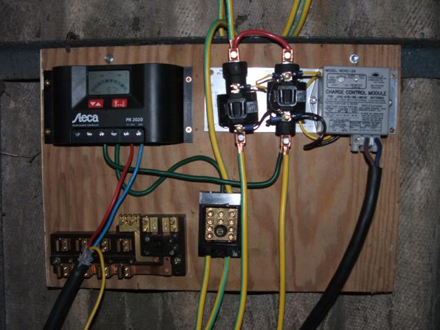

all that was left now was to wire it into the NCHC mercury switch controller

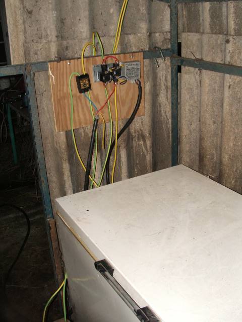

the battery room is an old animal shed attached to the end of my workshop, the previous residents run the place as a farm, so it came in handy, they also left an old chest freezer here, which made a perfect box for the batteries, water tight, and insulated from the cold weather.

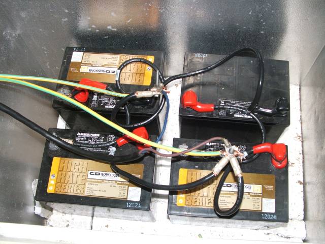

the battries are 4x 200amp hour dynasty ups batteries.. wired in series and paralell for 24v... we run a large ups at work for the servers, and replace them every 4 or 5 years, they had only ever been used twice in power outages, but i expect the ups units regular discharge testing of the batteries over 5 years has probably killed 1/2 of their life span, but they were free so who cares : -) good job, these things are like $200 each + shipping

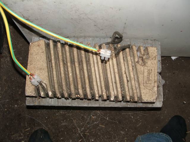

the dump load is another old thing the previous resident left round, its an old heating brick, what he used it for god knows, but had to shorten the length a little to get the right resistance. its only tempoarary until my imersion element arives

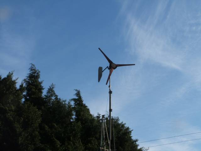

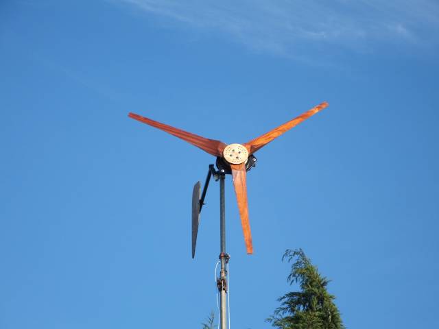

the turbine is just sitting above the conifer tree tops, but they are creating a little turbulence in the air, so they will be trimmed down a little next weekend, also need to paint the whole tower yet(green), but so far so good, there is no noticable wind outside at the moment, but at 40ft its spining nicely and charging the bank with a few amps.

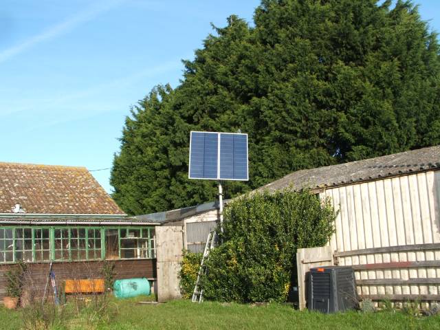

also here is my 200W solar aray, with a tracker, its currently disconnected today while we moved the batteries to the new room next to the turbine.
as an over all conclusion, if i did another tower i would probably buy a pre made one, the scafolding and joints were free, (used about 70 joints) so not complaining, but it was a lot of work, building the turbine only took a few weeks in total, but building the tower took far longer and much more effort (and out in the cold weather), its certainly stronger, my neighbour, whos a building structural engineer site forman, rekons it wil never fall over... only time will tell i spose..

more on the controller...

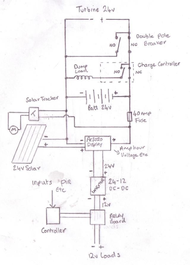

the charge controller is a direct divert contactor, it diverts the turbine directly to the dump load without connecting the battery to the dump load, they aren't cheap, but cheaper than buying two trace C60's to do the same job... the switches are mercury filled, so no burnt out relays here : -)
unfortunately there is no manual control on the charger to energise the divert relay, which would have been nice, it would have reduce the need for a seperate manual divert contactor for testing or emergency diverts.

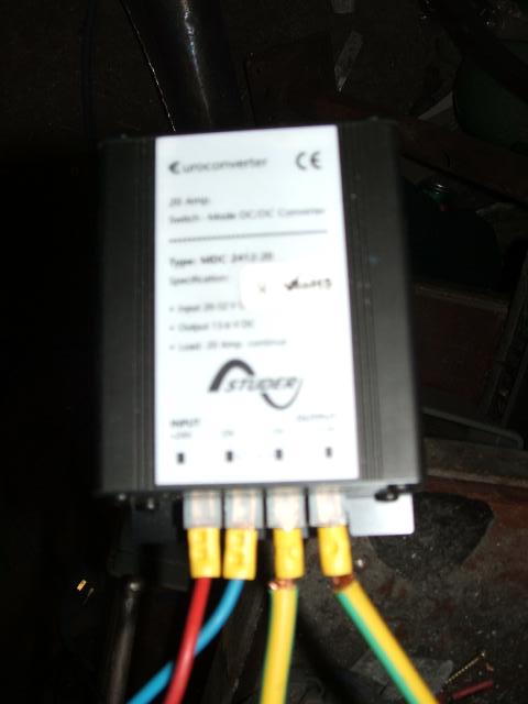

the battery bank is 20 Meters away from the house, so 24V is transported by 16 Sqmm cable(didnt need to be that heavy but minimises the losses) incase your wondering the bulk of the cable i used is 16 SQmm earthing cable (yellow & green) the main reason was price, its an identical grade of cable to the normal coloured stuff (brown, Black, Red etc), even checked with the manufacturer but its 20% cheaper !!!! weird....
the little box here is a DC-DC inverter located at the house, to drop the 24V to 12V
it doesnt photo very well cos of the glossy label.

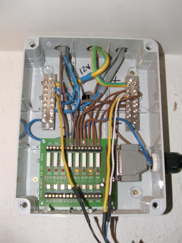

here is one of my distribution boxes with a relay board, all the loads on the 12V system are controlled automatically.

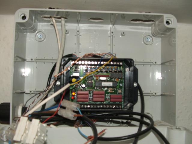

here is one of the input control boxes, this box takes input triggers from devices like PIR's

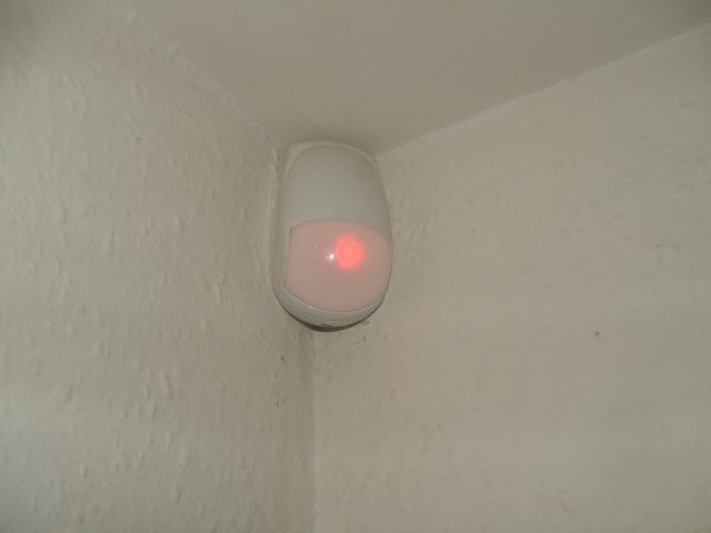

heres one of the PIR's

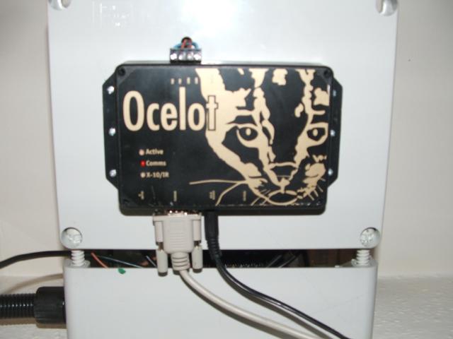

heres the heart of the system, my Ocelot, its a serial programable ladder logic controler, with IR input/output, RElay input/output , X10 etc etc
each room has coresponding programmed code in the controller for ocupancy functions, motion activated lights, and manual load control etc etc, this type of system ensures lights dont get left on acidentally and drain precious energy... its also lazy, very rarely touch a light switch these days...

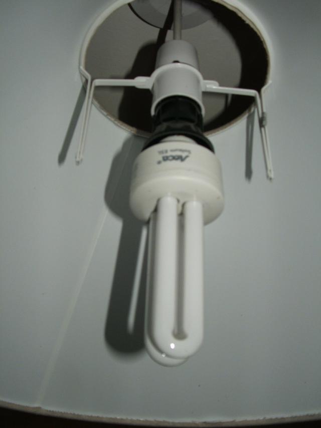

one of my 12V steca compact flourecent lamps... whats the point of generating low voltage RE, then inverting it to mains voltage... run everything on 12V : -)

more work on the main board...

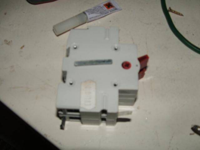

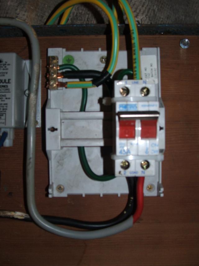

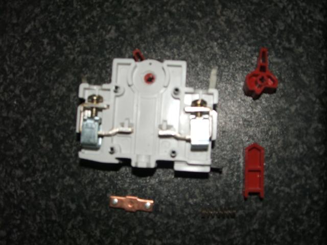

had this 45amp breaker laying around, so thought it would go nicely as a shutdwon breaker, but me thinks it needs modifying first : -)
its a double pole breaker, but both poles are broken or closed at the same time, this certainly wont do, so out comes the drill, these breakers have anoying factory riveted fixings, we do really live in a throw away society these days... but a few seconds of careful drilling, and the case is open...
ive only opened one of the breakers(its a double unit), the rocker switch needs reversing, so when one breaker is open the other is closed.
a few carefully placed dabs of super glue holds the breaker unit back together.
the breaker has a little metal cover that clips over the rocker switch ends, to ensure both switches are flipped together, this will still be useful to prevent acidental short's on the battery bank. so it was put back after i was finished.
on one side both breaker starts are wired to the + in from the turbine (at the top)
one breaker output goes to the charge controller, and the other loops back to ground. (at the bottom) the earth block in the breaker housing made a nice ground block.
a word of caution, i would NOT want to brake (short) the turbine at high RPM with this breaker, the contacts would probably burn out, so in emergencies i would stall the turbine on low resistance divert load specifically for braking before closing the breaker brake switch.
now with some fuses added etc, the board looks like this
also if your interested the schematic of the system has evolved to this

It's nice to see a high quality 12V CFL!
Just curious.  Did you "learn your lesson", or start with that kind?

i had a few LED samples, and a sample cold cathode lamp... but didnt buy them,, blagged them.... i never bothered with incandecent, just went straight for the 12V CFL's, ordered a box of 10 of them.

What is the output of the wind gen?
How big are your solar panels? They look massive from the picture.

the solar panels over all size is about 2 square meters, they are mounted on an old Horizon to Horizon satelite dish mount, designed to hold a 3M dish, so should take the load ok

Great reading, I enjoyed it and all the pics. I think your batteries are sealed so I don't know if this applies to you but maybe you are wanting the freezer to be vented to release 'fumes'  That has got to be the perfect place for batteries. Thanks for all the effort taking those pics!

the freezer isnt vented yet.. the batt's are sealed maintenance free, designed to be enclosed in an air-tight room, wouldnt want your server room blowing up when theres a little spark : -)
i will be adding some more batt's later, so will probably add a vent at that time...
