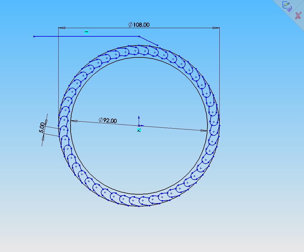

I am in the process of designing a water wheel. My question is, does anybody have an empirical formula for the optimal bucket design
Hi all,
I am in the process of designing a water wheel to harvest some energy from the exit of our lake. The head is 10 feet and flow will vary from 60 cubic feet minute to over 400 cubic feet minute. Because of the wide range in flow and relatively short head I have opted for an overshot water wheel.
I could probably get up to 30 to 40 feet head for a different type of turbine but that would mean at least 500 feet of penstock and as much of wire coming back to the house and so far my conclusion is I can't afford the pipe that could allow taking advantage of the flow during peak season.
My question is, does anybody have an empirical formula for the optimal bucket design. From the literature I have managed to find so far 20 degrees angle from the tangent of the wheel seems the best for a strait sided bucket in order to retain water as long as possible and also favour water entry while emptying rapidly before the return. But the optimal shape must be some kind of an ellipse in my mind and that is what I am looking for.
This is what I have drafted so far:

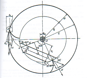

Come ti ha consigliato il grande Nando anche io realizzerei una turbina Banki.
Ti invio il mio diario relativo alla turbina banki da me realizzata, ci sono anche le formule:
                   Translate Google
As the great Nando has advised to you also. I would realize one Banki turbine I send my per diem relative one to you to the turbine banki from realized me, are also the formulas:
http://www.fieldlines.com/story/2006/8/13/6320/26408

If you are looking for optimal bucket design for an overshot... you should look up the "fitz overshoot watersheel".  There is a series of 4 articles that explained how the curve is draw "Fitz wheels" by Robert L. Omland, they start in the July 1983 issue of OMN. You can get back issues on The SPOOM web page store.  {I really wish they would post a issue index}.  I have spent some time drawing a waterwheel I intend to build for a up and down saw mill some day.  I can post them if you like {and I figure out how to post imgs}.
