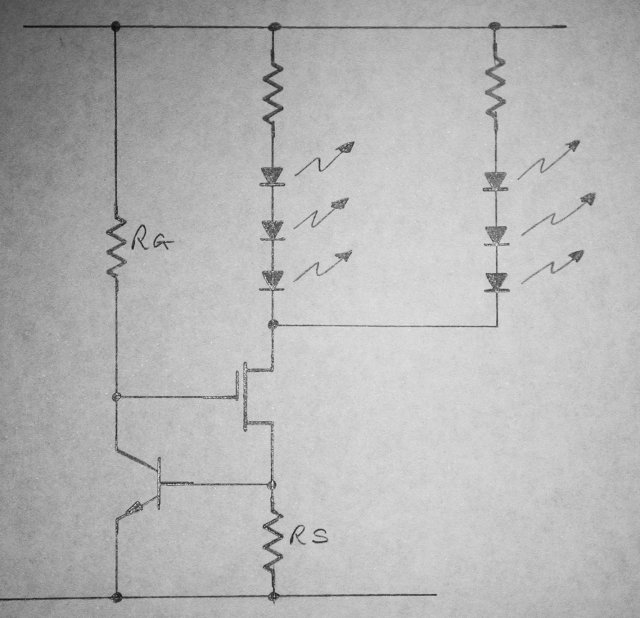

In the quest for a better solution to this problem, I have been experimenting with a newer more efficient generation of LED's.  First, I obtained some MR16 type bulbs commonly used in track lighting:
These have a driver built in to limit the current, and have 3 Cree LED's claiming 80 lumens per watt.  I was happy with the amount of light that they output at just under 3 volts from my 12V system and have been lighting up a laundry room for a few months now without incident.  On the down side is that they are rediculously expensive, so buying a large quantity would be more difficult.
I wound up having 30 boards made up with 3 of the CREE LED's. The LED's were from a bin ranging from about 80 to 87 lumens per watt.  The price nearly doubles for the next bin up from there, so for now these will have to do.
These boards are aluminum with the circuit laminated to them, which should aid in heatsinking and cooling I hope. The boards are similar to, but larger than the boards in the MR16 bulb, and the three Cree LED's are connected in series.  I will of course have to come up with a driver circuit for these boards, and hence the purpose of this post.  I was hoping for something simple, reasonably efficient, and very reliable.
I am not an electronics guru.  I read up on Commanda's posts regarding LED drivers here:
http://www.fieldlines.com/story/2007/4/20/95351/1614
http://www.fieldlines.com/story/2007/4/26/82929/6080
http://www.fieldlines.com/story/2007/5/1/74856/25992
I decided to copy her circuit 4 and attempt to adapt her "Circuit 4" for my situation.  I have linked to her sketch here for reference:
For a test power supply I used 9V batteries in series so that I could pull 9, 18, and 27 volts.  For the NPN transistor, I happened to have a few 2N3904's in my box, and for the FET, I had a few 75339P N-chanel mosfets as well.  I breadboarded the circuit with 100 ohm LED's for Rg and Rs, since I was powering only one string, I did not use an equalizing resistor.
I found that I got about 11ma through the circuit.  I proceeded to reduce the value of Rs, and somwhere along the line I noticed that Rg was getting quite warm (smoke).  Upon experimenting with that I ended up increasing that value all the way to 10K ohms, and a little more experimenting would be useful to optimize that resistor value.  Now, unlike normal LED's, I am trying to drive a steady 350ma through these.  As I reduced the values for Rs, I noticed that the 9V tap never rose above about 60ma.
I also found that I did not have a sufficiently small resistor in my box for the value of Rg.  I wound up paralleling several 10 ohm and 15 Ohm resistors.  I wound up with 3 @ 10 Ohm, 3 @ 15 Ohm, and one at 56 Ohm, all in parallel.  This yielded good results.  The circuit drew approximately 345 ma from the 18 and 27 volt taps.  The value reduced to the 330's at 27V as the FET got rather hot rather quickly without a heat sink.  The LED's were blindingly bright, although I had no way to quantitatively measure the output.
My math puts the value of an equivelant resistor for the ones I had in parallel at 1.93 Ohms or so, so I will probably try to get a few around that value that can handle the current and go from there.  With only four components, these drivers should be relatively easy to fabricate.
I am planning to put three or four boards, each board with its own driver, into one fixture to make room lights.  That way, if one driver, or one board fails, there will also be a bit of redundancy.
Absent any improvments gleened from here, my next step will be to make a few prototype board and a sample fixture for a longer term test here.
Suggestions welcomed, Rich

by commanda (alwynne at unwired dot com dot au) on Fri Oct 12th, 2007 at 06:12:50 PM MST
Rg only has to supply gate leakage current to the fet, and enough current so the bipolar transistor has some small amount of collector current to work with. On a 24 volt supply, I was using 1 M.
Rs can be calculated using ohms law. Vbe of the npn bipolar transistor divided by the drain current of the fet. Because the bipolar is operating right at the knee of its Vbe curve, this voltage will typically be closer to 0.5 volts rather than the 0.6 volts typically quoted for a bipolar transistor.
So, for 350ma, Rs becomes 0.5/0.35 = 1.43 ohms. Power dissipation will be I * I * R = 0.175 watts (negligible). 1.5 ohms is the nearest preferred value.
Re: LED lighting driver circuit for remote system (3.00 / 0) (#5)
by richhagen (richhagen (a t) Juno.com) on Fri Oct 12th, 2007 at 06:39:25 PM MST
Thanks for that, I will increase Rg and decrease Rs and give it a go.  Rich
Re: LED lighting driver circuit for remote system (3.00 / 0) (#10)
by richhagen (richhagen (a t) Juno.com) on Sat Oct 13th, 2007 at 12:06:34 AM MST
Ok, I tried Rg at 1 MOhm, I got eradic results on the lower voltages.  It seemed to work fine with a 470 KOhm resistor and the current across it should still be essentially negligible. I am planning this for a 12V battery circuit charged by a solar panel, but want it to survive if they connect it across a solar panel with no battery. This was done with laptops and a wind turbine in Fiji with apparently somewhat smokey results.  I figure the battery may need replacing first, and in spite of the best efforts users may get a little creative with how it is connected.
Empirically, I'm still coming in a bit higher at about 1.7 Ohms for my 350ma, of course with the margin of error in the resistors, it could easily shift about a bit.  These LED's can be driven at a higher current with proper heat sinking, but their efficiency goes down, their lumen/Watt rating is at 350mA.  I will order up some 1.5 Ohm resistors and then stick with the 470K for Rg, using the 3904 NPN's and the 75339P FET's that I have.  I will plan to connect the NPN and the FET to the same heat sink when I plan the tiny board so any heat from the FET will effect the NPN.  Rich

by scottsAI (user name at eml dot cc) on Sat Oct 13th, 2007 at 01:54:41 PM MST
Hello richhagen,
  1. w LED have a forward voltage of 3.3v at 300ma = 1w. (from Cree 1w LED Data Sheet)
  2. stacked will require 10v to work correctly at 300ma. (350ma is max rating, should back it off)
(LED will light with 2.6v low current, plot of current and forward voltage on data sheet.)
Check each manufactures data sheet, I have seen numbers below 3v and near 4v at LED rated output.
Using series resistance to control the power to the LED is a serious waste of power.
With 18v driving the 10v LED string, 2.4 watts is wasted, 3/(3+2.4) = 55.6% efficient. Not good.
Place all the LED in series and boost the voltage with current control to control the brightness.
(all depends on how many LEDs and supply voltage, may need to buck the voltage)
Will require a switching regulator IC and inductor, not much more costly than the components your using (except yours were free:-) The switcher should get you down below half watt loss.
Considering the cost of the LEDs, the switcher and inductor will be cheap.
Have fun,
Scott.
Re: LED lighting driver circuit for remote system (3.00 / 0) (#12)
by richhagen (richhagen (a t) Juno.com) on Tue Oct 16th, 2007 at 01:03:42 AM MST
This is to run off of a 12 volt battery system, the maximum number I can put in series for it to output much light when the battery is low is 3.  I only tested it on higher voltages to make sure it won't blow up.  I don't expect it to ever see more than 16 Volts in normal operation, unless someone connects it to a panel without a battery, and that would only be about 21 volts or so max.  I just want it to have a chance of surviving the minor mishaps that untrained people may cause by fiddling with it.
The datasheet for the LED's is here:
http://www.cree.com/products/pdf/XLamp7090XR-E.pdf
They have a forward current rating of 1 Amp maximum with proper heat sinking, they are from the P4 Bin and are rated to be 80.6 to 87.4 lumens per Watt at 350 mA. At 350mA they should have a voltage across them of about 3.3 volts or so.  Under normal operation I should loose about 2 volts or 18% of my power through resistance, mostly in the FET.  At 12 Volts and 350mA, if the LED's are performing to specification at about the middle of the bin I should see in the range of 59 Lumens per Watt in the finished circuit, which, although not quite what a new flourescent will put out, is not that bad considering the reliability it should achieve.
I am not an electronics whiz like some of the folks here.  Amandas circuit seemed like a reliable circuit that would put out steady light, and could survive a bit of abuse.  I am aware that a buck boost converter to hold the power right at an ideal point for the LED's would be more efficient, but I don't know how to build or assemble a reliable circuit to do that at this point.  It seems hard to beat 4 components, 2 resistors, a transistor and a FET for simplicity.  If there are more components, there is more stuff to break.  Where these are going, there will be no one to fix it and no easy way to replace it when it fails. I plan to put 3 or four independent drivers and LED strings in each fixture, that way if one fails to open circuit, the light will still work, just with diminished output.
Just trying to make them work - Rich

Re: LED lighting driver circuit for remote system (3.00 / 0) (#18)
by Joel on Fri Oct 19th, 2007 at 10:59:43 AM MST
I may be of some help.  Here is a circuit I use for driving 3 Luxeon I LEDs in series.  Small component count and the chips can be bought in quantities of 25 for about $11 directly from OnSemi.
http://tutorials.boilingpondscemetery.com/LEDLighting/LuxeonDriver/default.aspx
Not sure how it would fare under-driving the LEDs though.  I use it for driving Luxeons off my landscape lighting transformer.  The schematics that OnSemi has provided have so far been right on.
I have some switching supply Maxim chips coming in that promise similar results without the heat build-up this driver produces with large voltage differences.
LED driver ICs have become plentiful and cheap.  Don't overlook them.
Joel

Re: LED lighting driver circuit for remote system (3.00 / 0) (#21)
by richhagen (richhagen (a t) Juno.com) on Mon Oct 22nd, 2007 at 03:26:40 PM MST
Hi Joel, I actually did look at the catsemi chip.  My LED boards are wired 3 in series.  For that chip you need a minimum surplus of 3 volts in your power supply over what is drawn - so I don't think I can use that one for this application.  I will have to take a more detailed look at your other circuit as soon as I get a chance.  Thanks for your replies.  Rich
