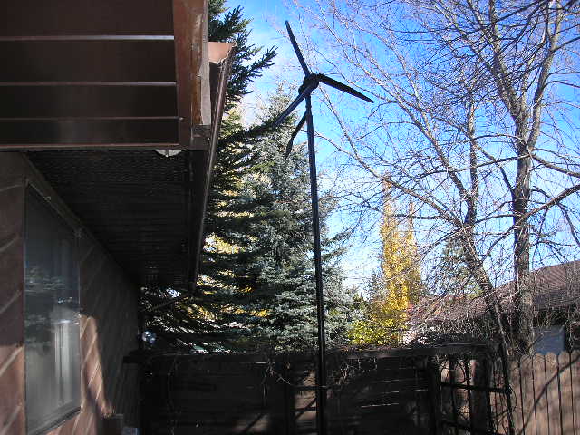

Some pics of my growing system
To you country folk this is probably laughable, but it's beginning to work for me.

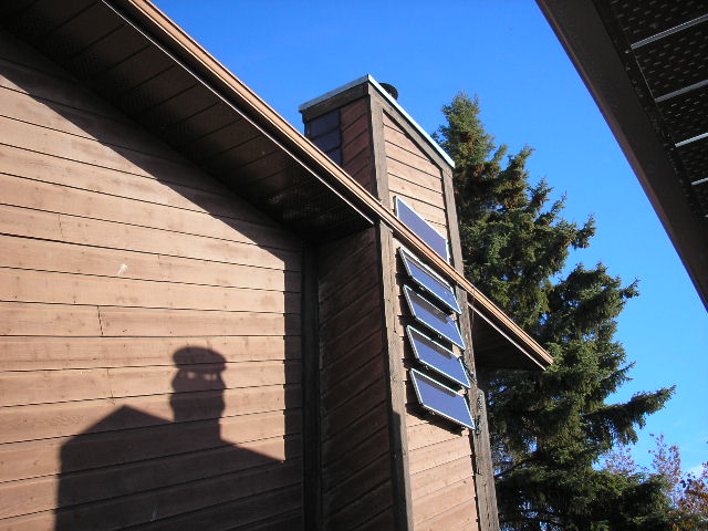

Here are the solar panels I have managed to acquire so far. Yesterday I managed to
get 4 of them tilted straight at the sun. I'll do the fifth one tomorrow. Note the use of some smaller panels on either side of the chimney. The are there to catch the rising and setting sun and are wired in parallel to get as much amperage as I can out of them.
Below is my first PVC windmill. It's on a PVC 12 foot pole and catches pretty good wind and furls nicely

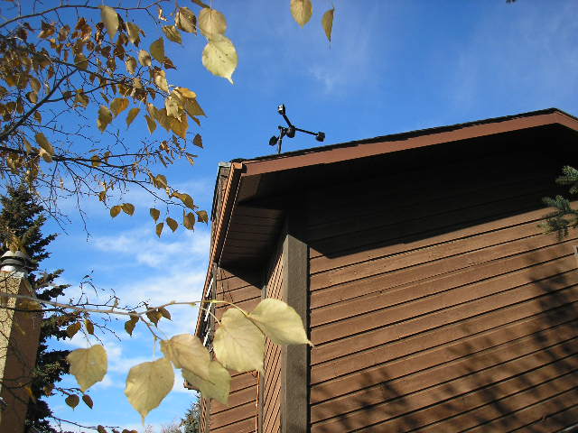

On the chimney top is my experimental mill.

You've certainly made a good start. I would be keen to see your furling system on your wind generator. Is it of the standard 'gravity' method?

That pvc pole will not take much abuse but I've had good luck setting them in a square concrete pad and filling with small aggregate concrete use some Emt conduit and 1/2 rebar inside You may have to up the size of your pipe to 4" . Works good though I guy it for safety as well but it's very rigid.
