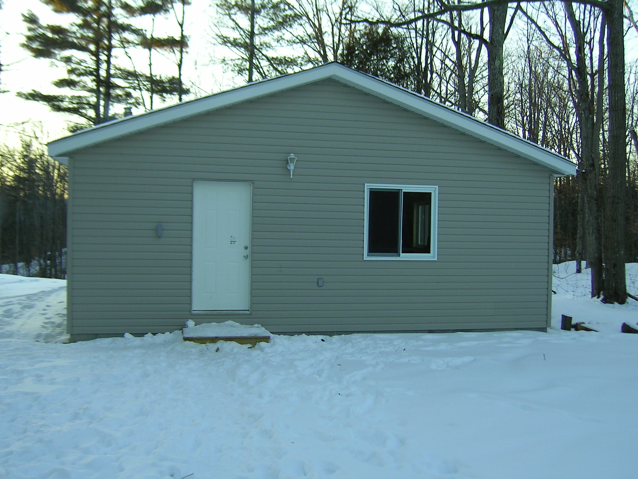

  I'll just ask the question first before my long story :   Other than the pain of getting batteries up there, CAN I keep my battery bank in the attic ?  I'm not worried about them getting wet, but the house is in Ontario and winters are VERY cold and the house is  heated with wood. (the house does cool down quite a bit while gone to work) Will the cold cold winters ruin the batteries somehow ??? (I'm picturing all the people who can't start their cars after a ridiculously cold night and need to be boosted)  We'll be starting with 4 batteries and over time probably end up with 12.
I'm preparing to do my first "alternative power" install ever.  I've been reading for weeks on end.  (I do have a technical background)  My sister is living in a brand new, tiny, 500sq foot "house" in the middle of nowhere in Ontario.  Obviously, there's no electricity or plumbing and she's been there over a year now.  I have made it my mission to get electricity to her.

Looking at the photo, I would be tempted to build an insulated wooden box just outside.  It shoud be a cinch to route the cables through the frame walls.  Rich

Build a super insulated box put it outside against the house and drill a 2 inch hole low in the box for intake air to come in from inside the house (thru the wall) put a elbow and pipe it up a bit toward the ceiling to get warmer air. Then vent the box at the top for the gassing. Put a light flap in the gas exhaust to keep the cold air from reversing. That is the way mine is and it works fine. I am at 8500 ft in the Rockies.....erne

Thanks Guys.  I have decided to build an insulted box on the outside of the house and route the wires through.  (I'm a cable guy, so I can do that part easily). Just for the sake of sharing :  I have decided to buy a kit from costco, 3 X 80watt, 12volt,  Solar Panels with mounting brackets and Charge Controller ($1750 Canadian + tax) with 4 X T-105's (6v 220ah) brand new @ $150 each. (Always Canadian)    This sound ok ??? I've been looking for deals from Canadian suppliers but having trouble.
