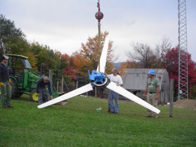

I recently made my 17' which was fashioned around the one that you guys built.  The weight of each laminated sassafras blade came to 19lbs each!
In order to make the blades even stronger I put a layer of 6oz fiberglass cloth around the entire blade.  In addition at the leading edges I used a material called Dynel under the glass cloth as it is extremely wear resistant.
By wrapping the blades with glass and squeeging off any excess I only added 1lb to each blade.  And made them super strong as a result, I would highly recommend this to any large blade.

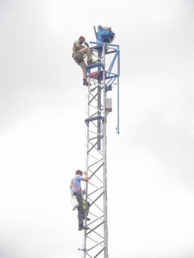

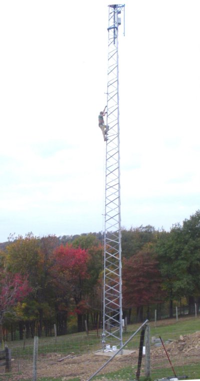

We just got my 70' lattice tower up along with the yaw bearing yesterday but due to the wind and rain did not get the blades and tail on it yet...
Here are a couple of photos:
Hopefully the rest will be flying soon!

 looks like there is no guy wires on that tower. Is that tower going to handle the loads of the turbine? Does it sway at the top? Your project looks good. I would enjoy seeing more pictures of it and reading about it in a diary.
