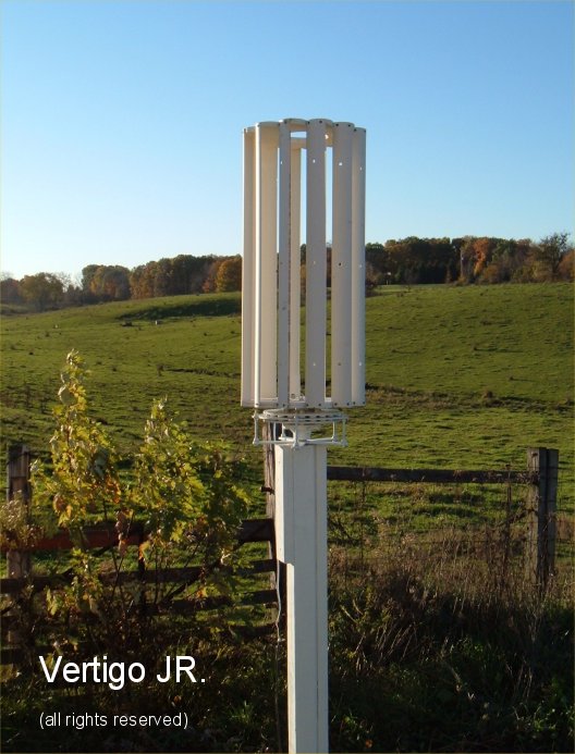

Hello guys.
I finally (!!!) got my first 3-phase stator done and it is in the Vawt windmill, but I am having problem (I think) with hooking up the bridge rectifiers.
I suspect the bridge rectifiers polarity 'markings' are incorrect. I got them from the SurplusCenter catalog. In their picture on the internet their picture is opposite from the ones they sent me. It is also missing most of the markings. Only a positive (+) shows on one corner. So I keep trying it different ways but the DC voltage don't seem high enough after the 2 rectifiers. I hooked them up like Danb's 3-phase hook-up page showed.
So my question is, If the voltage is 8 volts AC between any two wires from the 3-phases (the 3 wires), then what should the total DC voltage be after the rectifiers?
It does around 8 DC volts after rectifiers, at about 60 rpm. I can't find the answer. I thought it would be higher after the rectifiers. The AC voltage is the same for each of the 3 phases.  I was hoping for 12 volts (cut-in) around 60-70 rpm for my New Vawt. It reaches 12 DC volts at about 120rpm.
I just got the thing up a couple hours ago, and there was (of course) ZERO wind. So I didn't have much time to try all different combinations. I had to turn it by hand.
EACH of the 3 phases shows the same 8 AC volts at 60 rpm.
There is going to only be 5-10mph breezes tomorrow,,but maybe I'll figure it out.
Would appreciate any help.

Re: Basic 3 - Phase Stator question (3.00 / 0) (#7)
by CmeBREW on Mon Oct 29, 2007 at 08:25:41 AM MST
Thanks much,,,I will try those things today. They upped the wind forecast to 10-15mph.
The stator is in STAR and I had encased the other 3 points within the polyester since I knew I would not need them for Delta. The 3 wires are 18 ga. wire and the coil(s) wire is 20 ga. wire by 80 turns ea.(I am not that good yet at winding)
The stator is 1/4" thick.(maybe a hair more toward the center)
So by what Flux said, I assume it is 1.4 multiplied by the AC voltage of each (or;one) phase, is the total expected output. I see now. I hope I didn't get a bad rectifier!  I have 6 - 6amp diodes to try like DAnB showed if I have to.
11 volts at 60-70 rpm would be very acceptable considering I had to open the gap more because the steel mag discs are not running perfectly true. One is a 1/16" off up and down, and the other one is another 1/16" off! - Thats an  1/8 of an inch more on the gap than expected.(Total gap about 3/8")
The mags are 1" dia. by 1/4" thick, N42.
The mill is VERY hard to turn when all 3 wires are shorted. What a magnetic brake!
Thanks for the help. Now I know something must be wrongly hooked.

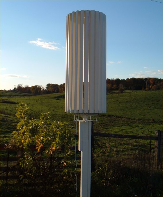

Re: Basic 3 - Phase Stator question (3.00 / 0) (#8)
by CmeBREW on Mon Oct 29, 2007 at 08:34:56 AM MST
I forgot this. Heres a picture of it now. Today I might get to see what WATTS this thing will do (if any!) in a 15mph wind!!

Re: Basic 3 - Phase Stator question (3.00 / 0) (#14)
by CmeBREW on Mon Oct 29, 2007 at 02:33:27 PM MST
Well... Its not looking too good at this point. The alternator I made is not matched well enough to the EXTREMELY LOW rpm of this VAWT wind rotor.
I also realize that my RPM estimates were off. I put a big piece of duct tape on one of the blades and using my stop watch in hand, I can can see now it goes slower rpm than I had previously though. In the VIDEO I had made on YOutube, I now believe it was only going about 100rpm, NOT anywhere near 200rpm!
The RPM range of the alternator is simply way too high for this Vawt rotor.
So this alternator would certainly make a nice low-wind HAWT mill, since it would easily go up past 300rpm. The 12volt 'cut-in' IS about 70rpm.  However, the VAWT rotor rarely goes above 100 rpm.(on a so-called, 10-15mph wind day)
It goes about 100rpm at a 12-15mph wind.  Therefore, it only did 5 stinkin watts or so, at 100rpm.  I could spin it faster with my hand (around 150rpm or so) and it went up close to 20 watts. I expect it will at least make 20 watts in a bigger wind--but the rpm is still very limited and slow.
I did expect more. My very first 3-phase stator WAS a real pain it the A$#^#beep to make. It is NOT one of my favorite things.
I may make a smaller diameter vawt rotor (18" diam by 5 ft. high) to get the speed up.(even though the over-all power will be cut in half)
Or, I can try this 'voltage doubler' circuit that Tecker and Damon mentioned. However, I see a transformer in there , and this is 3-phase, not one. It doesn't make much sense to me.   The Vawt rotor has been turning 60-100rpm for most of the day and with some good torque. But as of yet, I cannot tap into that low rpm range!!!!  Forget gearing--  I am quite certain it looses about HALF the power potential. Thats why I attempted direct alternator drive.
-I will keep trying. Any more suggestions or circuits are most welcome.  -Thanks.

Re: Basic 3 - Phase Stator question (3.00 / 0) (#20)
by CmeBREW on Mon Oct 29, 2007 at 05:51:18 PM MST
Thanks guys.
Well I do have a few things to try. Probably making the small diameter rotor is my best bet right now. Second is to make another stator with even smaller ga. (24ga) wire. Now, I see that I would rather have 'cut-in' at 30rpm or even 20rpm if possible.
Stacking 40 more magnets just isn't feasible I'm afraid. There is almost 1/16" epoxy over the mags now. I was afraid this could happen because I (in the beginning) had purchased too small of magnets! I am ONLY going to buy 1/2" thick magnets from now on, to compensate for my poorly wrapped coils AND my crooked steel magnet discs. If those 40 magnets on my mag rotors had been 1/2" thick, everything would have worked WAY better I think.
Concerning those basic Voltage doubler circuits, I DO have 3 big AC (big MFd) 'runnning' capacitors and several 6amp diodes, so I may try to see what happens making one of those circuits.  I'm not so sure about the series "Jerry rigged" circuit WOOF showed. The 3 are out of phase, so I'm not sure if that would work. I quess that would take BIG capacitors also. Unfortunetly, I buried the other 3 wires in plastic.
Making the smaller Diametor rotor will not take long at all. First, i will mount the Prototype small rotor on the alternator and see what happens. The hub turns real easy since I cut out the rubber seal on the bottom.
If I get any better results, I will post them here.
Feel free to comment more if you think of anything at all.

Re: Basic 3 - Phase Stator question (3.00 / 0) (#28)
by CmeBREW on Tue Oct 30, 2007 at 04:03:32 PM MST
Thanks Flux.  I'm trying to stay away from electonics for now. I just don't have time to study it right now--but I will over the winter.  However,I think I found an easier way.
To everyone,
Thanks for your vote of confidence!
I have some good news. I just put Vertigo JR. rotor on that alternator , and as I suspected, it is doing WAY better now. But there are only tiny breezes right now.
However, It is actually charging 1-5 watts in very tiny breezes! (under 10 I believe)
As I had said before, the big rotor was MISMATCHED for that alternator.
This small 18 inch diameter rotor goes much faster rpm. Probably twice as fast.
The separation of the blades could also have something to do with it.
I now believe its easier to make the difficult alternator FIRST (as low rpm as you can), and THEN try to match a rotor to it. I am understanding more now.
Tomorrow is forecast for some GIANT winds. The biggest in a long time. The weather channel for my area says; 25-35mph with possible gusts up to 50mph!
Its going to be like a moderate hurricane!  So I will get to see what this little baby can do!!
I got a strong feeling is going to be VERY good.
I will put it in my DIARY if everything goes as I believe it will. (easier to find that way)     -Thanks folks.

Re: Basic 3 - Phase Stator question (3.00 / 0) (#35)
by CmeBREW on Wed Oct 31, 2007 at 03:49:39 PM MST
I wish I had good news. That tiny vawt rotor is smaller surface area than a 3 foot hawt. I'm sure most everyone here already knew what was going to happen.  STALL,STALL, and terrible STALL!
I just thought it would stall alittle later though. I was wrong.
It does alot of 'trickle charge' (.5 - 5 watts) upto 100rpm, but in the big winds it's like hitting a brick wall around 100-120rpm.  It usually stalls at only 6 watts(.5amp) even in a 20mph wind.
 I could disconnect one of the phase wires and it would go up to about 12 watts before stall. But then you miss the 'trickle charges' keeping that way.
Or, I could disconnect all and let it free spin faster and then hook up ammeter quick and it would briefly show 30 watts or so. (Which is cheating by the way)
There were even upto 30mph gusts today.
I hate to say this, but I am beginning to believe there is not much power in these basic drag pvc vawt rotors like I just made. I was just experimenting. At least I tell the TRUTH. I will keep messing around with it though. It is discouraging though. I will try to contain my hopeful 'speculations' more, from now on.
Since they are now outlawing small windmills in many,many counties everywhere,(more than ever now)  I was just hoping to make something less noticable, even if it does only do a fraction of the power a HAWT does.(I wanted to put up several)
  But designing and making something new and matching a generator to it is extremely difficult and (will be) alot of work to actually make one that usefully works.
Finsawyer:  I think stators like you're talking about (or similar) have been done before, (overlapping coils, electronic switching between sets of 3-phase coils,etc.) but,,, it is simply over my abilities to make at this time. I had a heck of a time with the basic one i just made . (and I am very glad that it works!)  I had alot of cross-overs and alot of air in the coils. Plus, the exact spacing of my coils is FAR from perfect.  I will keep it in mind If I ever get the skill to believe I could make something like that. Besides, for me, cut-in is not the problem anymore. I can get 30rpm cut-in now.  Yes, its the WHOLE thing is the problem now!  -Thanks.

Re: Basic 3 - Phase Stator question (3.00 / 0) (#39)
by CmeBREW on Thu Nov 01, 2007 at 07:54:05 AM MST
I quess I was overly dissappointed last night. Sorry about that. Yes, I went to the OTHER extreme by putting that tiny vawt rotor on that strong alternater--which is obviously big time STALL.
It stalls QUICK too. I can turn the alternator by hand (no rotor on), and I had no idea it requires such extreme Torque (from my arm) just to make 25 watts at about 150rpm. It would probably make a nice 100watt Pedgen. This alternator sure wants to raise the AMPS FAST after about 100 rpm. It may do 100watts at only 200rpm!! But the TORQUE required would be INSAIN. Now I fully understand the need for speed. To keep cutting the torque requirements in half. I wonder if everyone else has such a hard time getting 25 watts turning their alternator by hand?
Ghurd is right. I will go buy some more 1/2" washers and open the gap some. He and others are also right about the big rotor being 'flimsy' especially in bigger winds.
I will work on stabilizing them with a band or another disc in the middle hopefully this weekend.
Maybe I can get something out of it yet.
