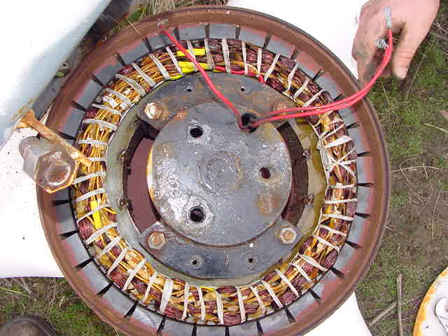

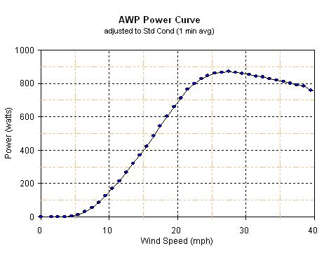

While I am in agreement with nearly everything you have said, this statement has me puzzled
"I hope you haven't falling into the trap of thinking that if you double the volts you can increase the power out for the same magnets and copper, that just doesn't work."
I don't have the experience you have (most don't), but our experience with the AWP is different.
The 24v version has a max output into batteries of only 900w The 240v version with the same magnets, and the same iron core but different windings (same fill I expect) puts out around 1.5kw. (currently for the last 2 weeks, 1.5kw 24/7... windy as hell here ... and even windier up the mountain where the mill is).
Considering the transformer loss in the HV version as well, thats a considerable improvement for nothing but a voltage increase and a transformer.
Is there something I have missed here?
Is it just stator loss for the 24v version or something else more sinister.
......oztules

Re: Blade Extenders and 3 phase transformers (3.00 / 0) (#5)
by oztules on Thu Oct 04, 2007 at 10:24:34 PM MST
Thanks for that ULR.
I follow your argument, and find it difficult to find a flaw in it. In this case the device is this:
So no room to change gap, only wire thickness and count. The prop is the same, the 30 feeble ceramic magnets are the same, the stator core is the same, and still here is the graph of the 24v AWP direct to batteries power curve:
The unit we have is the 240v transformer version, and as you can see there is not much room to modify anything other than wire thickness and turns.
So although I see your theory, something else must be at work here which I can't figure. We get 1.5kw a lot of the time. (the site is 1000 feet above the surrounding countryside it's windy there when it is still elsewhere)
Current is measured in two places and KWH is done by the $9000 odd dollar inverter / system manager (8000w max). So I have complete faith in the figures it gives and the independent ones from the AWP  controller.
I notice that the grid tied version also does 1.5kw... also a high voltage version (probably the same one but grid tied to a windyboy with crowbar clamping to stop overvoltage).
Hopefully an old hand with experience with iron cored machines will know why the huge difference. The mill and alt are designed by Hugh Piggott I think.
Still a mystery for me
Re: Blade Extenders and 3 phase transformers (3.00 / 0) (#6)
by Flux on Fri Oct 05, 2007 at 01:55:53 AM MST
For the air gap machine that dynaman was discussing, there should be no real difference between his two windings, the 2 in hand at 75 turns should directly equal the 150 turns single strand.
If there was no line resistance the 24v one should perform the same as the 48v version.
If there is significant line resistance then the 48v version will behave differently. What actually happens depends on how the prop is matched. If well stalled in the 48v case the 24v one may perform better with the same cables. If the 24v one is above stall then the 48v one may may manage to capture some of the power lost in the line and do better as long as it doesn't stall.
It is not easy to capture much of this line loss unless it is really excessive.
The 2:1 voltage difference will not make a spectacular difference to the power lost in a given cable and the included transformer loss may more than offset any gain.
Now if you seriously raise the voltage ( not just double it) then the line loss becomes negligible for the high voltage machine and you can ignore it. On a short run with heavy cables the low voltage machine could have a chance of beating the hv one unless the transformer was big and efficient. On a long cable run the transformer would win as the cable cost for low voltage would make it impractical.
Now to deal with Oztules question we have to start moving into unproven territory to try and puzzle out why the high voltage AWP does better than its low voltage version.
You are right that this is the case and we are forced to accept that it is just not caused by line loss, although the low voltage version will need very expensive cable and will not be able to be used far from the batteries, the line loss can be kept to within reason and still there is a difference.
The grid tie version should indeed be able to beat a battery charger version as the inverter should be able to track the peak power point far better.
Now why the difference between the high voltage and the low voltage version?
We are into the realms of speculation here, I don't have enough direct evidence to prove any of this, but this is my theory for what it's worth.
The AWP alternator has low flux density from the ceramic magnets and needs lots of turns to produce the volts. All slotted iron cored machines have a higher leakage reactance than the axial air gap machines and under certain circumstances the reactance component dominates and determines the output rather than the resistance.
The large number of turns on this machine and the long core teeth makes me think that reactance is starting to come into the region of approaching the resistance at the top end of the working range. I suspect that on a bench test the curve is turning over somewhere about half load and not rising linearly as for the air gap machine. the result is that the blades run clear of stall in the higher winds and line resistance is not so great a factor as for the air gap alternator.
This almost certainly gives the AWP a better match to the prop at full load than the air gap machine without having to resort to line resistance to prevent stall. For this reason the difference between grid tie and direct battery charging may not be as marked as for an air gap machine.
So far so good, but now why does the hv version of the AWP behave differently from its lv version. Now this is real guesswork but I think it must have something to do with the deep slots and the way the low version is connected. Coils buried at the bottom of the slots will see far higer leakage than the coils near the air gap an I suspect that all the windings connected in parallel for the low voltage version don't share current equally and the reactance ( and probably effective resistance) is greater on the low voltage machine. Now add its additional loss from less ideal leads then you may have your answer.
Unless someone is in a position to do a bench load test on the two versions of the alternator and compare like for like then this must just stay a theory but it is the only answer I can come up with.
