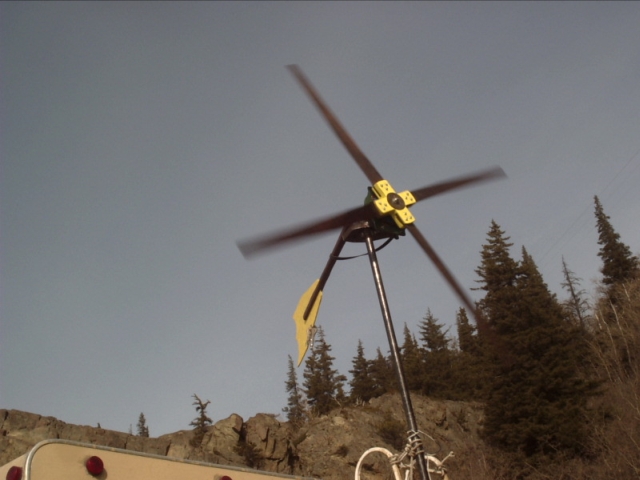

heres my motorhome mill-all wood[sawblade rotors][ceramic mags with neoes on top] -its survived 45-55mph winds so far-furls right up- not sure of the weight cant be much over 25-35 pounds--lights up 4 50w headlights in a good wind..its a 9 and 12 setup-with all six wires down the pole-for star or jerry rig...
WILD IN ALASKA
Re: The light weight question (3.00 / 0) (#3)
by hiker on Thu Oct 04, 2007 at 09:26:12 PM MST
                heres a earlery version of the mill with longer blades
                and a diffrant base mount...mounted to back of motorhome
WILD IN ALASKA

Yes but is that wind at that level or do you put it up in the sky?
jmk
