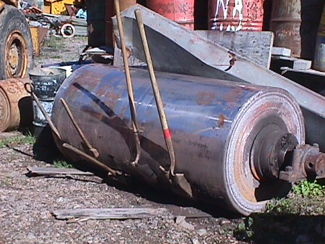

Turning the magnets and coils "sideways" so their long sides are parallel to the rotor rim would require a larger rotor to fit everything in.  But presumably you would still have the same time for a coil to go from being centered on one magnet to the next.  So, the average voltage would be the same if the change in magnetic flux is the same.  But it need not be.  When the magnets are sideways the channel for the magnetic flux is about 1/2 of that for the normal case.  This would mean a higher reluctance in those paths and possibly less flux.  Still, your results would seem to indicate that it didn't make any substantial difference.  Am I interpreting your comments correctly?
Note to Admin:  I guess you people have no sense of humor.  You try to set up a sight gag and you squash it.  Wonderful!  And how much bandwidth did it take anyway, for a picture (worth a thousand words) and a few words.  Bah, Humbug!
GeoM

by TomW on Wed Oct 17, 2007 at 09:48:33 AM MST
Well, excuse me, did you ever notice the Diaries section? That is where that off the wall stuff belongs, in case you still don't "get" it.
I know you are a legend in your own mind, but you cannot blame me for your obvious lack of understanding of how things work here.
Now, when you get your alt built, be sure and post pictures of that under "Wind", however.

by finnsawyer on Thu Oct 18, 2007 at 08:49:22 AM MST
It's funny isn't it.  You tell me to put it in a diary as though that would make everything right, but the proposed alternator design is in a diary and I get raked over the coals anyway.  There seems to be an inconsistency in your thinking.
As far as the drum is concerned, it is from a magnetic separator and contains powerful magnets on the inner drum.  We don't know currently what the shape of the magnets would be or whether they are removable.  If you encounter such a drum somewhere it might pay to check it out.  Here's the banned picture.  The end plates are (theoretically) removable.
GeoM
