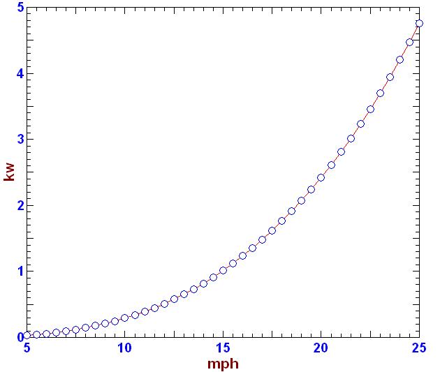

We have a number (500?) of 46x30x10mm, grade N40 (supposedly) neodymium magnets that we are using for 500W, Hugh Piggot-style wind turbines.  I am building a 4m, 3-bladed prototype and am looking for some advice on the design of the alternator.  Thanks very much to Steven Fahey for putting together "Basic Principles of the Homemade Axial Flux Alternator".  The blades were designed using PROPID, and according to that program the blades should produce the following power curve.

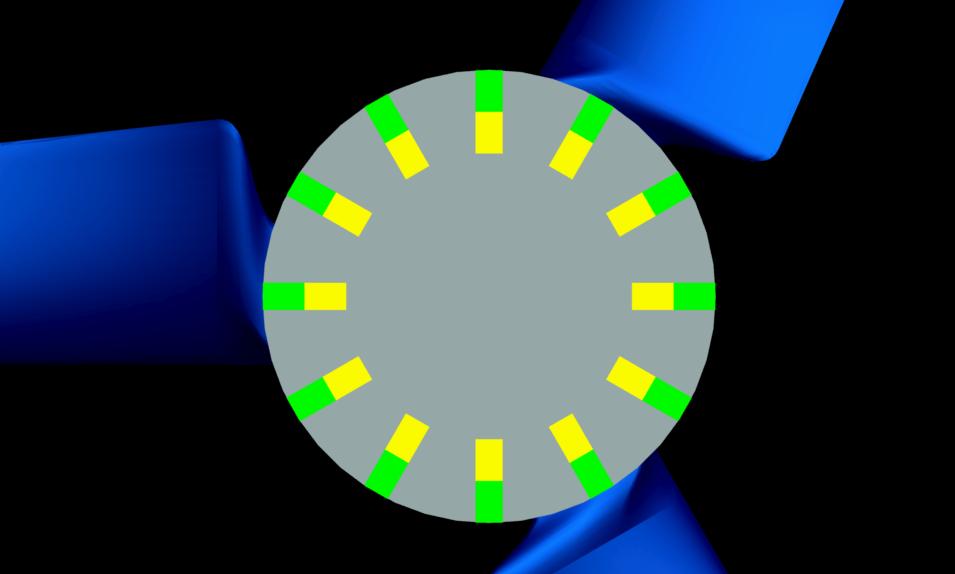

The magnet rotor diameter will be around 500mm.  Hopefully I can design it so that it is producing high voltage (200+), 3-phase ac.  I am wondering if I can put an inner ring of magnets to increase the magnetic flux and thus match the power curve of the blades more appropriately (i am aware that some may feel i am doing things backwards).  This way, using 12 stations might produce a rotor like this:

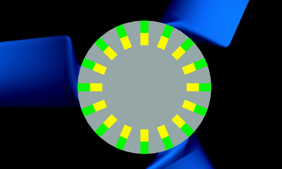

or with 16 magnet stations:
Am I correct in thinking that using more magnets, and thus more coils (like the 16 station version) would be better because there would be less resistance in each coil? Or can I go with 12, reduce the cost a little, and just put more windings on each coil? Should there be a gap between the outer and inner row of magnets for this to work?  Or should i just order larger magnets?

Hi Flux, thanks for the response.  Those values are calculated at a tip speed ratio of 6.5.  Here is a chart for wind speed vs rpm:

When properly matched 16 pole with single magnets should manage that with reasonable efficiency up to near 2kW perhaps even more. The more magnets and copper you through at it the higher the efficiency and the lower the stator heating, so the higher wind speed you can go to before furling.
I would have been tempted to try 20 poles of single magnets rather than double up on the magnets. You make better use of the magnets by increasing the pole number with decent spacing rather than using very long thin magnets that are too widely spaced at the outside and crowded at the centre.

When the rotor advances the magnets from being over one coil to the next the change in flux will be the same for the two cases.  With the 16 magnet layout the time it takes at a given RPM will be 3/4 as long.  This would translate into 1/3 more average voltage per coil if the coils had the same number of turns in the two cases.  Also, there will be 1/3 more coils.  This would result in 16/9 times the voltage per phase if the number of turns didn't change.  Of course the coils won't have the same number of turns as the spacing gets smaller.  Or will they?  It's up to you.  Reducing the wire size increases the resistance per unit length of wire, but reducing the coil size has a strong effect on the total amount of copper used per coil and hence the resistance per coil since both are proportional to the area of the coil minus the area of the central hole.  If you know the wire size and area of the coils for the 12 magnet 9 coil case you should be able to predict the effect of different coil sizes and wire sizes in the 16 magnet 12 coil case.
In looking at your numbers it appears your diagrams are not to scale, that you could go to 24 magnets with 18 coils (1.8" x 1.2" magnets doubled on a 20" diameter rotor).  Your aspect ratio is rather severe (3 to 1), but with the 20 inch rotor you should do ok.  Of course, you are showing the magnets right to the edge of the rotor, which would have the coils extending past the stator rim.  You need to sit down and do some analysis of your own.

I never checked whether the things were to scale. You could go up to 24 magnets on a 500mm disc if you want to. I would certainly do that rather than stacking 2 magnets in line.
24 poles would give more alternator capacity than you need without doubling up on magnets.

With a single row of magnets he frees up more space, enough so that it looks like he could go to 28 magnets with 2.4 inch wide coils (0.6 inch wide coil legs) or very nearly so.  Doubling the magnets doesn't look like that good an idea.

you all are absolutely right.  24 (or as you say maybe even 28) would work as a single ring.  i was going to post that last night, but our internet got cut off (as it does at 11pm every night).  i think i was hoping to get away with a fewer number of coils.  anyway, today i found out i'd have to order a new batch of magnets for this alternator and can specify any dimension i want.  i'd like to decrease the magnet rotor diameter and use fewer, larger magnets.  maybe 16 of 60x40x15mm on one of the magnet rotors that would now be 400mm rather than 500mm.
