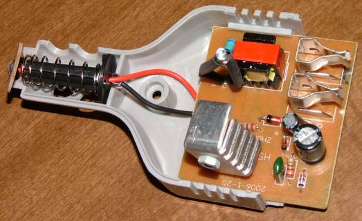

by vtpeaknik on Tue Dec 11, 2007 at 11:26:18 AM MST
Well I got hold of a couple of these cheap mini-inverters, supposedly rated at 40 watts, and found out that:
  • there isn't much inside, see photos below
  • it ran a 4W night-light bulb rather dimly
  • after 2 hours of that the heat sink on the power transistor got quite hot
  • it could not start up a 15W CFL - brief flash, then only an audible whine.
