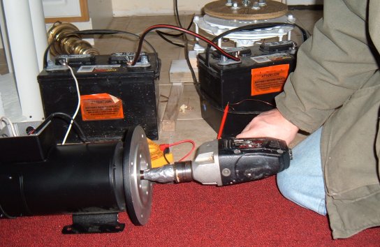

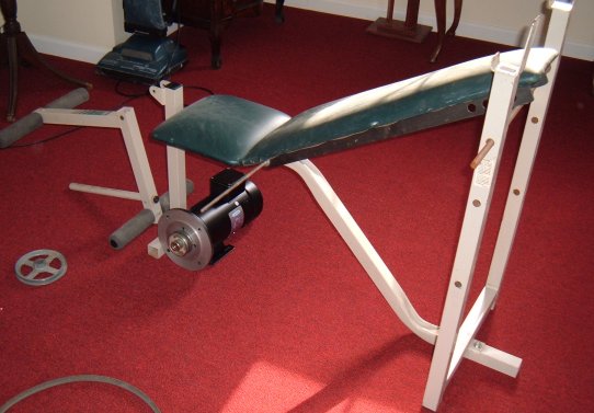

I'm making a comfortable, relaxed pedal generator with one of these motors right now.
As you can see, I just duct taped my slow rpm drill to it to see what it will do into a 12 volt battery and 24volt battery bank. I did not have an 3/4" arbor.
Notice that even though the shaft is 19mm,  all of my 3/4" pulleys fit perfectly over it. 19mm is just a half a hair bigger than 3/4".
Anyway during my tests, the duct tape would break at 5 amps into the 12volt battery.(65watts/ at about 280rpm/ guessing)
This is GOOD. Means it would do ALOT more watts as it goes faster.
It was not bearing down too bad on the drill either.
OPEN VOLTAGE of the generator was 61 volts DC at about 550rpm-600rpm. (this is the maximum rpm on my drill's rating label)
Hooked up to 24volts of batts it did 110 watts at about 500rpm which was the maximum for the drill. I believe then, that 24 battery volts is too high for this motor as a generator. But it was quite easy on the drill.
So this motor would be best for a 12 volt battery system I think. It might do over 200watts. It does have some cogging though--but no problem for a bigger prop.

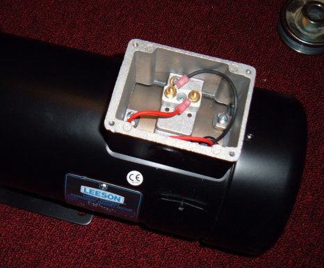

The two wires in the connection box look to be only about 18ga wires.
However you can easily put two bigger gauge wires in there place if you wish to.

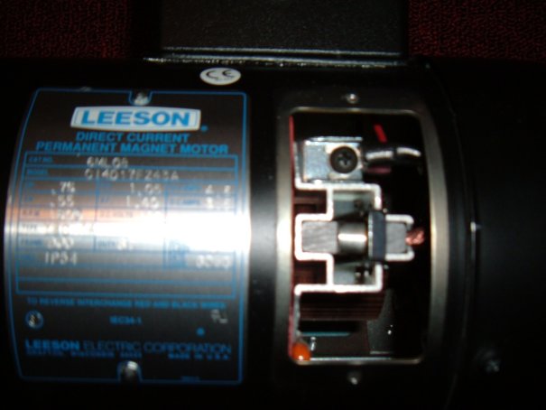

Even though this motor is 'rated' for 4.5amps , there are 4 really big brushes in it and an 8 gauge BIG WIRE that comes from the brushes to screw terminals where the two smaller gauge wires hook up to. These brushes are TWICE as big as any treadmill motor brushes I have ever seen.
The brushes are EASY to replace from the outside.

I've been using a treadmill motor wind mill rated for only 5 amps (@12vdc) , and It goes over 10amps quite often. It has even went over 14amps briefly many times--and the brushes show little wear in a year. The brushes on this new motor are TWICE as big.  The brushes on this new motor are bigger than some treadmill motor brushes rated at 18A.  Of course, everyone has to use there own judgement when using a motor as a generator. But I have had good experiences so far.
"The ultimate instantaneous current limit will be when the armature reaction demagnetises the magnets."
I wish I understood this statement. The armature never even touches the ceremic magnets--and it disipates heat thru the aluminum body?? I don't see how it can demagnetise.
I thought about the 24 volt system. But I suspect the cogging may be too much for only a 6 ft. 3 blade prop. I could be wrong. I was even thinking of 6 pvc blades to get over cogging to use as a 24volt system as you say to cut amps in half.
If I make a 7' mill out of it-- I was going to risk upto 15 amps at 12volt and furl.
I think it will be fine--like my smaller mill.

The current flowing in the armature of that motor will also produce a field and this will react with the main field of the magnets. There is a demagnetising component that depends a lot on the position of the brushes and under the worst conditions the field is sufficiently demagnetising to weaken the magnets. Heat will not bother ceramic magnets, the winding will fry long before that. If the magnets are neo then then armature reaction is unlikely to be sufficient to do any damage, but they could be subject to heat damage.

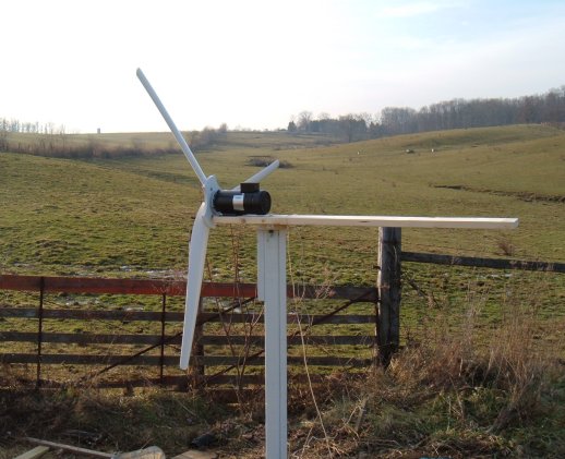

Today I have been testing the NEW motor (cut-in about 135rpm) with 7' diameter PVC blades and it is doing VERY WELL in low winds! I meant to make only 6' diam. blades , but it wound up being 7'.
I made the blades like Ben's at "Gotwind.org".  I made only 3 blades and it gets over the cogging of the motor very easily. It starts turning in the smallest breeze.  I will show pictures soon. Tonight and Tomorrow are 50mph+ winds though. I don't have any furling on it yet, so I have to tie it down.  I got more testing to do to quess the Watts better in low and medium winds.

Yes, I was somewhat pleased with my initial results and how easy the blades get over the cogging of this motor in 5mph tiny breezes and they were initially spinning almost all the time at 100-120rpm or so in the breezes. But I had not tested the power yet at that time. I still need to make many adjustments to the blades to get them FASTER rpm in low winds. Thats what I'm striving for.
 Heres a picture of my initial testing with the pvc blades at a steep angle:
I am doing all kinds of basic testings. Of course there is no furling yet- I am just pointing it into the wind for now. The motor is exactly what I wanted with 12v cut-in at only about 135rpm.  Each Pvc blade only weighs 1.5 lbs. (a very light 7' diameter prop)
The blade angle at the tip was 10 degrees which is too much. I believe the blades were stalled since the blades were beyond 12 degree angle just a couple inches from the tip. I am just trying many different things to learn.
I actually was hoping the blades would TWIST back automatically to better angles in the winds. Didn't happen though. So I will put rubber under them and bring the angle down more and more with testing to hopefully get them into lift and more speed.
Even with the blades at wrong angles, the mill still gave me about 140 watthour during a faily windy day to watch an hour of TV.(140watt TV)  Not much, but I can only go up from here with better angles!

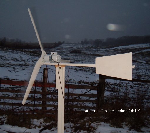

I am excited about the results I just got tonight:
I made this in only 6 hours. (not including setting post)
I am still going to put furling on it though. The straight tail is just for testing.
This mill has almost 3 times the swept area of a 4' small mill.
Can't go wrong with more swept area!
The winds are lower now at about 10-15 (quess) and it is doing Alot of 1 to 3 amps into the battery. I can approx the watthours better tomorrow.
I love this WAY better than my 4' treadmill motor windmill already! I am certain of that.

If you are aiming standing behind it, a tail will sure make the output rise, after you get out of the way.  Much more than I expected it would.
You are slowing down the 40.4% (100% - Betz) that must get past the blades.

        I was really not standing right behind it when I was testing it. I just aimed it into the wind and went inside my door 30 ft away to measure amps into a 12v battery.
I hate to confess that I was actually only using a tiny 20 ga. speaker wire (30ft long) when I did the initial testing. I forgot to buy my 8ga bigger wire when I went to the store last week. I couldn't find anything bigger for the testing! I will get decent size wire real soon.
I did get a max of 3.5amps in a fairly big wind gust though. (guess 25mph) Mostly just 1 and 2 amps. With the much bigger wire I hope it will do more this weekend --and when I improve the blades for less drag and more lift. The blades never did spin out of control though-- showing just how bad they must have been with the first mounting attempt.  It was more just an experiment.  I can only improve from here I think.

I finally got some time after work to do more testing with my drill and even stronger duct tape and a bolt--and now I can see that this motor as a generator would not efficiently go upto 200 watts into a 12 volt battery bank as I had hoped. To the best of my guessing rpm with my drill, this motor looks like it does the following into a 12v battery:
-50 watts at around 200rpm
-70 watts at around 300rpm
-84 watts at around 400rpm
-100 watts at around 500rpm
Looks like it starts becoming very inefficient soon after this point.
Into a 24volt battery bank, it does about 110watts at around 500rpm. But the watts would go up somewhat more at 600rpm into the 24v batts I believe.
So it seems to me now that I wouldn't ever want to go much above 7 amps. (at 14v charging battery= 98watts or so)
You were right about the amps,, I got greedy.

After thinking about it more - I think a 7' prop would be TOO much for that (about) 3/4" shaft on that motor.(as Flux said)
  I believe i'm going to try the 6' prop with probably 5 or 6 blades to get over the cogging in 5-8 mph breezes.
I think it will be difficult enough to control even with a 6' prop since it would practically be in a 'free-spin' anyway at under only 100watts max. I'm certainly no expert- but thats what concerns me most. It would be a very interesting challenge though to control it.
I do not encourage anyone to try a 7' prop on that motor. I suspect without special safety mechanisms it could be in danger of losing control when VERY BIG winds (+50mph) come around even while fully furled and 'shorted' thru 1 ohm heating elements. These insainly strong winds are happening more and more now I've noticed.
If the motor shaft was 1" I would probably try it--but definitely ONLY with an automatic emergency brake of some sort because it would practically be in a 'free-spin' condition all the time. My plan was to shut it completely down when bigger winds come around. I'm not so sure that would be good enough now.

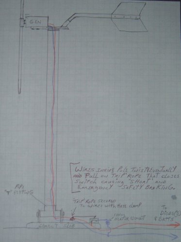

 I've been trying to think up a safety mechanism in case the furling gets held back during high winds due to the wires in the mounting pole reaching maximum 'twist' without me being aware of it. That is not so easy.
If the wires at the bottom of the pole could 'unplug' ITSELF at 'maximum wire twist' in order to ALLOW the furling system to keep working correctly AND at the same time trip a big relay that would 'short' the generator into the 'shut-down' heating elements automatically??? I'm not sure of the design yet. I will keep working on it.
One thing I am certain of though, it IS a fun motor to play with and WILL make a very nice pedal generator --with only one single gearing --instead of having to do two separate 'gearings'as most require. Should mean more watts for the efforts since there is less frictional losses. I'm not going for the 5 minite 100watts super workout though--because I would never use it! I'm going for the EASY , lazy, comfortable 30-60watts consistently WHILE I watch a movie each night. I will post it when I get it done.

Yes, I WISH I had had the time to throw a 6' prop on it and see what it REALLY does in a wind. But I didnt have the extra time before the auction ended -- but the 'numbers' looked very promising.
 I only get the weekends to do a few things. I will get a 6' prop on it and see what it does- and then we can have a better idea if it is worth it.
Obviously there are many reasons that an PM ALTERNATOR is MUCH better since one doesn't have to contend with any cogging or ever worry about brushes. However, if this works good, this could be a good alternative to those small 4' Ametek generators. I'm not sure yet. I think its worth trying to find something better.
I will soon see how these type motors will perform. I am concerned about controlling it in mega winds though. (even with early furling)
Today we are again getting over 50mph wind gusts. (and tonight too)
Has anyone ever tried the following for a SIMPLE SAFETY shutdown:
I'm just going to use a normal 15amp light switch in a utility box.
I want to place the hose clamp at just the right place so that the mill can still furl a couple more revolutions even AFTER the 'shorting switch' is tripped. Also need alittle piece of rope as a STOP to keep the trip rope from pulling and breaking the switch lever off.
That is the whole purpose of this-- to 'shut down' the mill BEFORE maximum twist of the wires inside the pole.
When I test this motor with a 6'prop , it will be on a short pole right at the corner of my house with alot of turbulance. It will most likely twist up the wires alot. Any attempt at extra Safety and control is good I think.
Any thoughts welcome.
Re: Nice LOW RPM Leeson DC motor/generator (3.00 / 0) (#12)
by ghurd on Sun Dec 23rd, 2007 at 03:47:30 PM MST
Might spend an extra $5 on a "Spec Grade" 20A 277VAC switch?
Lowe's, Home Depot, etc.($5.50?)
They lightly spray paint one end of the mounting tin blue or red. Can't recall what is blue and what is red.
It couldn't hurt.
Re: Nice LOW RPM Leeson DC motor/generator (3.00 / 0) (#13)
by CmeBREW (smke833f@hotmail.com) on Sun Dec 23rd, 2007 at 04:52:12 PM MST
Good idea Ghurd. I will. Since I'm only going to have a 10'or 12' pole, it might just trip more times than I would like. More amps the better.
