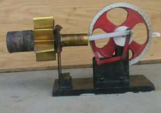

Hay Dan in the top pix is that a steam or hot air
eng Here is one i built some tim a go
OldF
Re: Early Dec - catching up on recent adventures. (3.00 / 0) (#5)
by DanB (danb@*no spam*otherpower.com) on Tue Dec 4th, 2007 at 07:00:27 PM MST
Neat looking engine you made there OldF...
The one in the top pic is a '1 horsepower Mike Brown Steam Engine'.  I plan to use it to run a makeup feedwater pump for my boiler/larger engine.
