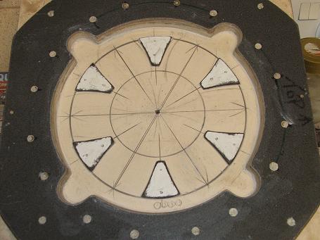

   6 foot prop made from hugh piggot plans . scaled down from 8 foot
   9 inch dia x8mm thick rotor  one off.
   8 n42 magnets  2" x1" x1/2"
   6 coils  recycled wire.
      so its a single rotor and i want it to charge 12 volt.
  i have just finished potting the rotor. in mould withh resin etc.
  a while ago i stripped a old transformer down and got the wire from it to make coils.
   i made coil winder and wound coils  .
   80 turns 15 awg.   its what it said in the book.
 but it also said to use n35 magnets.  but i got n42 as the price was much cheaper.
  i dident go with the plans . couldent aford to as n35 was more expensive.
  but to try help things out a bit i used 8mm steel disc 9".
  now for the hard bit. what i am doing is just using what i can get and what i have.
    so 2 coils each phase   3 phase. star outlet .
      so what i will hopefully have is a nice small mill charging at 12 volts and more.

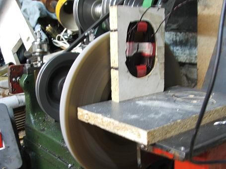

   i put the rotor in the lathe.  made up a coil holder and put a multimeter set at ac.
   first i wanted to make sure the coils worked ok.
 thay did.  so what i dont know is are thay giving to much voltage.
     to little voltage or maybe i can just make up the stator with the coils as thay are.
      coils  1   rpm 165.  1.28 ac  rpm 330  2.66  rpm 605.
             2             1.32 ac           2.70
             3             1.43              3.02
             4             1.34              2.70       4.70
             5             1.34              2.59
             6             1.46              3.09       5.50.
   all is at ac
 when i tried dc only one coil coil no 4 it gave 4.70 ac but only 4.15 dc 605 rpm.

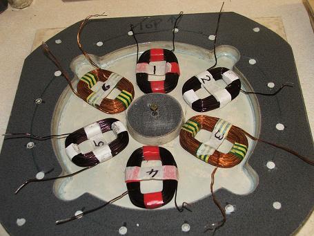

  now to try explain a bit more . four coils wound from 15 awg.
   two coils wound from 18awg two in hand. inside transformer this thinner wire was at the bottom.
   so at 330 rpm it al adds up at ac over 15 volts not spot on but im happy with my first atempt.
   the coils no 3-6 are wound from 18awg and give more power out.
  shall i take sum wire of the 18awg  so thay give the same volts as the other four.
  will less turns make less volts. for the two odd coils.
  remember i was lucky to evan get sum coils for nuthing from old trans.
   maybe i will get sum help here and can evan things out.

  looking at the above post ive put a few words on there i mean a lot for me any way.
  dont know if i am any good at trying to explain things in words.
  but as thay say a picture can say a 1.000 words  . yes kurt i know thay can also say
 a 1.000 megabite.  but i think i got this resizing thing going my way now.
   if pictures are still oversize  please say. i have a cd with photoshop but it just gets me more confused. i am better with a pair of scissers for making pics smaller
 the light colerd copper wire is the 18awg . there a bit more bulky.

by electrondady1 on Fri Dec 7th, 2007 at 08:09:23 AM MST
blue yonder,
 are the number of turns in each coil exactly the same?
what is the resistance of the two inhand coils in comparison to the single strand coils?
in order to charge a 12 volt battery it requires about 14 volts d.c.
for a three phase alternator as you are doing.
it's coil voltage x the number of coils per phase
times 1.74 = phase voltage
times 1.4 for the rectification to d.c.
minus 1.4 for the voltage drop through the rectifiers
going backwards to get the coil voltage required .
14 + 1.4 over1.4 over1.74 over two= 3.16 volts per coil
its been a while since i tried that
please  google the archives to double check the numbers.
it looks to me like you will need a whole other rotor in order to charge at 12 volts in 3phase with those coils at the rpm you are working with.
perhaps you might consider going with single phase.
that would require a coil for each magnet.
14volts minus 1.4 over1.4 over 8 = 1.37volts a.c. per coil.
Re: testing coil (3.00 / 0) (#3)
by electrondady1 on Fri Dec 7th, 2007 at 08:21:34 AM MST
sorry , i misunderstood your graph.
it looks as though you may be getting enough volts for 3 phase from the individual coils .
there may be some issues if the different coils have different turn counts and different resistance.

   i started it of with a mini brake drum . it was going onto the hugh piggot body .
 i mean the metal frame. yaw pipe and furling tail.
  but brake drum was a bit close to yaw pipe so i set it at 6". that is center of
  prop shaft to center of yaw pipe.
   so maybe that can help with furling.
  i found out the bits i had were not going to make power.
  so i started again this time looking at converting what i had to the hugh piggot 4 foot mill.
   but using n42  but just single rotor.
  the recyled coils were never ment to be used.  i just wanted the practice .
   aswell as making a coil winder.

  i forgot to say the reading i got at 605 rpm was 4.70 volts ac. then i put bridge rec
  on the two coil wires and then checked output dc. it went down to 4.15 dc..
