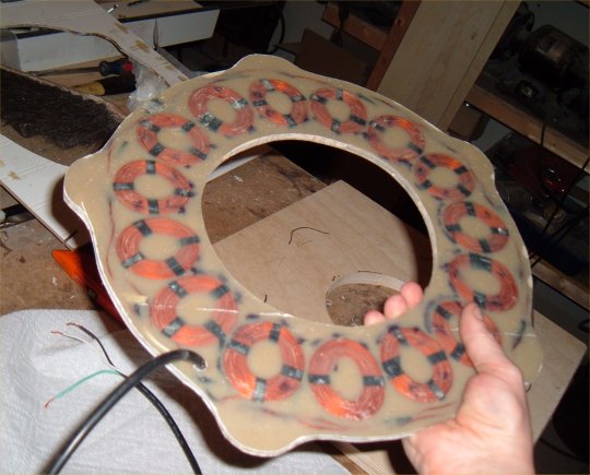

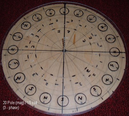

 The alternator is 3-phase 20 pole (20 mags each rotor) / 15 coils (5 coils per phase). The mags are only 1" diameter by 1/4" thick N42s.  Here is the layout board and a simulated plexy glass rotor I made to make sure everything is correct-- and everything checks out correctly.
The coils are 20ga. wire / 80 turns each. Wired in STAR. Unfortunetly, I did not bring out the other 3 wires at the end of the phases for more hook-up options. I thought I would not ever need them anyway. I was wrong.

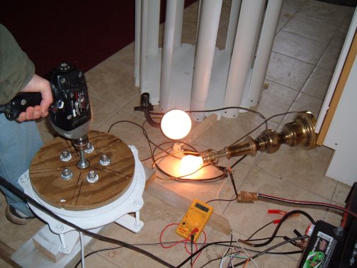

The plywood on top of the alternator is only so I could hook up my drill  with a bolt in the middle to go into the drill chuck for testing.
In the photo, the alternator is DIRECTLY hooked (no batteries) to two 75 watt light bulbs. Before hooking to the bulbs, the OPEN VOLTAGE of the alternator being spun full trottle by the 550-600rpm drill, is 120vdc. (after the rectifiers)
So with the drill going full throttle speed, the two bulbs light up and the ammeter says 1 amp. I believe that is about 120 watts.  The drill does not 'bear down' almost any when doing this.

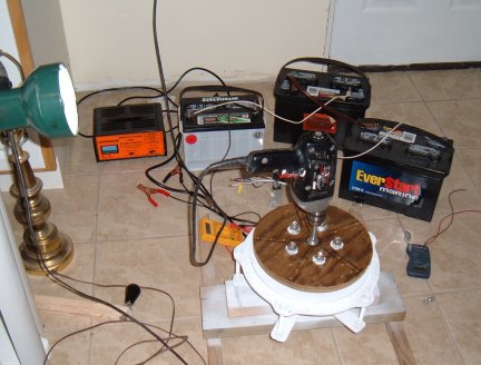

This next photo shows the 3  12volt batteries I tested the alternator with. The light is not hooked up. I simply tested amps going into the batteries with my ammeter.
First I tested the alternator and drill with only the one 12volt battery , and then I tested with the 24 volts (2 batts in series), and then I tested with 3  batteries in series. (36volts)
Previously, before doing any of these tests, I had opened up the mag air gap an 1/8" inch extra, for a total mag to mag gap of a 1/2".
So even with this bigger air gap, and the alternater Hooked to the 12 volt battery alone, the drill could barely even turn the alternator!
It started really bearing down on the gears of the drill at only 1 amp (12 watts) and for just a moment I was barely able to reach 2 amps max (24 watts) and the gears of the drill were ready to break. It could only turn the alternator upto about a very brief 120rpm. This was very surprising to me.
I then hooked up to 2  12volt batteries (24 volts) , and now the alternator and drill was able to spin up faster (probably around 450rpm) and put 130 watts (5 amps& 26v) into the batteries. Quite an improvement I must say!
(but the drill was bearing down quite a bit doing so)
I then hooked up to 3 12 volt batteries (36 volts), and was able to get 180 watts into the batteries, but it was ALOT EASIER on the drill as it was able to go the full rpm of the drill without much bearing down on the gears of the drill. (probably around 550 rpm)  So if I wanted to close the mag air gap back at this point, I could have got alot more watts than just 180 watts. (probably around 240 watts)

      Very nice looking stator, maybe you can grind away some of the resin allowing you to tap a single wire into the internal star connection then parallel all 3 phases and rectify them that way, if I'm thinking correctly that would cut your voltage by around half, maybe more.
     Although separating the connection and adding 3 more wires would give more options as well but will probably be more difficult, but not impossible. Maybe use some pliers to break out small bits of resin.

I have the feeling you don't want to cut into the stator just yet ( white paint and all)
so . To use the high resistance stator you'll need  series resistance to keep up with the current lag of each phase . My personal Choice is a water heater I 've scrounged two (I had one and acquired one) .I use a tankless on inverter as the wind is not happening when I want to shower so the two other 30 gal are good preheaters . With awg 20 your good for 10 amps per phase (Phases separated and parallel into a common dc load I think is your best idea)without cooking the the plastic Possible around 25 to 30 amps max  . Your Vawt has to get bigger Taller , wider or both .Both require top bearings if you break down the rotor and get bigger and wider and go to an H frame .  I'm pretty sure you can get the drag you need with your design at 3 times the diameter and a three section modified s  rotor in the middle to block and use the wind through the center .Your blades have to be turned more tangent to the circular plane to lift the on coming air instead of scooping it and pushing it out . That should work

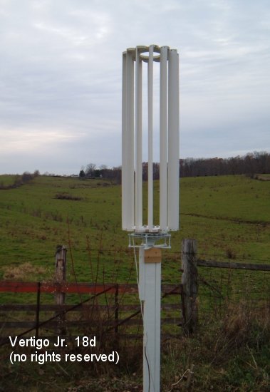

i hope you don't abandon your vawt as you have built a real beauty and i think it has great potential.
i am interpreting your use of the term "stall" as meaning a reduction in rpm due to the load the alt creates once it reaches cut in speed.
i think you are in a situation were you need to out torque your alternator.
if i recall correctly you mill has a wept area of about 10 sq. ft.
that's not much in comparison to the needs of your alt.
you have already proven that the design of your mill is robust enough to withstand
strong winds with out an exterior support structure .
i recommend you increase the height of your support post by the length of your mill or more .
mount the alternator as you have previously at the top of your "tower"
construct a duplicate mill with appropriately sized support rings.
  mount it so that it fits over and  will sit  below the alternator and encompass the support post .
now mount your existing mill on top as you have been doing.
you have now doubled the swept area. with out adding any support structure

Your tests with the drill and series resistors are not going anywhere. Adding series resistance will lower the battery charging efficiency, that is inevitable.
Adding resistors gains you extra power from a wind machine by bringing the blades out of stall. Although you lower the electrical efficiency you more than make up for it by raising the blade efficiency. When you try with a drill, the drill motor doesn't produce more power to compensate.
