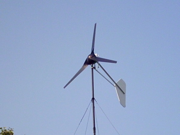

Your turbine can put out 70 amps at 24V?  Wow, that's a lot.  How big is your wind turbine?
Three days ago we had 25mph wind and I saw my machine top out at 16 amps (400 watts).  Mine is a 10' turbine.  In 25mph wind the tail is furled to the max.
Re: How does a wind turbine grid tie? (3.00 / 0) (#12)
by jmk on Thu Feb 22, 2007 at 05:50:45 AM MST
 Yes, in a 30-40 mph gust it hits up 70 amps. It's Hugh's 12 foot turbine. The tail isn't furlling right yet though. I need to make it have a smaller deg on the angle or maybe try 3/8" plywood. I don't know how to make it lighter without building a whole new tail. I screwed up and made my twelve foot test tower the top of my main tower. The top guy wire is in the middle of that because of blade clearance. It makes a bad leverage of six feet to the next tower pipe. Next summer I might have time to put the 12' piece at the bottom, so I can have 15' of leverage to hold the top six foot. What is happening is the top leans about 2" and increases my angle on the furl. This makes it harder for it to pick it up. It does go up with the right wind, but not soon enough to leave it running in strong wind. About 20 mph wind puts it at about 20-25 amps, but the gusts will take it to 30-40 amps. I only have seen 70 once, and 60 about five times. I could see it happen alot but I shut it down in wind above 20 mph. I figure I'll save my machine for another day. With little room in the battery for storage, while running a 250 watt load, and useing a C-40 to control a dump into a 1,000 watt resister I saw 60 amps hold and my C-40 shut off for about 5 seconds. Thank god it turned back on and I shut the turbine off. Now I don't turn it on anymore to see what it will do in stronger wind. Close one, phew!
