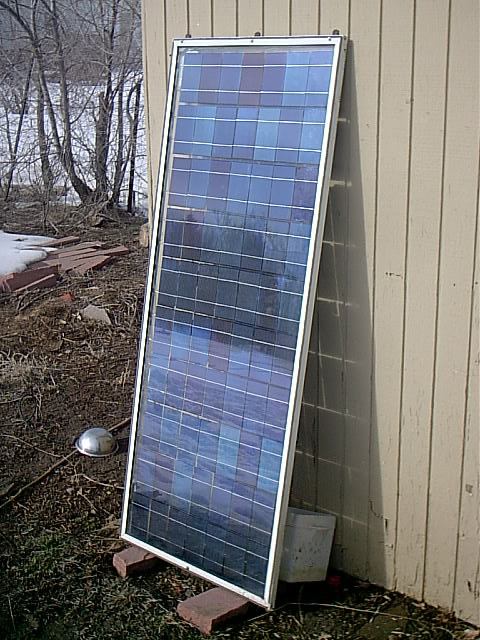

by luckeydog (bryan@coloradowindpower.com) on Fri Mar 16th, 2007 at 07:25:40 PM MST
(User Info) http://www.coloradowindpower.com
I Built this solar panel about 2 years ago.
I first had the panel completely sealed. this ran into problems
with water inside the panel.
so I then drilled two holes at opposite ends of the panel
to let it breath. this took care of the problems with water in the panel
I do live in a very dry climate so humidity levels are relatively low
here in Colorado. I am not sure if this will work in a high humidity
environment.
