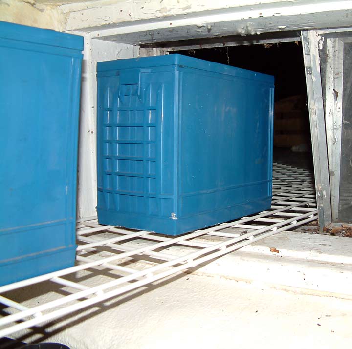

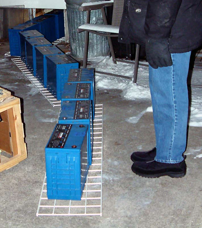

I was sweating moving 1000kg of 100lb AGMs around in snowy -20C weather so enlisted some wire rack shelving as track to make inserting batteries into root cellar nearly painless. The plastic cases slid near effortlessly once they started moving so Trish easily kept the conveyor-belt train feeding into basement - when batteries are to be removed I will fabricate a ramp to get them back to cellar window height & out...
If going with larger batteries than these I would be tempted to make their racks over sized enough to provide room to lay in 2 or 3 'rails' of something to scoot batteries back and forth between active & repair bank areas on, 1/2" PVC water pipe split lengthwise would be a low friction and non-conductive rail to slide batteries around on if one provides the extra table top depth for sorting on. A few counter sunk screws to attach each split-pipe down and it would be classy, the extra depth providing a shelf area for maintenance products when servicing them.
