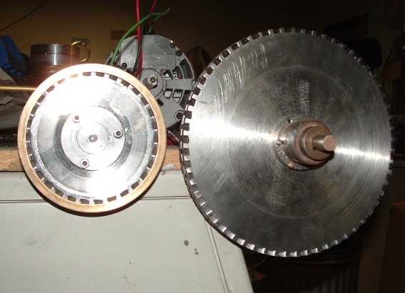

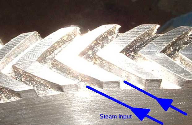

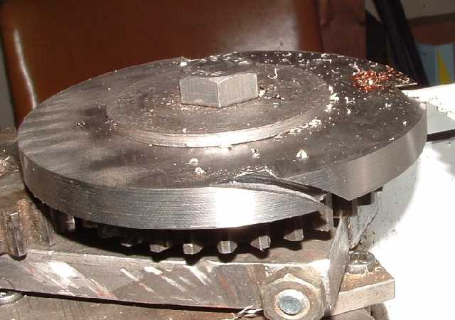

These are the first pictures of my new Stream Turbine. The new model is eight inches in diameter and is cut from 3/8" plate stainless steel 308. My tests on a 4" impulse steam last year were very good. I achieved 100 watts at 40 psi of steam.
Stainless steel is very hard to machine and this rough cut has over thirty hours into the blades and hub. There are sixty teeth on the rotor and a ring will cover the teeth producing channels for the steam. A close up shows the channels for the steam input. The channel narrows as it reaches the center compressing the expanding steam and transferring the energy into the rotor. The reduction in the velocity of the steam is about half.
The blades were cut on my lathe using a 4 3/4" bimetal circle cutter. Pictured here is the 4" turbine blade being cut last year.
Eight inches is the maximum that I could cut on my indexer. The depth of cut was 1/4" and the bimetal cutter cut 120 cuts and remained sharp. This last picture is to compare the two units.
I want to design an alternator for this unit after initial rpm test are done on the rotor which I expect to operate at around 12000 rpm. I have estimated 500 watts from this unit and 80000 btu of co-generated heat. This unit gets it's steam from a coil tube boiler that I will post pictures of later. The boiler will be fired with wood and be around 3BHP (Boiler Horse Power) The waste steam will be condensed and the heat will be used to heat a green house. Hopefully this year.
Joseph.

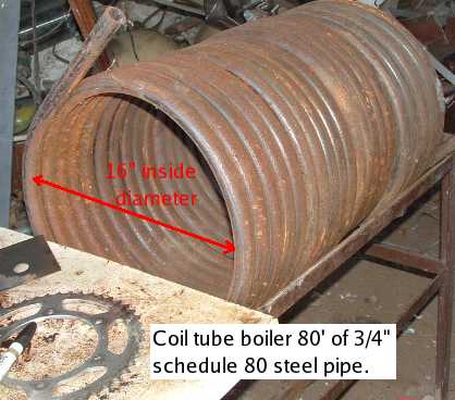

by WXYZCIENCE on Thu Mar 1st, 2007 at 02:22:27 PM MST
Eighty feet of 3/4 inch pipe are coiled to form the guts to the steam generator.
The tubes will be mounted into an old automotive propane tank next month.
Joseph.

by SparWeb (sparweb at ANTISPAM_hotmail_com) on Thu Mar 1st, 2007 at 11:22:45 PM MST
16" coil of 3/4" steel pipe - schedule 80!  You found that coil as a unit right?  Is that coil an oil-field left-over?
If you "invented" something to coil up that tube, I am very curious to know about that!  It would take some serious torque for a machine to do that, even heated up!  Does it have some advantage over, for example, schedule 20 copper pipe, that may not be obvious?  The copper would transfer heat more efficiently.
About the steam impeller: Were you constrained to use the size of cutter you did?  A smaller diameter of cutter might have allowed a less-sharp apex in the throat of the vanes.  Of course, it looks like it will work well the way it is!
Your inventions are fun to see.  Thanks.
Steven Fahey
Re: Tube Boiler (3.00 / 0) (#8)
by WXYZCIENCE on Fri Mar 2nd, 2007 at 01:25:01 AM MST
Steven, the coils are made from 21' lengths of pipe then welded together. The machine we built coils up to 1" easily. Have not tried any larger. We do not heat the pipe. After a coil is made it is then backed off one turn to remove the spring force. It then slides of of the form easily. Steel holds the heat longer and I can control the steam better. If the unit runs dry there is no ill effect to the steel coil. Unlike copper you get too much copper oxide inside the coils. Most copper tube boilers that are gas fired have shut downs to stop flashing. Wood fired can't be shut down that fast.
On my 4" unit I used a 3-3/4" cutter. On this 8" unit I used a 4-3/4" cutter.
Joseph.

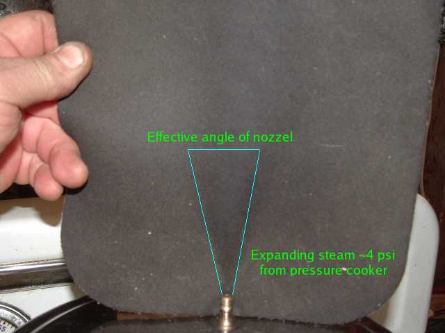

by blimpyway on Sat Mar 3rd, 2007 at 04:45:06 AM MST
Hi WXYZCIENCE,
How much steam per minute at 40psi the 4" turbine needed to make 100 watts?
Thanks,
Cezar

by blimpyway on Fri Mar 9th, 2007 at 01:34:17 PM MST
Thanks Joseph,
Still I'm a little confused here http://www.fieldlines.com/story/2006/4/22/201245/472#7
you say the nozzle is 1/16 inch, not 1/4, which is 16 times smaller.
Here are my semi-random thoughts.. not sure they-re very acurate:
At a rough aproximation, to keep steam exiting through a 1/16 inch at 40psi would need 2000-3000 watts of heat, yielding (at 100 watts mechanical) 3-5% thermal efficiency. The 1/4 inch nozzle would require 16 times more heat to produce 100 watts.
Have you considered just adding more steam (using the big boiler & several nozzles) to the small (4") wheel and double its RPM?
By using a condenser the nozzle speed and efficiency should increase significantly.
Instead of expanding 2.5-3 times, the steam could expand more than 10 times.
A condenser creates vacuum so it also decreases a lot the aerodynamic friction loss at such high RPM.
I think increasing the turbine's peripheric velocity will improve efficiency too.
A 10cm wheel running at 12000 rpm has a top velocity of ~60 m/sec.
At 40psi the expanding steam reaches 900-1000m/sec.
Spinning the turbine closer to half the steam exit velocity should extract more mechanical power from it.
Turn it as fast as it doesnt breaks.
