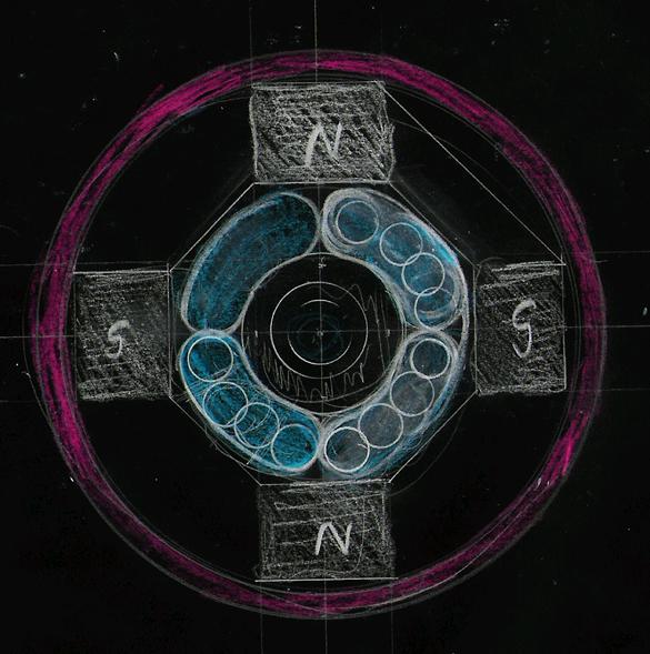

i'm looking at 16 magnets . 1"x1.5"x.5 "
i could lay them out on a 10" rotor and build a single rotor axial alt
and for comparison purposes, using a stationary return path.
i was thinking two phase, with 32 overlapping coils.
as an alternative,
 it would be possible to do a single rotor radial alt.
placing the mags on the inside of a 4"pipe
i have in mind a four pole layout with the poles consisting of 4 magnets each.
sticking with the two phase idea, i would require only 8 overlapping coils.
right away i can see an advantage in reduced resistance. as i am eliminating the ends(non productive copper) from 12 coils while retaining the productive copper.
there would be the same amount of magnetic flux crossing the coils.
but the frequency  per rpm would be reduced from 16 to 4.
over all i think there might be an increase in current but a reduction in voltage.
any thoughts?

Edaddy if you decide to try a radial design,ive got some 1x1.5x5/16ths arc segment neos.Maybe to sell.Should work well on the 4in diameter.

that's a very generous offer  v'man and i may take you up on it when i get a little further along.
this idea has been running around in my head for a while.
it's kind of the opposite of a motor conversion.
the coils would be attached to a central  stationary shaft and the mags to a rotating outer casing.

by electrondady1 on Mon Mar 12th, 2007 at 06:30:16 AM MST
 tom,can i post a .tif file?
i made a little drawing of what i had in mind and scaned it . but for some reason its formed into some thing called a tif instead of a jpeg  what ever, it seems huge
Re: radial alt. (3.00 / 0) (#9)
by TomW on Mon Mar 12th, 2007 at 07:24:05 AM MST
electrondaddy;
I wouldn't post it direct into your comment but upload it to your files and I will post a direct link to it if you don't know how.
.tif are pretty big. Is it the one called "Scan0001_Small.tif" ??
If so the direct link to it is:
http://www.otherpower.com/images/scimages/2793/Scan0001_Small.tif

by wdyasq on Mon Mar 12th, 2007 at 06:47:10 PM MST
electrondady1,
If you want to save and use this you are welcome to. I took it from ~1.6MB to 53kb. It took more time to transfer files than to make it smaller.
I will remove this file from my upload space in the near future - when I am cleaning out old stuffs.

by electrondady1 on Wed Mar 14th, 2007 at 06:24:21 AM MST
thanks very much for making it smaller and changing it to a jpeg.
i suppose i will need to learn how to do this if i want to post a drawing.
 i have been a bit distracted this week
the timing chain went on the mighty astro van, so i have been up to my elbows in v6 motor.
experimenting with vawts led me in the direction of large diameter rotors
with lots of poles/coils.
if i give in and  use a belt drive i can make the alt turn at any speed i want .
so the mags are placed on the inside of the rotor , they will stay inplace no matter how fast i spin them.
