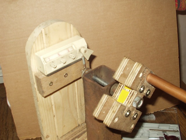

Simple but it works
Someone was looking for a turns counter on a recent post (cant remember who or when)
This is the one I use, I pinched it from the wifes knitting machine when she wasn`t looking lol
A simple split pin or cotter on the spindle trips the count.
plenty of them on ebay   http://cgi.ebay.co.uk/Row-counter-for-Knitmaster-Knitting-machine_W0QQitemZ250092962013QQihZ015QQcat egoryZ28146QQrdZ1QQssPageNameZWD1VQQcmdZViewItem
Regards Russell

My favorite cheap turns counter is a jump rope with a built-in turns counter
Hook it straight to the coil, each turn counts up or down by 1 count and has a reset switch
