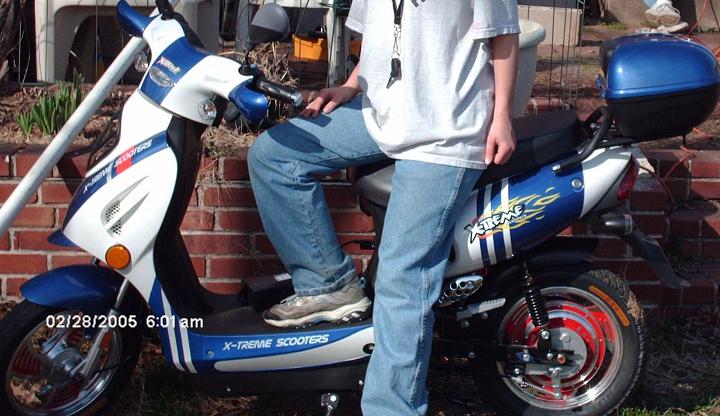

  The current build is for 48V @ 20Ahr. The new e-scooter that is for our daughter
 Came with 12Vdc@12Ahr SLAs. Okay batteries, but for sure do not like the 28F we've been having. They also suffer from not liking the 550 watt draw that it takes to get going. The e-meter shows into Red zone when taking off then settles down.
 I measure the battery box and I can get twice that using the Sub-Cs that are in those packs. I will take the batts up to 50+ Volts so the system sees it as 48Vdc and see how it goes with the 20Ahr sets, if all goes well and the price comes down I may buy some of the C or D ones that are up in the 10Ahr rating and put those in where she can ride it with 30 - 40Ahr which will be more than enough to get back and forth for dance.
The charger is 48V output smart charger. Nice runs okay on inverter too.:-)
The style of plug in that is the same as a plug in for AC into computers:-(
