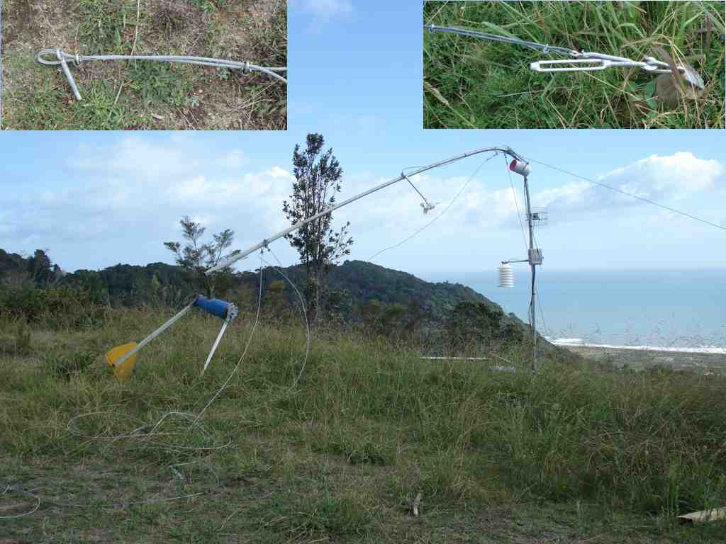

This is a 'temporary' installation I put up quite a while ago. The 2.5m turbine sat atop a 10m high 2" galv pipe pole and powered an attached array of weather equipment as well as a computer and a wireless link (remote weather station). The temporary installation was intended to last a couple of months until I got rid of the pine trees occupying the permanent site about 200m away. About a month ago some kindly sole decided to steal the laptop that ran it (about a two kilometre walk behind a locked gate up a steep hill. Thankfully they considered the 2 x T105's a bit much to carry and pretty much left everything else alone) so I haven't been to concerned with it of late. The turbine was left shorted out but is a cheap Chineese model I have imported with a undersized alt that gets away in winds over ~20k/h even when shorted. The furling mechanism appears to be fine.
I have preached to many a folk on the necessity of securing turnbuckles after seeing a number vibrate free and usually at least tape them up as a stop gap until I wire them properly. For what ever reason I never secured the ones at this site.

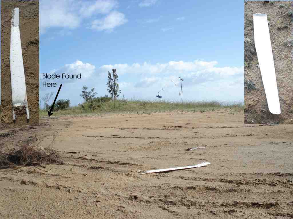

We have had winds gusting over 80k/h (as measured at another similar site I have not too far away) for the last couple of days. I was working close by today so decided to check up on this site and found this:
(click images for high res)
As you can see the eye from one of the turnbuckles securing a top guy wire has vibrated free and consequently the tower has toppled. Two of the blades have broken off at the root and were found approx 30m away. Luckily I have imported a few of these turbines and have parts to fix it. All of the other equipment managed to avoid getting damaged.
So if you have unsecured turnbuckles out there, take this as a warning and get out and secure them!

Wonderful job Jim ... thanks for sharing.
Although I hate to see damage like you show it is instructive to those who may think, 'I tightened the nut on the turnbuckle... that should do it.'
There is a reason turnbuckles on airplanes have safety wires on all the pieces.

I used to change the lightbulbs on 1000 foot TV towers. all the turnbuckles on those towers had wires going through them too , , ,

Jim , that is a beautiful site for a turbine!
what is on the tip of the left blade in the bottom photo?

Hi willib, yep a great site for a turbine. More images from/near the site can be found at http://www.mce.co.nz/gallery/gallery.htm
I think its more of a case of whats that NOT on the tip of the left blade... What you see is the damage caused be the tip hitting either the tower or one of the guy wires. It shouldn't be too much drama to repair both of the blades. I have been wanting to try shortening the blades on this model turbine to increase the RPM and try and get more out of the small alt it has (coupled with my prototype MPPT controller!)

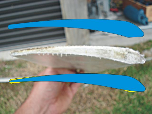

by jimovonz on Sat Mar 17, 2007 at 08:14:02 PM MST
As you can see in the pic above, the blades are now tapered. Because of the curve in the profile this also gives it twist (you have to cut off and reform the leading edge) much like you get with PVC pipe blades. This has the effect of increasing the TSR and you would also assume this would be at the expense of startup torque - though its never been an issue for me (even with the the most tapered blades) The blades in this pic were the very first I modified and I tapered them from half way along the length down to half the original width at the tip. The later blades are tapered from closer to the root and are narrower at the tip. The tapered blades definately run faster though as I said I don't have the hard figures yet. The alt on this turbine is quite under sized for the 2.1m blades and I believe benefits from the higher RPM. I intend to use the broken blades from the above turbine to test the alt with smaller diameter blades (they are all broken at the root) to see if there are any gains to be had.
The noise seems to mostly be caused by the flat spot just under the leading edge. Some of the blades have a pronounced ripple in the surface as well as a general roughness. I sand the blades once I've finished and give them a coat of epoxy (mainly to stop the fibres that run along the length from pulling  free - they end up looking like fur). Rounding the tip also helps though the effect is more pronounced once the blades have been tapered.
Here is a photo of an unaltered blades profile. The blue profile at the top is an approximation of this, while the one at the bottom shows what I remove (yellow) and what I end up with.

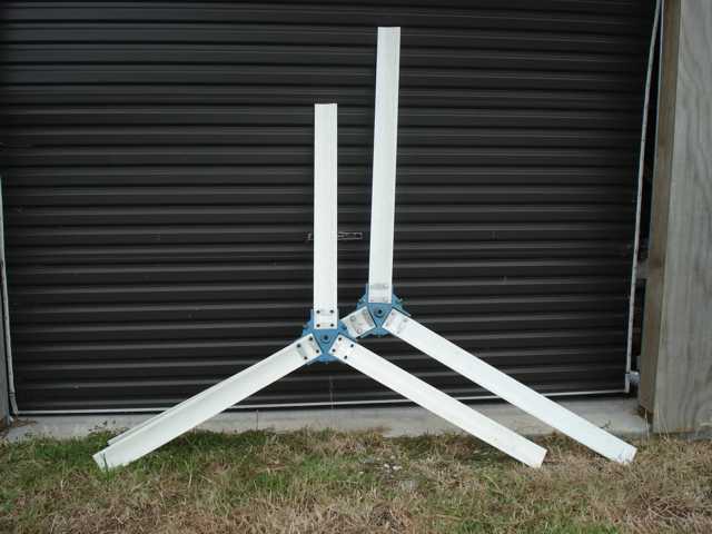

This pic shows the hub/blades (unaltered) from the 2.2m and 2.5m turbines:
