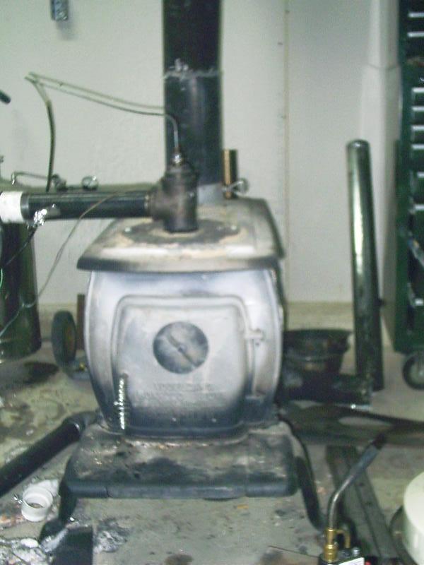

Last summer I put up a new shop  Area  52.1.  An this winter I had some time to tinker keeping it warm.
Here what I got so far.
The stove its self is a cast iron box wood stove.
I removed  the top cover  plate and replaced it with a steel  plate  with a hole for air and fuel .
The pipe is two inch black iron.  And the blower was from an old propane furnace .
The  foil  you see was a attempt  to cut down the air flow . This blower is way over kill and I ended up  using  a light dimmer to slow it down . I found that good air control is critical in getting a clean smoke  free burn.     This basically a force draft version  of the  Mother Earth  News  stove
The oil is gravity  fed  at a rate of about  ½ gallon  and hour  this puts this at roughly  70000  BTU an  hour input.  Lighting is easy I put two paper  towels  in the burner turn on the oil drip wait a bit light it turn on the blower .

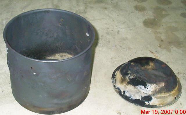

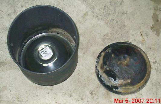

The only thing new here is the fire pot . All the ones I read about used  heavy  steel plate or pipe for the burner.
And are all plagued  to one degree  or another with  a build up soft soot  or rock hard crud  that has to be cleaned  out  quite often .
Here is where I took a different track.   What I am using is a cheap 8 quart  stainless steel stock pot  with a stainless steel bowl inverted in side it.  The bowl  works as preheat surface for the oil .
Set me back a whole 8 bucks at a Odd Lot store .
My reasoning  was to have a burner that would  heat up fast to maintain combustion and be easy to clean.
As it turns out  after  about 40 gallons of oil there is nothing much to clean out .
Now if you set the air flow to low you can  get  a heavy  coating of soft soot  but  up the  air flow and it will burn out .
I have been burning any kind of oil I could get my hands on with no problems.  Even some  WVO.
One thing I want to try  is to  increase  the air inlet to three or four inch pipe to see if  I can use natural draft
And do away with  the blower.  As of now I have no problems at all keeping the shop warm with it.
And it looks like I  will  get another heating season  or two out of the pot and bowl.

Nice - you may want to preheat the air to get better combustion.

I really like your stove. How much air is blowed in,  with forced air are you getting any fumes out from cracks and joints on the cast iron box? Did you do anything specail to seal the joints, door, ashpan, etc... to prevent blowing out fumes
I have a somewhat similar small cast iron unit in the yard. Made different but about same size shape. This would be good for mine, and I been wanting to take it apart and clean it up, basic rebuild, someone gooped it up with some putty sealer stuff around joints.
Is that an AC blower fan? A couple posts you may have missed are about the lower power use of DCfans compared to AC fans. A normal $10 sized AC box fan uses about 72watt on low speed, a car radiator fan running on 6VDC uses about 13watts, car fan moves lots of air at a reasonable speed, will start at 3V maybe less.
 I mention that because if you use a car heater blower on DC you may save some electric power also and can vary the volts to adjust the speed most likely. I have not tested that type of blower from a car heater yet to see what power they use etc..
So, basically it is gravity dripping into an airstream from the blower and directed down into the stainless pot and that's it? No diffusers or other stuff? How far into the top does the pipe reach? Just beneath the top plate, half way?

There is nothing like an air tight  stove .
And there is nothing air tight about this one  :  )
The blower  I am using  is way over sized  and  to slow it down enough  I had to us a  AC light dimmer switch or I would not  blow  all kind of nasty s  out of the cracks .  The two inch pipe in side the stove  is about  two or three inches  above the lip of the pot . Here is were a little  more tinkering can be done to find the best length
Here is were I found the air fuel delivery  system I am using
http://journeytoforever.org/biofuel_library/ethanol_motherearth/me8.html
The only thing  different is the burner pot.
Old F
