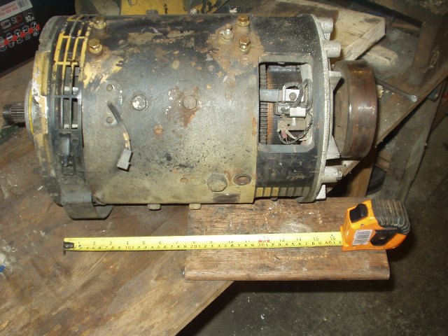

          The pic below is of a large 72v traction motor from a 2 tonne electric forklift. I have been told that this is a series motor and that it can be used as a DC generator, but that is about as much as I know about it.
So Question one........ Is the above true?
Assuming that this is correct then my plan would be to drive it with a 10 hp diesel engine that I happen to have. The idea is to charge my 48v battery bank at times of low wind etc
So to the nitty gritty of the matter, the motor has 4 main connections the 2 nearest the brush gear are stamped A1 and A2 and the two at the other end are stamped F1 and F2. The ID plate is missing from the motor so its speed is unknown. This is a heavy beast! Two men struggled to get it onto the bench.
My guess at hook up would be, A1 and A2 = battery Pos and Neg and possibly through a big diode to stop the motor discharging the battery?
I also presume F1 and F2 are the field connections and by controlling the current through the field I could control the output at A1/A2.
So that's how I see it, am I even close?

A true series motor is virtually impossible to use for battery charging but your beast may have a shunt stabilising field that you may be able to use.
It may not self excite from that shunt field but you could excite it from the battery via a series resistor if necessary.
You may have to dive inside and reverse the connections to the series field or possibly bypass it completely if you have enough shunt winding.
I suspect you can do it but without detailed knowledge of what the motor is wound as you are in the realms of experiment.
It will probably need to be driven fast.
I strongly suspect that the field connections that you have access to are a shunt winding and they may look to be lower current connections than the armature terminals.
If the field terminals are very heavy with very thick leads then it is probably a series winding. If it is series only you will have to do some serious tricks to use it.
Try measuring the field resistance between those terminals, if it is ohms then it is likely to be a shunt winding, if series it will be a few milliohms.

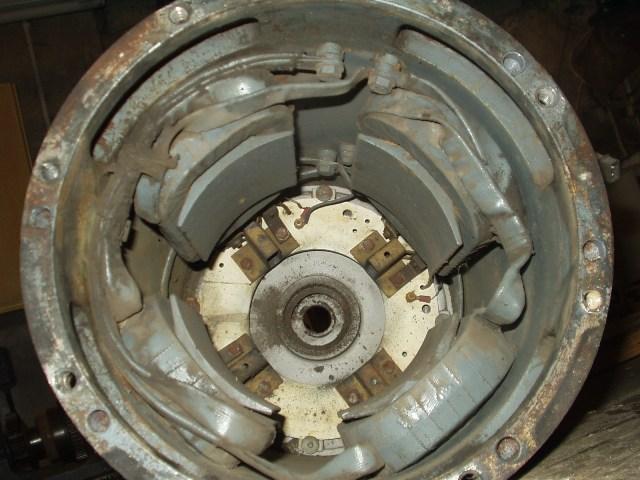

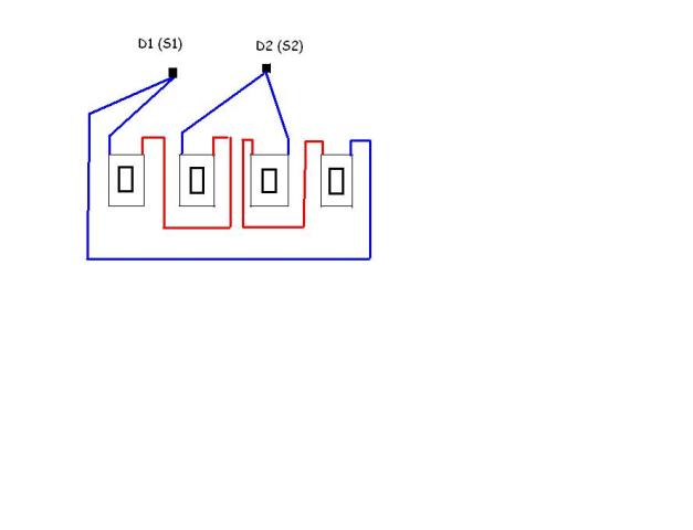

I have just had a better look at it and found that I have misread the connections completely! I really must get glasses lol anyway after a rub with a wire brush a bright light and the use of my wife's eyeballs ! The connections now read A1 and A2 at the brush end, the other two are D1(S1) and D2(S2). Don't ask me where the F came from!
I have also pulled the beast apart and can confirm the leads and coils are all heavy. I have added a pic of the coils and a diagram of how they are connected to the terminals.

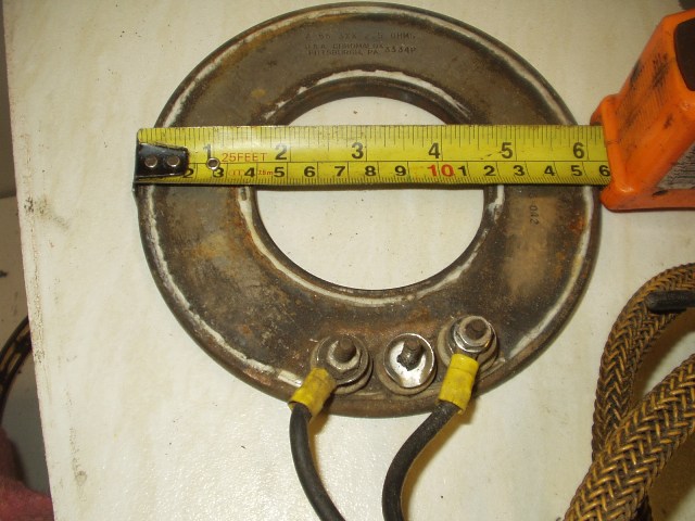

I have also found a little bit more info which might help those in the know! The truck had regenerative braking where by when the truck was coasting down hill the battery would charge to extend run time, when braking it was dumped to a large resistor in the chassis to reduce brake wear. I found the resistor today it is 2.5 ohm and about 6 inch dia

That does look to be series only, I can't see any shunt winding, but there may be some thinner leads at the brush end.
To use it as a separately excited generator you will need to supply the field with lots of amps at a fraction of a volt. If you connect the fields series instead of series parallel it will be a bit better but you will still have extreme trouble supplying that current at such a low voltage without special equipment.
Best advice I can give is to rewind the fields for shunt. I have forgotten what your battery voltage is, but you should be able to charge up to 48v easily. Turns and wire size would depend on the battery volts but you are probably looking at about 500AT per coil as a starting point.

A series motor is a very bad choice to use as a generator. As mentioned harder to excite, high speed. If it is a series design the field coils will use a very large cross section wire and they are connected in series with the stator coils pos to A1-A2 to F1-F2 to neg. If it is a shunt field ( smaller cross section wire) or compound ( with both series and shunt fields they you may have something you can use.
