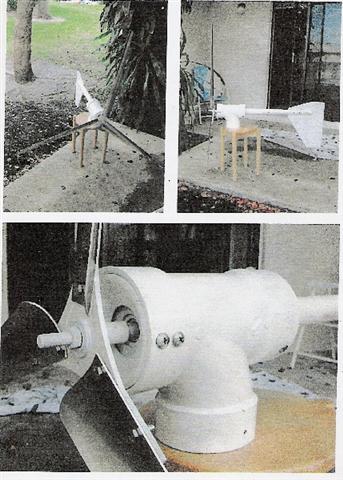

Hi Owen, the first windmill I built was for a sailboat that my son lives on. You have clean wind down to the water line so you don't have to put the mill in the mast area. My son had an ss bracket made with a swivel boom and mounted so that the mill operated below the mast on the stern of the boat. The boom would swing out and lock at the corner of the stern at a 45 degree angle and the 36" downwind windmill mounted on the mount and swiveled to follow the wind, with stops to keep the blade from hitting the boom. I do not have pictures of the one I built but I do have the original plans by Bob McKenna that I built from. I will scan and email them to you if you would like. This is a picture from those plans, hope it helps pepa. Try this web sight http://ebooks@mckennaweb.com a picture of his mill
