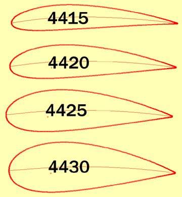

I am writing this post to discuss the benefits of using progressively thicker airfoils at the interior of the blade, with a somewhat limited chord, as opposed to using a constant thickness throughout. It will discuss how the benefits can be seen in either a twisted blade, or a strait blade. For this discussion, we will be using a static pitch, 17 degree total twist 3 blade, 10 ft. dia. turbine, with a N.A.C.A. 44xx series of airfoils.
Before we get into the aerodynamic benefits of using thicker airfoils on inboard sections of the blade, we must discuss how much power is in each segment of the blade sweep.

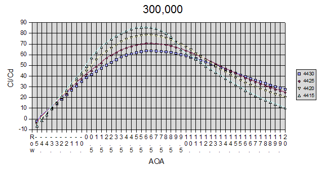

Now we can start looking at the aerodynamic data. Below is a list of the performance curves for 4 different airfoils. They were NACA 4415, 4420, 4425, and 4430. The last two digits of the airfoil number represent the thickness of the airfoil. These calculations were done with Javafoil, using the Eppler transition, and stall models. The Reynolds Number was set to 300,000
These calculations show optimum angle of attack and relative output, and does not represent the actual blade efficiency. Note how the 4430 has a much wider angle of attack which is logical for a wider profile, but it actually has a higher Lift/Drag (Cl/Cd) than the 4415 at any angle past 11 degrees.
Figuring that a twisted blade has 17 degrees of total twist in the blade, and is mounted at a starting AOA of 3, with a linear twist, this would be your twist
When you figure in the apparent wind angles vs. TSR you get your angles of attack:
You can see that at any TSR, the inboard sections would benefit from being a thicker profile due to their angles of attack, especially during their lower TSRs. This holds true even more-so with straight blades because they will have even higher relative angles of attack on their inboard sections due to the lack of twist. Not to mention the fact that the 4430 has peak performance at a higher AOA than that of thinner airfoils. (which is good because you can't realistically twist the inboard sections enough)
So in conclusion I believe the benefits of using thicker inboard airfoils are three fold. First, you can build a longer blade by using less material, which is the best way to increase power and the drop the $/KWH. Second, the thicker airfoils have a wider range of good AOAs, which better suits them for the wind characteristics at the interior of the blade. Lastly, given the relative wind angles, and realistic construction constraints (max-twist), an increase in efficiency is actually seen with thicker airfoils at the inboard

The numbers for the %span represent the amount of area in each segment.  If anything the numbers are higher for the inside sections compared to real world because most blades are not built to 100% "optimum" cord in the for those sections.
I am arguing for a thicker airfoil, not for super wide chords for inboard sections.  The section you mentioned would have a thickness of %17.85 or in this airfoil set be a NACA 4418.  I am advocating the use of airfoils with 25% or even to 35% thicknesses for the inside sections of the blade.

I think you might be led astray somewhat by JavaFoil, in that it doesn't show flow separation (stall), with the attendent dramatic drop in L/D, which should occur somewhere around 12 degrees AOA. I believe JavaFoil's author also says something about this. I think you should consider the data above 12 degrees AOA questionable at best.
I agree with your first conclusion about the structural benefits but have to question the other two.
If the blade angle is correct for the TSR and the AOA is at best L/D, no improvement can be made using a thicker section. Yes, the broader curve for the thicker section can help errors but only up to a few degrees. Much more serious is the 25% loss in L/D.
What are the different wind characteristics at the smaller radii that you're concerned about, assuming you don't start the airfoil until 20-25% radius?
I question your third conclusion for the same reasons. Build it right and you will have a loss with the thicker section. I really don't see the construction constraints unless you feel you have to build with 2-by lumber or some such.
By the way, are you including a correction factor to AOA for blade aspect ratio in your model?

"I think you might be led astray somewhat by JavaFoil, in that it doesn't show flow separation (stall), with the attendent dramatic drop in L/D, which should occur somewhere around 12 degrees AOA. I believe JavaFoil's author also says something about this. I think you should consider the data above 12 degrees AOA questionable at best."
Are you talking about the fact that in the program it lists the ploar as Cl-Cd not Cd/Cd?  In the output text it has it listed the latter way, which is where those curves came from.  But I do know that, from a paper I read, that basicially the thicker airfoils don't compute as accurately as their thinner bretheren, so you may be correct.
"If the blade angle is correct for the TSR and the AOA is at best L/D, no improvement can be made using a thicker section. Yes, the broader curve for the thicker section can help errors but only up to a few degrees. Much more serious is the 25% loss in L/D."
That is true, but for this paper atleast it was assumed blades were not constructed with a full twist.  Also the main crux of this paper was really the first section, explaining how a structurally strong inboard section was beneficial, and the latter sections are just explaining other "benefits" of that design method.  i.e. One would be better off building their blades 1-2% longer than trying to squeeze every last watt out of a section that is only creating 3% or 5% of the output in the first place.

"Are you talking about the fact that in the program it lists the ploar as Cl-Cd not Cd/Cd?"
No, I'm talking about your presented graph. I would expect to see a rather sudden drop in Cl/Cd at the flow separation point AOA which is when the blade stalls.
The program author states on his web page, "If you analyze an airfoil beyond stall, the results will be quite inaccurate."
I expect the 44xx stalls somewhere around 12 degrees AOA. Your graph goes to 20 degrees AOA so I wouldn't trust the data from 12 to 20.
