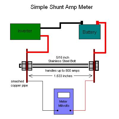

David,
A simple solution is to just use a cheap multimeter and a stainless steel bolt.
I'm actually selling a book about homemade shunts so I don't want to give away all the good stuff ( http://www.PoorMansGuides.com ) but here is a pic to help you get started with a 800 amp  1mv/amp shunt.  So, set your meter to mv and hook to the shunt.  And 800 amps would read 800 milivolts.

You don't want to put the sense wires and the load wires under the same nuts - or even share a nut.  That puts the threads and nut/lug resistance in series with that of the bar.
Use eight nuts.  And put the sense pickoffs a tad outside the power lugs (to avoid flexing and corrosion of their connection due to heat variations).

Huh?
The resistance of the meter has nothing to do with it.
The accuracy of your metering is no greater than the accuracy of your shunt resistance.  If you have 0.01 ohm of shunt and 0.1 ohm of connector resistance your readings will be off by a factor of 11.
You avoid that by keeping the connection resistances out of the section of the shunt that is sampled by the meter.  Which you do by using separate connections to the basic shunt bar for the meter and for the load.

Sorry, I misunderstood you.  I agree that the nuts would have an impact on resistance.  Although a stainless steel nut has less than 0.0001 ohm.  It is screwed on the bolt (the main conductor) therefore acts in parallel to it, thus reducing the overall resistance (but only slightly due to the fact that the bolts  take up a small portion of the overall length of the conductor.  Besides, you can adjust the nuts one way or the other to calibrate the shunt very easily.  In other words, the nuts are actually part of the shunt resistor in this case.

One more thing, if your requirement is 0.1 ohm shunt that can handle 20 amps, my shunt calculator says that you can use 63 feet of 12 gauge copper insulated wire as a shunt.
