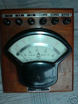

can I make voltmeter from a amperemeter
An ampere meter is a voltmeter with a shunt if I have it right.
So,if I buy an amperemeter and take out the shunt I have a voltmeter?
Just verifying before buying.
And (only if my supposition is right)
What ranges can I expect for the voltmeter if the amperemeter has ranges
from 10mA to 5A?
Thanks,
cheers,
stonebrain

Sort of.
Not a sensible thing to do unless you have all the details, at best it will be a millivoltmeter and you will need multipliers.
If you pick the wrong beast such as a moving iron you would come badly unstuck.
For measuring volts buy a voltmeter. If you have a millivoltmeter you can measure current with a shunt, don't push your luck.

Can't see the picture very well but it looks to be moving iron, it seems to measure ac and dc and has a non linear scale.
It looks as though it is based on a 10mA moving iron movement, it will be a poor voltmeter and the non linear scale may not hold as a voltmeter, as an anemometer it would be pretty useless. It will probably be too big a load for your generator and the non linear scale would be very confusing.

Well, it is a somewhat odd thought to take that and make it into a voltmeter.
Thats just me tho because I love that old gear. I think you would be better served by purchasing a cheap $5 "farm store" meter or send me that ammeter and I will send you a volt ohm meter that will read ac or dc voltage as well as resistance.
You probably could construct a voltage divider network as an input to that meter as it is to read voltage but, again, I would not.

Where are you when I am selling my old stuff on ebay?  I'm actually fond of the Dr. Frankenstein look, I have a large slate plate with exposed knife switches.  The optics of a project are everything.  Theoretically, you would need a 100 ohm resistor for every volt to get a full scale reading. The final resistance would need to be 10 to 40 ohms less to compensate for meter resistance.  Problem is that you only have have a 5 and 10 based scale.  12V is too much for a 10V scale and down in the mud on the 50V scale.

YES, SORT OF !!!
Though, if you get one with a shunt and a Darsnoval movement it is possible,
A good current meter, with a low value shunt, may have a 1 milliamp meter.
I have done that many times by just adding a switch (DPDT) = Double Pole Double Throw, and adding the necessary resistance for the voltage reading which most of the time is 1 Kilohm per volt of display, less the internal resistance of the meter for the first 1 volt reading.
Vane type current meters DO have a high internal current which make them BAD for voltage reading, though in some cases, the say arrangement with the caveat of about 10 to 50 milliamps meter, so in those cases I have used a momentary switch to make sure that the switch is returned to its original setting of current meter position.
Some vane meters are very high current, equal to the current peak reading capability, so not possible to convert to a voltmeter.
