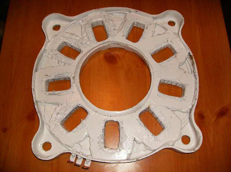

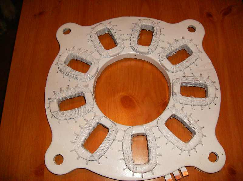

Finally got the photos for those who asked about it...
Several folks asked how I was going to mount the coils, so this is how it was done.
First I laced the coils onto the stator plate. Then I cut 5" long pieces of
1/2"x1/4" aluminum stock to fit between each coil. I cleaned up the plywood ring
left over from making the stator mold and obtained a piece of waxed paper which I
waxed again with mold release wax. The stator was layed flat face down on a piece
of 1/4" steel plate and the aluminum pieces were fitted radially between each coil.
between the face of the stator plate and the steel.Sika epoxy anchor bolt adhesive
was liberally applied about the perimeter of each coil. Wax paper was layed over
the assembly and plywood ring layed over that. Large C-clamps were applied tightly
at the cardinal points to force the stator plate and coils respectively to level, each at their own plane.

Re: Non-cast stator (3.00 / 0) (#1)
by RP (russp located-at fidnet (dot) com) on Tue Apr 10th, 2007 at 05:13:00 PM MST
Please explain a little more about the aluminum bars.  I don't understand that part.  Are they embedded in the stator between the coils?
Re: Non-cast stator (3.00 / 0) (#2)
by clflyguy (sidney.raiford@gmail.com) on Tue Apr 10th, 2007 at 05:45:03 PM MST
No, they were simply used as spacers while epoxy set up to hold the stator plate at one level and allow the coils to be pushed down onto the steel table 1/4" lower
than the face of the stator plate.

Re: Non-cast stator (3.00 / 0) (#3)
by vawtman (vawtman(at)charter(dot)net) on Tue Apr 10th, 2007 at 06:50:27 PM MST
Nice work lacing the coils and the plate having that outer ridge to reduce or eliminate warping is also a good idea.
 Thanks for sharing and best wishes for your hard work.
Re: Non-cast stator (3.00 / 0) (#4)
by ghurd on Tue Apr 10th, 2007 at 07:21:57 PM MST
It is projects like this that make me feel 100% completely insignificant.
"Get a haircut, you hippy!"   ;-)  That's what they tell me.
Now I feel a little better, just a little, but good enough to ask a question or 2.
Is the stator `frame' reinforced with fiberglass?  (not my strong point)
Earlier photos look like it could be pure epoxy?
Looking forward to the photos of the finished blades.

Re: Non-cast stator (3.00 / 0) (#8)
by clflyguy (sidney.raiford@gmail.com) on Tue Apr 10th, 2007 at 09:30:10 PM MST
Hiker,
  I seriously thought about plywood for stators but eventually decided on glass
based on what I have seen happen to even the highest quality marine plywood.
  About the only way I can think of to protect the wood well enough to suit
my overly anal standards would be to lay it in a pan of marine grade polyurethane
for a few days to let it really soak in, then pull it out and let it harden in
a hot attic for a week or so- and I'd probably still worry!
            Gus
Re: Non-cast stator (3.00 / 0) (#6)
by clflyguy (sidney.raiford@gmail.com) on Tue Apr 10th, 2007 at 09:16:05 PM MST
Hey Ghurd,
  Come on, don't even go there man. I look through your files too, ya know? You're
way ahead of me on the solar end of the deal, I haven't even started yet. I was
big and hairy for my age and started working in boat factories when I was fifteen
so the fiberglass end of it comes easy- it's all the rest of it that intimidates!
  The stator plate definitely has glass in it. It is 3/16" of alternating layers
of 10oz. cloth and chopped strand mat with just barely enough resin to wet it out.
The white paint is to help with UV resistance.
  And oh yeah- you already have turbines in the wind while I'm still building!
             Gus
Re: Non-cast stator (3.00 / 0) (#10)
by tecker on Wed Apr 11th, 2007 at 03:03:40 PM MST
I really like this technique I 've seen it in a couple of machines . Potting the coils in place is so easy I opt for that instead . I get a little closer to this method every time .I would be very cool to be able to replace bad coils so that's where I well end up . Good stuff.
