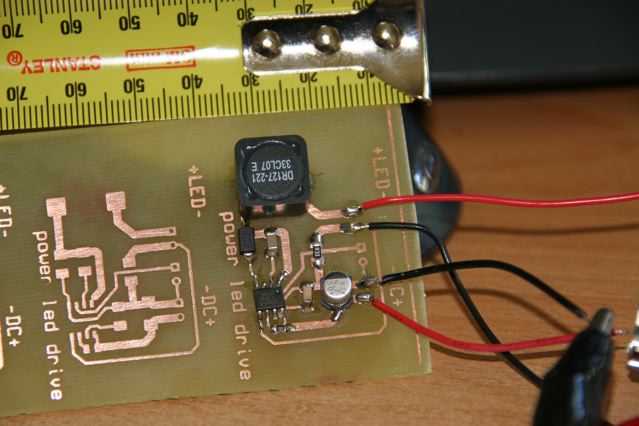

i, ive just been trying out some new drivers from national semiconductor. These are certainly not the 'simplest' circuits that you could use, but they work very well, and they are not very expensive, or tricky to put together.. You can even use the online design tools ( my web-bench ) to design your circuit, based on the various paramters you want to use..
In particualar, i've been working on drive circuits to use with 1 and 3W luxeon clones. using a current limiting resistor just is'nt that smart, it generates way too much heat. The driver i've been using is an LM3404HV which is able to run on a input voltage of between 7 and 75VDC. Its a buck psu cirucit, so it requires an external inductor, cap and diode, plus a couple of resistors. Efficency is really good, i've got over 90% out of it in some configurations. Its going to cost you a couple of dollars to build. Its got a logic level dim control, which you can attach a logic level pwm signal to ( such as the pwm output of a pic ), and get dimming control out of.
The design is is such that the output current is almost constant across the entire input voltage. Its probably mostly appropriately for higher power circuits, ( say >300mW ), anythign less, you'd probably be best doing something simpler..
for more info, check out
http://www.national.com/appinfo/power/led.html
I'm using this driver for my christmas led lighting, and i'm pretty impressed by it.. The circuit below is for a single 3W Blue LED, runnign at 700mA, 3.55V, Rd 1ohm. note, i want to dim the led using PWM, so there is no Capacitor across the output. If you just want to run them consistantly, you can reduce the size of the inductor, and put a cap in parrallel..
And now also a picture of the first prototype board for this circuit

I'm just not an inductance man: to me inductance and digital electronics means death from back EMF and even SCR-latchup!  Now, give me capacitive and resistive loads and I'm much more comfortable, but for this sort of arrangement where you're effectively getting a highly efficient switch-mode constant-current power supply, it's very good.
BTW, do you really solder those surface-mount things by hand?  I've always had shaky hands and find 0.1" pitch almost my limit.  I accidentally ordered some SMC parts the other day and immediately had to re-order DIL 0.1" packages instead.  Bv<

Having the inductor there is'nt really a big deal. You've got to remember that this controller was designed to have one attached there.  And if you did'nt have one, it just would'nt work.. Nothign to be scared of there.
On that particular board, the components where hand soldered with a good soldering iron. Its not the neatest, but for this little prototype board was sufficent, given that theres no components on there that are really tiny.. I can hand solder TSSOP packages if need be, which are also smaller.  I also use a reflow oven that i built based on sparkfuns project, for some larger boards.. it does a great job..
 ( http://www.sparkfun.com/commerce/present.php?p=Reflow%20Toaster )..
I've actually got to the point now, that i pefer to use smd components over thru-hole for prototyping, because they are much easier to remove ( and clean up ) and change.. I've done at least 5 component swaps, without damaging the copper..     Good old solder wick, is one of your best freinds when doing smd stuff.. You can fix up most solder bridges with it no problem at all.  And theres quite a few components that are not available in thru-hole anyway now.
