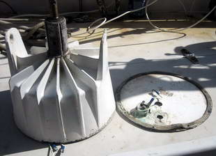

I have now got my hands on a much more suitable generator than the trolling motor. It is the generator part (only) of a Duogen wind / water generator. The web site for the original product is here: http://www.duogen.co.uk/
I already had a 5' two blade rotor with a centrifugal air brake from a Four Winds wind generator, and with limited tools and funds, I will not be able to buy or make any other blades any time soon, so that is what I intend to use. When I get more tools together, I may decide to carve some better blades if the improvement is going to be worth the effort.
Here is what I've got:
The shaft diameter is a snug fit in the four winds hub even though the bearings described below would imply that the shaft is metric. I don't have calipers here. The hole seen through the end of the shaft could accommodate set screws for which there are threaded holes in the Four Winds hub. Approximately 1/4" of the inboard end of the hub would have to be cut away to get the shaft deep enough into the hub for the setscrews to line up with the hole in the shaft:
This is the open back of the generator with the visible magnet plate. I believe there is another inside the coils which can be seen around the edge of the plate. I have a document with disassembly instructions, but no drawings or photos of the inside.
The rectifier bridge was totally corroded out, so my intention is to bring the AC wiring (suitably beefed up, say #10 AWG) down to a control box inside the boat with a rectifier and a switch for shorting the windings to stop the generator.
Here the three wires coming out of the coils can be seen. Part of the stator can also be seen and it seems to be baked in epoxy.
I have not taken the generator apart any further than what you can see in the pictures yet, as I don't particularly want strong magnets around the boat until I have all parts available to reassemble it.
The bearings in the generator are shot, and I have a document from the manufacturers which describes how to take it apart to replace the bearings. The bearings are described by the manufacturer as "17 x 35 x 10mm radial shielded" and the shaft seal is 17 x 35 x 7. In the normal installation, the generator is driven by a long shaft down from the rotor, so there is no thrust load on the generator itself. The manufacturer says that in thrust applications they "fit an angular contact 17 x 35 x 10mm at the 'seal' end of the axle". I'm not sure what they are describing here. Is this a different bearing?
It's quite obvious that the attempts to waterproof the unit from the factory have failed miserably. My idea is to paint everything inside with epoxy primer to waterproof it and leave the back of the unit open to the elements. That would mean installing a seal on the inside of the inner bearing too, but that should not be too difficult. Or maybe better (waterproof) bearings could be used that would fit the available space. The turbine will be installed halfway up my mizzen mast, so it will be subject to rain and moist salty air, but not to direct saltwater. Suggestions would be welcome.
I would like to bring the three outputs from the stator down to a control box which would contain a rectifier bridge as well as a switch to short the windings to stop the rotor. If shorting all three windings dead would provide a too violent stop, I could short one first, then the other when the turbine slows down, or maybe dump to a dump load first to slow it and then short it. When I rotate the magnet plate by hand (with much rumbling of bearings) and short two of the windings, the generator slows and stops, but not very abruptly. I haven't had enough hands available to short it while I was still attempting to turn it. I'll try and use the trolling motor to spin it up one day to see what happens.
At a later date, I may install a small water heater on the boat and use that to dump any excess power from the turbine as well as my three 55W panels. I normally shower in cold water here in the tropics, but heating it a little might make any future female crew happier. The beauty of it is that one would be more likely to wish for a warm shower on a really windy day. The water heater will also be heated from the main engine cooling water of course, but I try to reduce my infernal combustions to the bare minimum.
At the moment, with three 55W panels I am generating slightly less that I am using, but it usually evens out with normal use of the engine in and out of harbour while cruising.
Any suggestions and advice would be welcome.

The bearings that the turbine is calling for are 6003Z ( or 6003ZZ if there is a shield on both sides ) and the angular contact bearing ( that is designed for more thrust load ) is a 7003Z or 7003ZZ. Shielded bearings are fine in most applications but if there is a contamination issue you may be better off with a sealed bearing. Which would be a 6003VV or for the angular contact 7003VV ( some bearing manufacturers use a 2RS prefix instead of VV ). Also the shaft diameter is 17mm unless the shaft has a step in it.

Thanks for the info on the bearings. I think sealed bearings are probably the way to go in a marine installation. Is there any good reason I shouldn't use the angular contact bearings for both front and rear? Would it be an idea to use two front bearings since the alternator was not originally intended to support the weight of a rotor? That four winds rotor is quite heavy.
The shaft does have a step in it, I had noticed but forgot, but it can even be seen in the photo, so it seems it's 17mm where the bearings are and 5/8" where the hub goes. That suits me just fine.
Any comments on my plan to paint the innards with epoxy and leave the back plate off?
How would an alternator like this normally react when shorted? Dead stop and rip the prop off, slow and stop, or slow and keep spinning slowly? I need to be able to stop it dead somehow, as there may be times when I need to go up the mizzen mast to fix something. Also, I would want to stop it and secure the rotor when heavy weater threatens or if I leave the boat. Yawing it out of the wind to stop it is not an option as the installation will be non-yawing on the front of my mizzen mast, so that would mean turning the whole boat which is not practical at anchor. (Installed non-yawing, it'll work when the boat is at anchor, but not when sailing, a compromise I'm willing to live with.)

Normally with 2 angular contact bearings they are mounted back to back. If you only have thrust in one direction it is unlikely that you can fit 2 facing the same direction and share the thrust, most housings would prevent this and if they didn't you would need clever alignment to get load on both.
I would just fit an angular contact on the one that can carry thrust ( depends on housing) To be honest I don't think the thrust load is unreasonable for conventional ball races but one angular contact gives you security.
Whether you can stop the thing with a brake switch depends on the alternator and the prop. The alternator needs to be powerful in relation to the prop to be sure that it will brake.

I agree with Flux on the angular contact (7003VV) for the front and install a standard single row (6003VV) on the rear as getting 2 angular contact bearings to be loaded at the same time would require calipers and shim stock. In order to verify that your alternator is large enough to load and stop the blades when shorted, is there a tag on the machine to the output? What was the original blade Diameter?

I got some information about my Duogen alternator from the manufacturer. They say it should not harm it to short it dead to stop it, as long as the blades are restrained shortly after. I also have some numbers.
They say:
"Cut in RPM, iwhen battery terminal voltage is reached, happens at around 220 RPM.
100 watts occurs at around 400 RPM, 200 watts at 600 RPM. Max output, say 650 - 700 watts at 1300 RPM."
As mentioned, I intend to fly this thing with a 5' two bladed Four Winds rotor with a centrifugal air brake as seen in a photo I showed earier in this thread. Here is a photo of the original Four Winds with blades like the ones I intend to use, but without the air brake:
Any comments?
