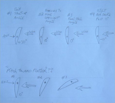

Flux, the following is what I'm thinking about trying first. Is the second example what you basically mean by "pitch toward feather"?
So you are saying that the load on the tower will be very great when the blades go to the vertical zero degree point in the higher winds. So when it gets to this point, would it be very advantagous to have the mechanism furl the blades back further to say -15 degrees?. Or would that cause a severe shock and be too much for the tower and the alternator? I know that total shut down is wise for storms and very high winds. We are also going to try and have the blades automatically furl with centrifagal force in case of a free spin.(no load)
The other question then is the Ga. wire and # of turns. If you don't  wish to answer on the pitch control , since its such a complex matter, can you please help with the wire ga. question. Will two in hand #14 ,STAR, get me close to the 48 vdc (after recifiers) cut-in at about 150 rpm? (the 12 foot rotor)
So to sum up: this is for 48vdc batt.charging with some extra suplemental dump water heating during the winter months.

Yes your second diagram is pitch to feather and is the one that I would use. With a battery charging scheme with an air gap alternator there is no start up problem and no need to start in coarse pitch. Start and work at low winds in normal pitch ( 3 to 5 deg) when you reach speed limit the mechanism will need to be able to go up to about 45deg to hold the speed under all conditions.
This was the method used by Jacobs, Elektro, Dunlite etc .
If you must use the stall method then your working range would be from normal pitch to probably about -5 deg. The stall region is very unstable and probably noisy.
If you needed the coarse pitch for starting then this method may have some attraction but even then it would need a tricky mechanism to start in coarse pitch, move to and stay in normal pitch for low winds and then move to stall in high winds. More suited to active control with a servo motor ( but even then I would go towards feather).

"Yes your second diagram is pitch to feather and is the one that I would use. With a battery charging scheme with an air gap alternator there is no start up problem and no need to start in coarse pitch. Start and work at low winds in normal pitch ( 3 to 5 deg) when you reach speed limit the mechanism will need to be able to go up to about 45deg to hold the speed under all conditions."
Flux, I'm kinda confused on this one,....wouldn't be better to start at like 20, 30 degrees + then go towards feather as it speeds up?
Thx
Re: Coil turns for a 20/15 Big alternator? (3.00 / 0) (#9)
by Flux on Mon May 14th, 2007 at 04:29:25 AM MST
If you start at 20 to 30 deg then your pitch is too coarse for normal running. It would take a very clever mechanism to start at say 30 deg, come down to 5 deg for normal running and then go back into coarse pitch to limit speed with a final setting of over 45 deg.
Are you confusing feather with the propeller case of zero pitch?

"If you start at 20 to 30 deg then your pitch is too coarse for normal running. It would take a very clever mechanism to start at say 30 deg, come down to 5 deg for normal running and then go back into coarse pitch to limit speed with a final setting of over 45 deg.
Flux"
maybe I am,....lets say 0 degrees is leading edge facing directly into wind,
if you go negative from there,..you may turn machine backwards, at 0 no wind is pushing on bottom of wing therefore i beleive it wont have much speed or power, as the leading edge rises (and trailing edge lowers) more power and speed,...what i would like to try is start at the 20, 30+ degree for most torque for start up, then as it goes faster the leading edge would start to dip down towards 0 degrees until the desired speed.
Thx
Rob
Re: Coil turns for a 20/15 Big alternator? (3.00 / 0) (#11)
by Flux on Mon May 14th, 2007 at 03:28:30 PM MST
I think we are assuming different things for 0 deg. If you assume 0 deg to be leading edge facing the wind, then that would be what I considered to be 90 deg. I assumed 0 deg was no pitch and that would be with the leading edge pointing into the plane of rotation. Full feather would be 90 deg ( your 0 deg) but a speed based mechanism could never achieve that. ( would need a servo controlled mechanism.)
Re: Coil turns for a 20/15 Big alternator? (3.00 / 0) (#12)
by Flux on Mon May 14th, 2007 at 03:43:20 PM MST
I think the confusion comes from the difference between pitch angle and angle of attack.
The aerofoil characteristics depend on angle of attack. The angle of attack is the angle between the pitch angle and the apparent wind.
Apparent wind is  a vector related to the wind speed and blade tip speed. The faster the blades rotate the nearer the apparent wind comes towards the leading edge.

       Flux has changed my mind to pitch forward (feather) instead of back. Thanks. I also was very concerned about the first method (back pitch) in high winds since it would be spinning VERY fast with the blades totally vertical (about 0 degrees), and a 60 or 70mph wind hits it--and it would be like the giant sail on a ship. It could bring the whole thing down. I did not know I could do start-ups at such an efficient angle as only 3 to 5 degrees. That was the only real reason I was looking at the other method was to easily proceed to an efficient angle. So that simplifies some things now. It seems the winds are getting more and more violent each year--so yes I will pitch toward feather. I can see now it is far more smooth, controlled and MUCH SAFER. I may switch to an upwind generator design, then, which is more responsive to turning into the low wind directions than a downwind design.
I think I'm going to try to get it to go alittle more than 45 degrees forward though --if it will. Perhaps 50 degrees. I like the idea of compressing the main spring more anyway. I can have bigger cams this way too. There is only one thing I am concerned about though. How to KEEP the blades in the efficient angle during moderate winds (15-25mph) without turning forward into an inefficient angle, which would degrees power potential. This was the only reason I disliked pitching forward. However, I'm sure we can design the mechanism to prevent this. I would like to HOLD (somehow) the blades at say 5 degrees until a higher wind hits it and only THEN it starts toward forward pitch. That would be nice to accomplish. Also the auto furl with centifugal force in case of no load freespin. So theres really two different things I'd like to accomplish here. This should keep us busy all summer. It is very interesting and challenging I must say!
