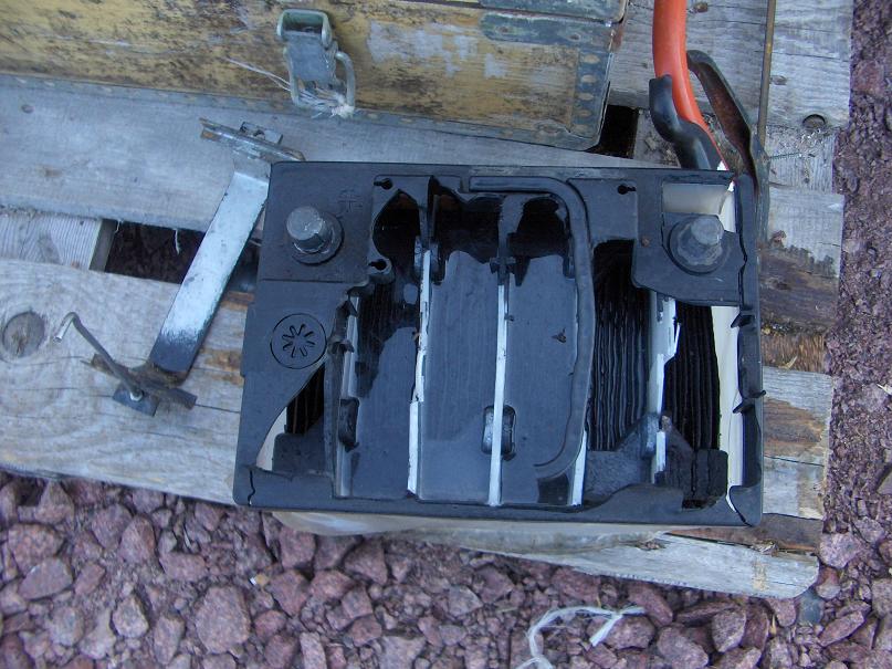

when car batts are on I like to tell you what happen to me 2 day ago, Wife came home stopped the car and went inside to get something and get out to the car like 2 mins later, the car is stone dead, run like a dream 3 minutes earlier....ok take my car and I will fix it for you, I told her. Opened the hood and start looking...well the earth cabels did not look too well so I replaced them with "new" ones and tested to start, nothing just a little tack tack tack from the starter. So I put a charger on it over night because I thought it would have charging problems of the earth-problem, next morning I disconnected the charger and jumped in to try to start...it sounded nice......then CABAAAM the battery exploded thank good I did not close the hood before cranking, hole top blew of, batteries are not so simple sometime :-)

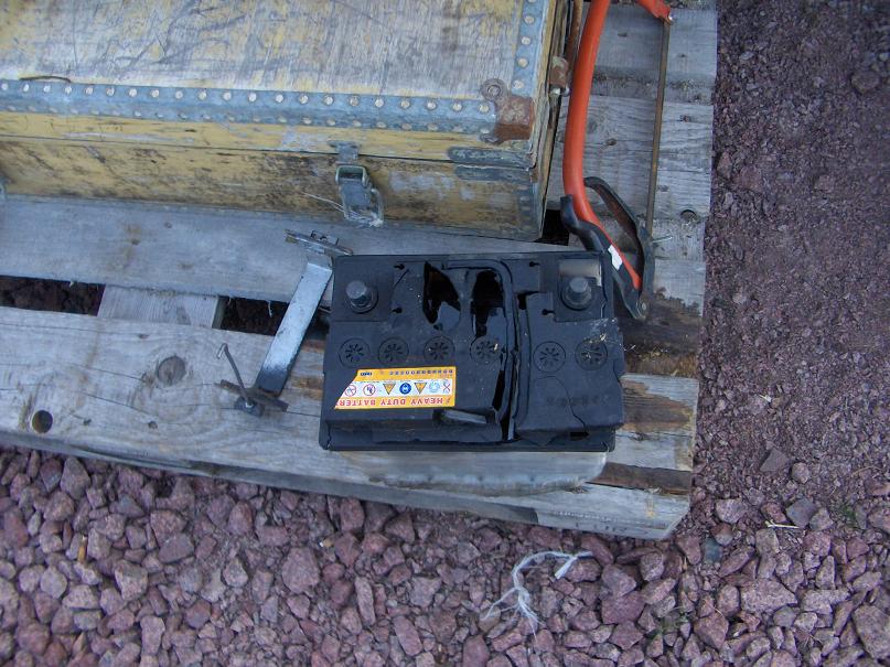

pictures for willib
and with the parts I found
enjoy :-)
canīt be done?? lets do it!!
Re: Forget the battery facts, try them! (3.00 / 0) (#10)
by willib on Sat May 19, 2007 at 08:28:40 AM MST
OMG !!
what do ya think caused that?
ok let me rephrase that , how did a spark get inside the battery?
scary...

Re: Forget the battery facts, try them! (3.00 / 0) (#12)
by snowcrow on Tue Jun 26, 2007 at 07:17:46 AM MST
Damm!!!, that battery look like it went Chernobyl!!!! It looks like some arcing took place between plates in a couple of low cells. Its been known to happen under sudden heavy loads and the right conditions!!
Re: Forget the battery facts, try them! (3.00 / 0) (#13)
by smidy on Mon Jul 02, 2007 at 10:16:59 AM MST
well the cells was not low before the BANG, the corners have cracks in them therfore the lack of fluid in the outer cells...

Re: Forget the battery facts, try them! (3.00 / 0) (#11)
by smidy on Sat May 19, 2007 at 09:30:34 AM MST
well I think the spark came from the led connection that have cracks in it, if you look carefully in the first picture you see cracks in the cell at the right side. I do not think there was any sparks around the battery since I had been cleaning and tighten all battery connections and replaced the earth-cabels with fresh ones, and with the hood wide open on a pretty windy day it should not been any gases around the engine...
