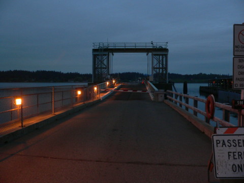

This is the ferry dock for Guemes Island in Anacortes Washington.  We got into Anacortes at about 3:30 AM and had to kill time before the ferry could take us across.
Normally Guemes Island has its own little dedicated ferry boat that will haul about 20 cars across.  This workshop was during the 'haul out' (maintenance on the boat) so they run a much smaller pedestrian only ferry during that time.  So basically we had to unload all our stuff (guitars, mandolins, parts for a few wind turbines, one complete wind turbine, blades, lumber for blades, resin -clothes - groceries etc...).  When the ferry got ready to go we frantically put all our stuff in wheel barrows and rushed it onto the boat.

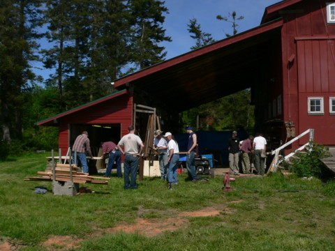

After classroom time we lowered the machine we'd built in 2003 and inspected it (it's grid tied on an 80' tower).  Then everyone came to the workshop and started getting organized.
Folks got right down to building molds - winding coils - laying out lumber for carving blades etc.

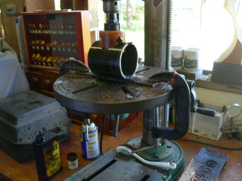

Using the drill press and a hole saw to fabricate parts for the 10' machine.  We didn't have good tools to hold the work to the table so we tack welded the pipe to some bar stock to make clamping possible with C clamps.

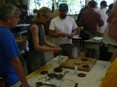

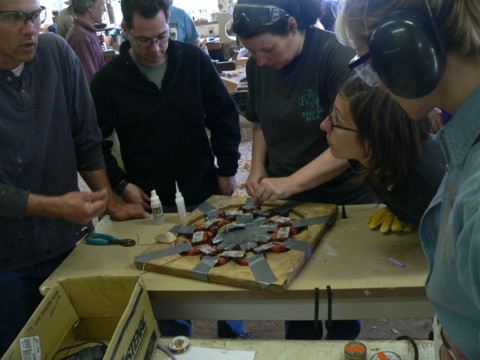

Rich did a great job of instructing folks on winding coils/making stators etc for the 10' machine.  I don't think I ever got a good picture of him, but also a big thanks to Brian from Magnum Energy who is always at these events helping with stators/magnet rotors and letting us pick his brain about electronics late into the nights.

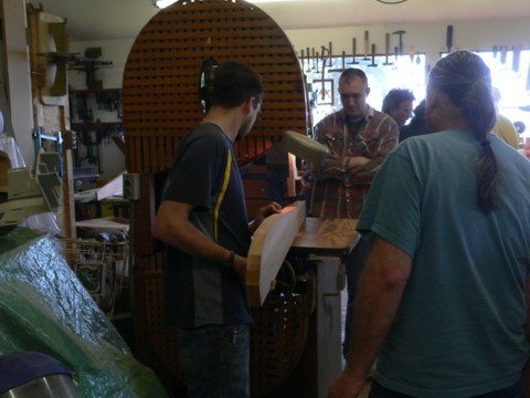

We had this huge antique band saw to use.  Pictured above Kirby (I think) is cutting the blades down to the correct thickness.

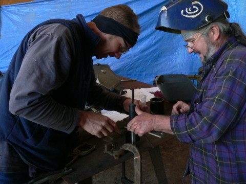

George and Andy gave lots of welding lessons.  Pictured above Shawn is learning some tips from George.

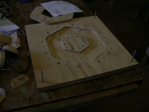

This is the stator mold for the 6' diameter machine.  It's an interesting design and something about the way the magnets are placed bothers me (they're sideways) but it did seem to work out quite well.  It's 6' diameter, the magnet rotors are 9" in diameter.  Only one rotor has magnets - 8 of the 1" x 2" x 1/2" blocks and they're sideways on there.  It's quite a simplified and inexpensive machine to build and it seemed to work quite well when we tested it.

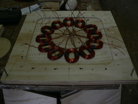

All the coils for the 12' machine ready to be wired up.  That's it for part 1.
